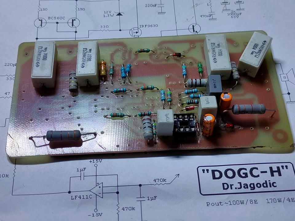

only thing that should be done with this amplifier is to match input mosfets to achieve good output offset. I have made both versions and they work just fine. also,this amplifier likes big heatsinks.
How is your experience with DOGC H amp .
There are so many diy amps with fantastic reviews that I am a confused which one to build though.
And how do you match the input mosfets.

Andrew,you must match input mosfets comparing its Ugs and Is,so it would be good to order at least ten of them. you may be lucky enough to get them from same line of production. without matching them I have had a few Volts on output,but i had those from various sources,and even manufacturers of I can recall good enough, it's been about ten years now ... otherwise,it works fine and doesn't need any further adjustments. and yes,those input mosfets will need a common heatsink because they get quite hot. also,you must be very carefully with static electricity, because it can burn them . my works for all those ten years without any problems.
many of OME amplifiers were prototypes,but Dogc Dogc-H and Studio were the one that worked just fine. I have both of those, on working condition.
preamps were his ground places, Standard, Allegro,HF2000... if you build anyone of others you might have except some troubles. DOGC-H and DOGC-MK2 have no troubles, Studio and Studio-SE also work just fine if you build it as shown.
for usual casual home listening 300VA is ok for stereo,but if you want anything bit more serious - use dual mono PSU with 4 x 10 000uF and 300VA transformers. that would be ultimate option for this amplifier,with common sense. it is Dogc-H that I am writing about...
I have tried it,but it oscillated. many of amplifiers from his latest site were prototypes. Studio,Studio SE,Dogc mk2 and Dogc-H,Standard,Sigma were many times done and they all worked just fine. CroSer and Lambda were done as I know each for one example and they worked nicely but to achieve that there should be some matching output transistors,wich is not simple or inexpensive...
