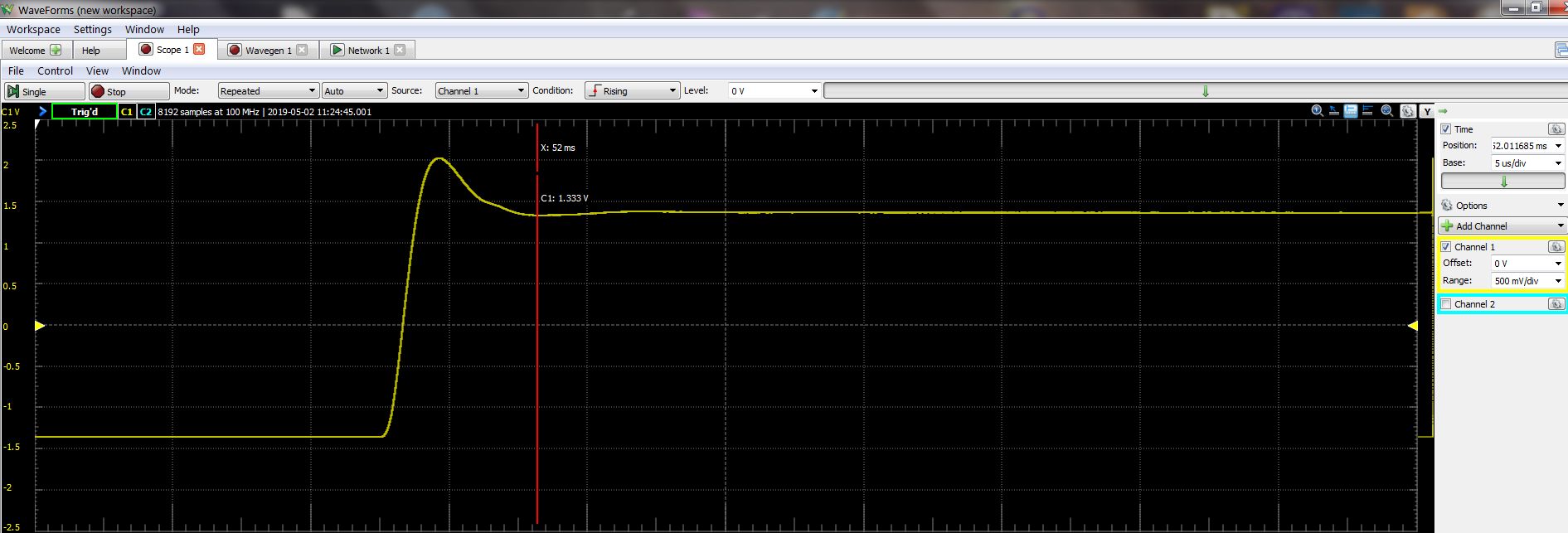

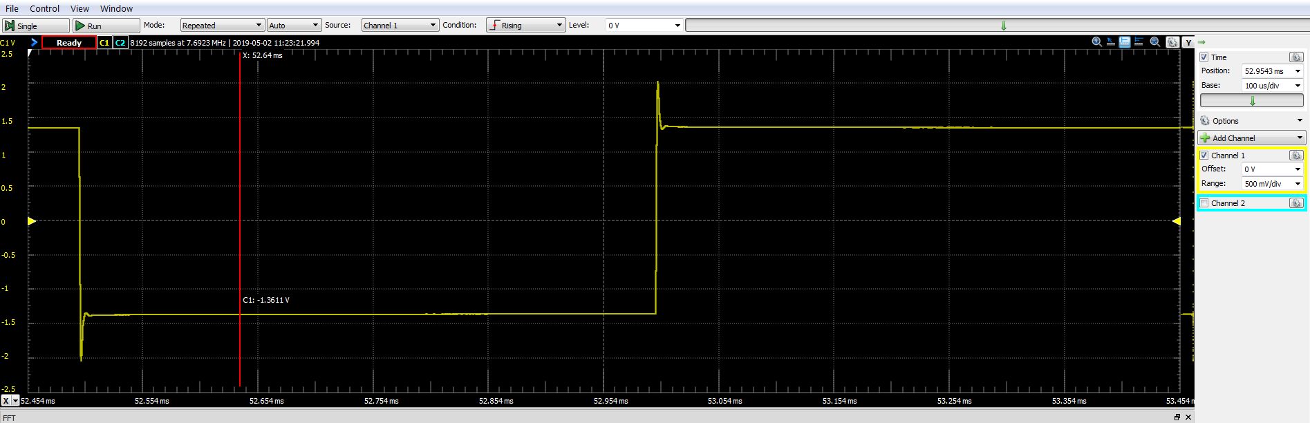

Input mosfet oscillation
I have scoped my two DOGC-H amplifiers and one board has oscillation starting above 5V of output. I discovered that removing 220pF capacitor across gate and drain on input mosfet eliminates the problem. Other boards have no oscillation with 220pF installed.
What could be the problem? Every board is the same - same layout, same components.
Thanks.
I have found source of oscillation - it was protectione 12v zener. I had to solder it directly to the mosfet pins. Interesting is that other channel does not have this problem and PCBs are identical.
Anyway I have scoped the amplifier with square wave and there is quite a bit of overshoot. What is causing this? How can I tame it?

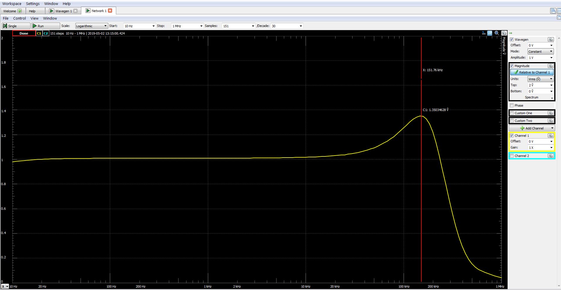

Frequency response
Here is frequency response of the amplifier. All four PCBs test the same. There is clearly frequency peak at about 150 kHz. How to get rid of it?
Or is it OK, because music has no signals above 20 kHz?
