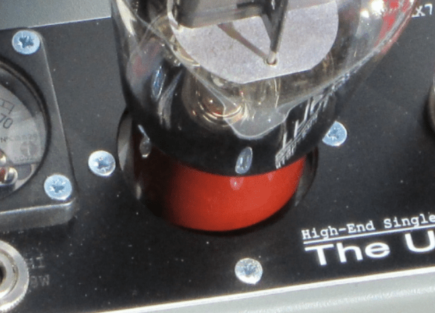

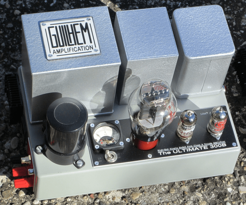

On my U-300B below :
You can see that there's a chimney provided around the socket of the 300B :
But finally, I drilled no hole nor installed any fan cooling under the chassis, so it's just a vent without chimney effect, so in fact no air circulation !

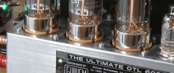

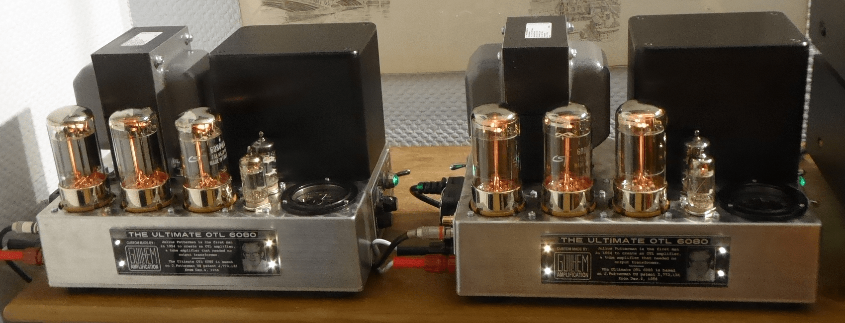

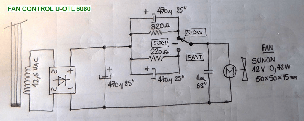

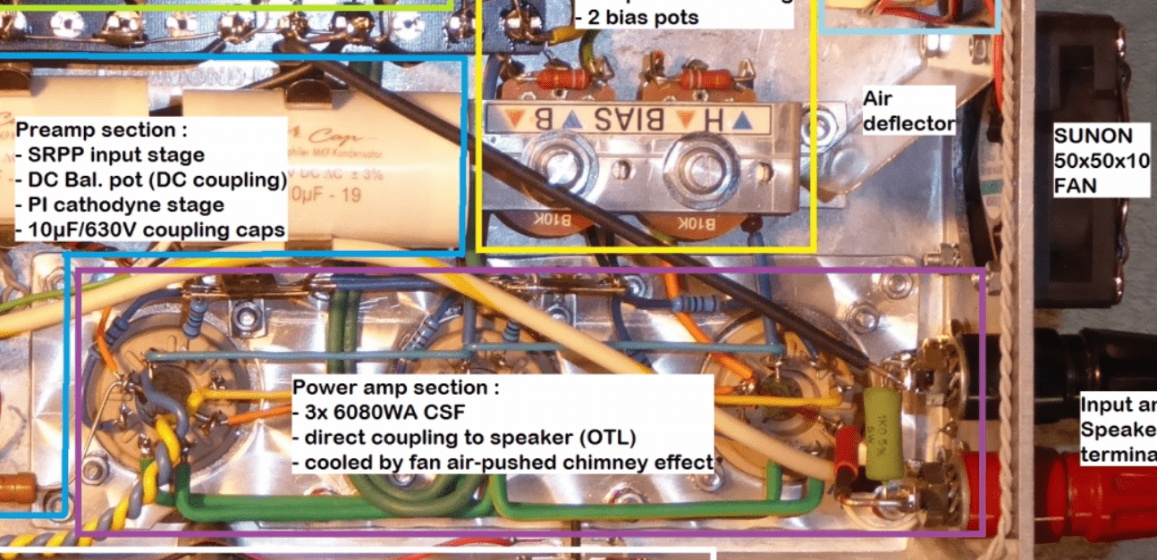

Conversely, on my U-OTL, where 3x 6080 operates in Class AB1, there's a chimney and fan cooling system :
You can see the chimneys around the 6080 sockets :

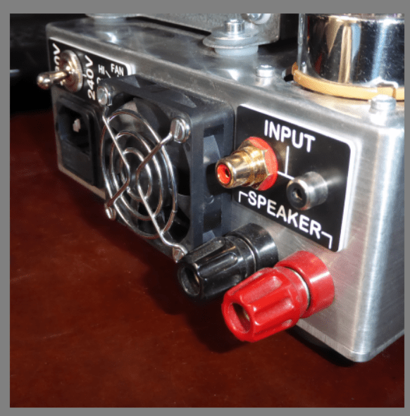

And the little fan at the back of the amp, with 3-speed settings : Hi/Mid/Low, the Mid speed being already enough and is inaudible :

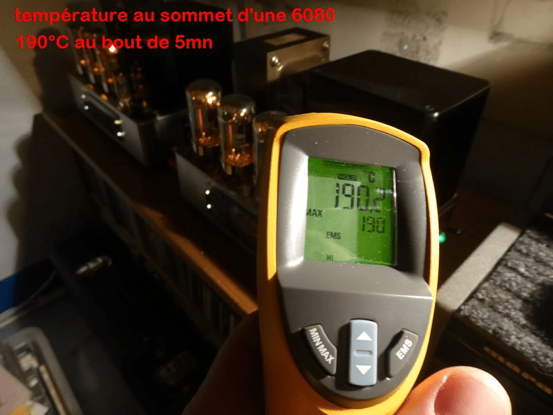

I measured the temperature of a 6080 top bulb, cooling off, after 5 miniutes of operation : 190°C, that's much more than for a 300B...
So yes, in this case, a chimney plus light fan cooling is indeed welcome ! At LO speed, the chassis at the base of the tube stays lukewarm, and at Mid speed, it remains cold.

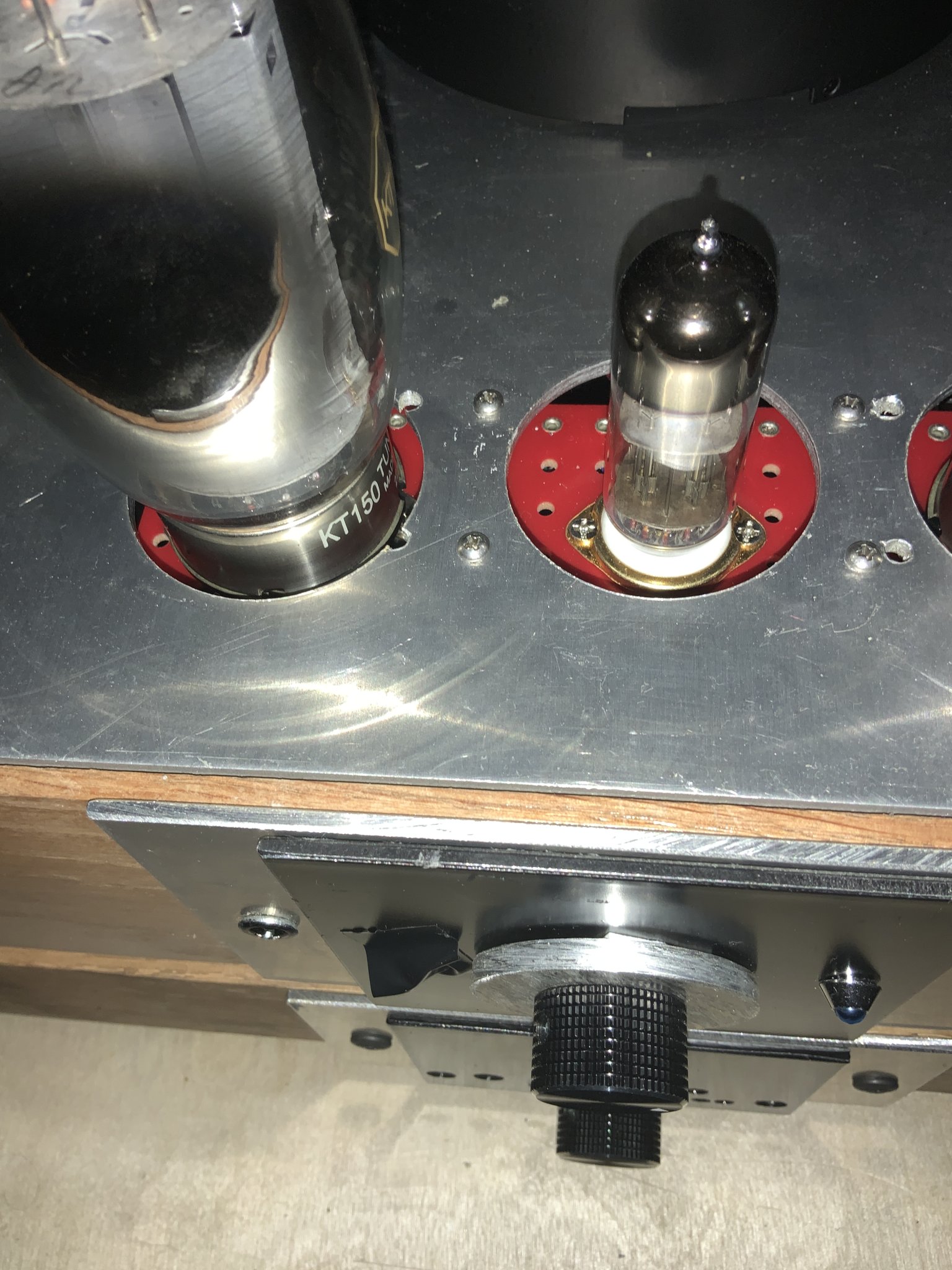

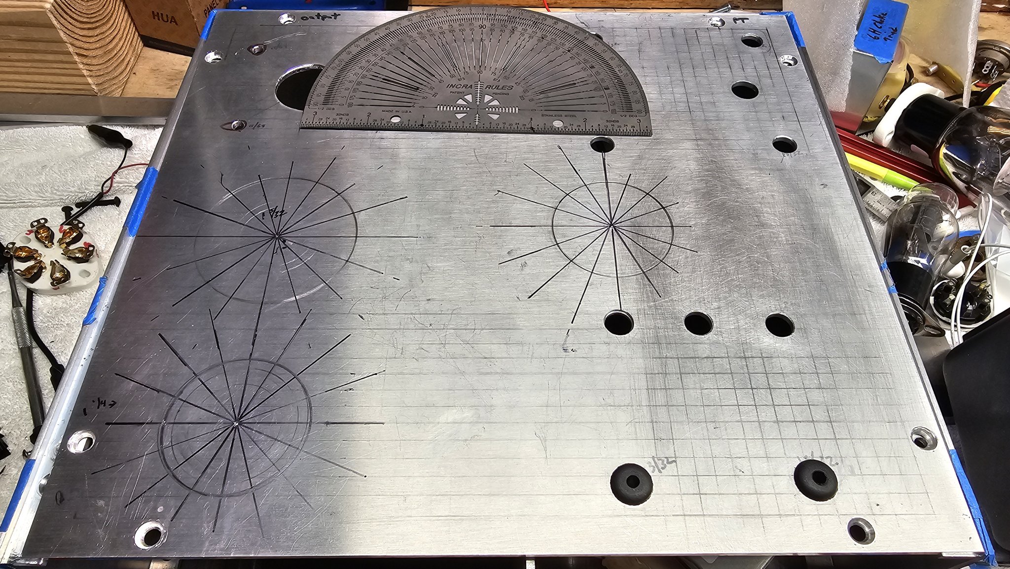

I'm preparing to waste some time, electricity as well as some aluminum tomorrow drilling some holes. Mostly for thermally enhanced ventilation as well as a bit of decorative effect. Got two of these to do. 300B towards tge back, #41 up front and 5R4 to the right.
Man, that layout is what I lack in experience. That photo is revealing in how something should be approached. Damned human eye picks up too much in cases such as this and yet ignores stuff like motorcycles and pedestrians.
