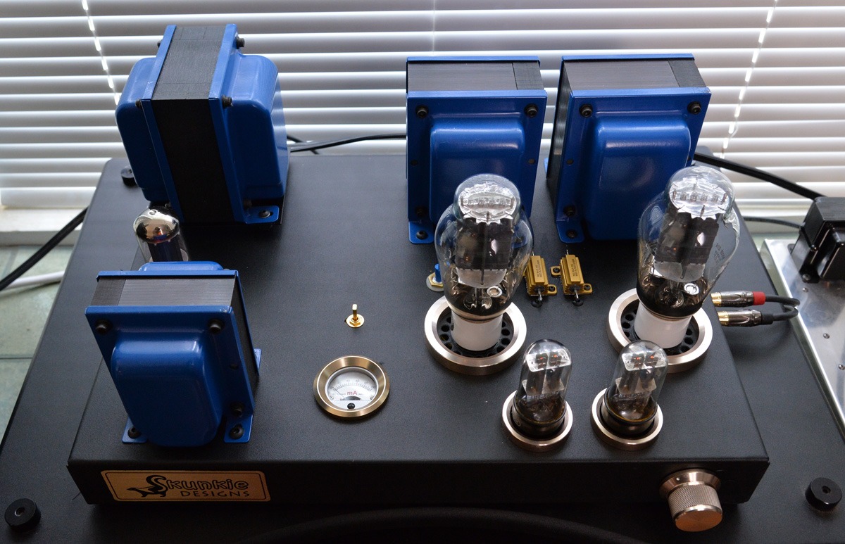

@jean-paul what exactly is the imperfection? Having an amp with a closed case in which the parts can easily stand whatever temp is in the case? 27W idle is not at all unusual for a 300B in SE class A (and "only" 75% of the rated max).

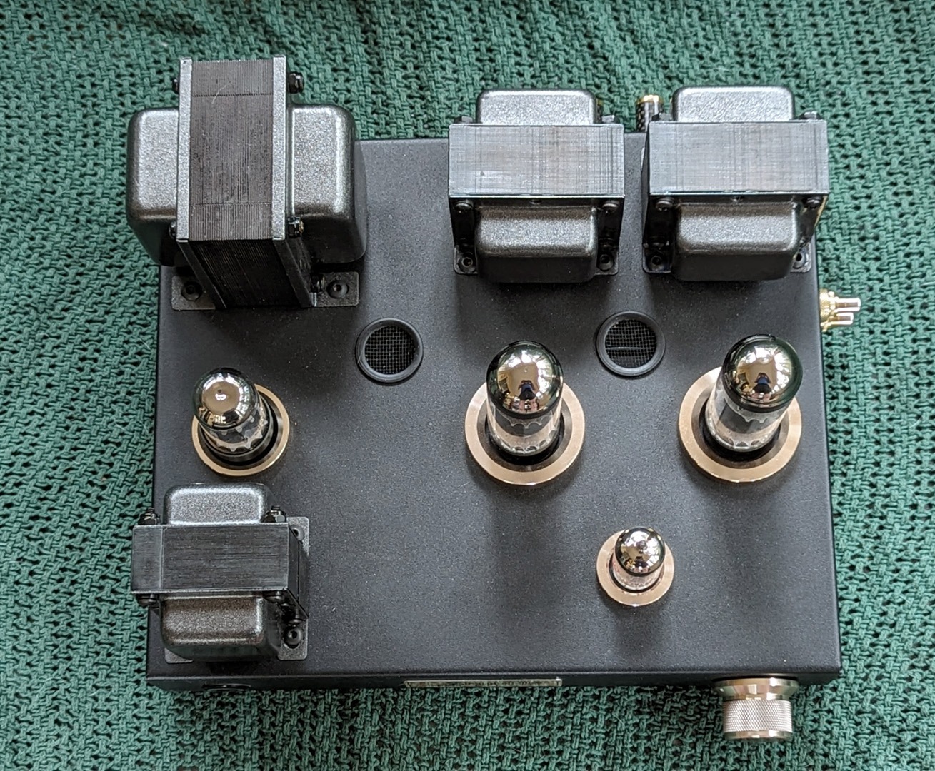

IMHO, the usual ring of holes probably doesn't provide much additional airflow around the tube. It would be interesting to see a flow map of how the air moves from the deck and up over the tube. I can imagine the possibility where the holes actually make it worse! Multiple tubes with holes probably ventilates the inside better, but as said, that's not the discussion.
Any cooling effect of the holes is likely to be microscopic, especially if the chassis is completely enclosed with a bottom cover and has no vent holes anywhere. It certainly won't hurt anything, though, and the holes may add an aesthetic touch to the amplifier.Hi,
when looking at 300B builds, some use holes around the socket of the tube and some do not.
The argument made is that these holes will produce air flow around the tube in some "chimney effect". I am sceptical that this has any significant effect, especially if the case is closed at the bottom, but even if not.
Are there any real measurements available that prove the chimney assumption?
Also, the tube has a heater / filament to, well, heat it. So, given a design with some room around it and a grill/mesh above / around it at max, is it even desired to cool it?
No, that is not the case. Actually if you look at the EL34 amp, there are two vent screens in the top of the amp specifically over heat producing internal parts (cathode resistor on one end and power supply dropping resistor for the other), along with vent holes specifically placed on the bottom cover to provide this same convection cooling. These perform the same function. On my 300B and KT120 builds I used holes around the tubes instead for the same purpose. On the KT120, the vents in the bottom are at the back to ensure air flows through the entire case. Note on the 300B amp the cathode resistors are mounted to the top of the chassis to keep that heat away from other passive parts that will degrade over time if exposed to heat.Thanks Stephe, yes, I am familiar with hot air flowing upwards. I see you do not have cooling holes around the EL34 in your builds.
