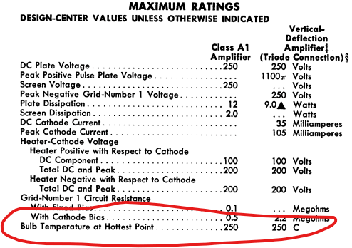

The original poster stated his question related to the tube and not the parts inside the chassis. In which case if there was a problem with the temperature of a tube then there would be a mention in the tube data sheet. For some small output tubes (like 6AQ5) there is a mention, but it is to prevent extreme situations from occurring since 250C is the maximum.
I would suggest that a significant part of the bulb temperature limitation is the glass-to-metal seals, as is true for larger transmitter class valves. As trobbins pointed out in post #57 large amounts of internal heat try to escape through the nice high thermal conductivity metal pins, rather than the poor thermal conductivity vacuum and glass.
This would imply that keeping the seals as cool as possible might be as important, or perhaps even more important, than cooling the glass envelope, except near the seals.

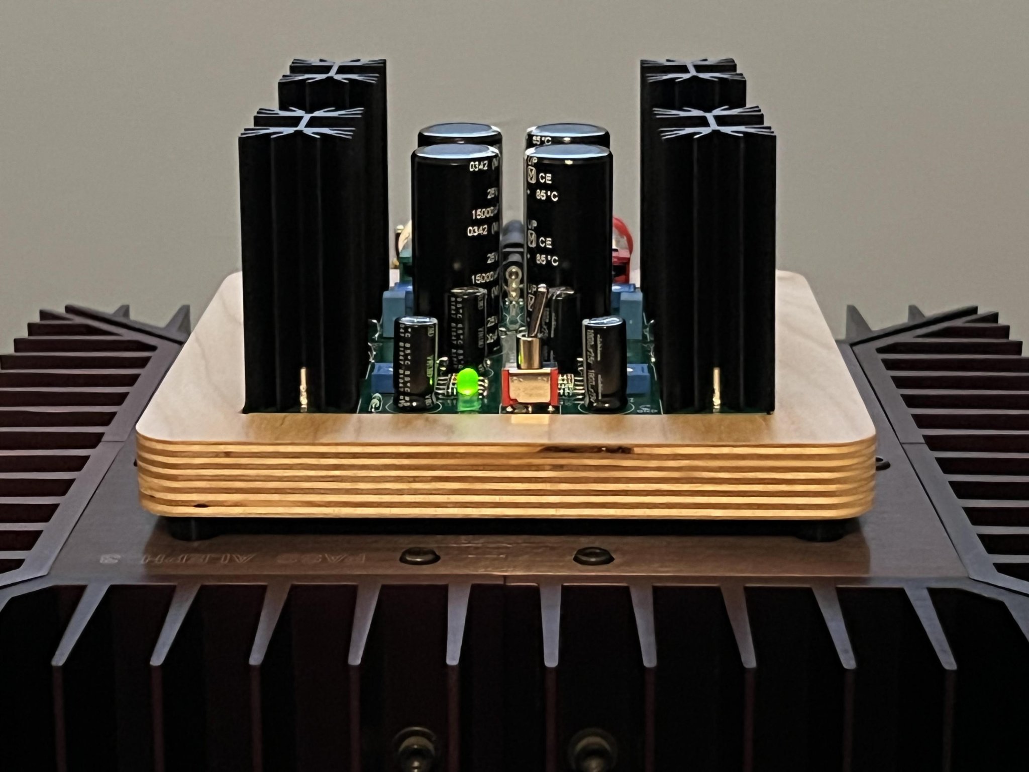

Sure, and for a guitar amp that's probably the cheapest and most effective solution. But if you want to keep your high-end pre-amp as clean as possible, aka no noise, purists will argue that fans, even undervolted slow turning fans, are simply not an option. And then you have to get the max cooling out of convection, which is where the holes come in.Tj with higth bias a low fan help a lot ,I put one in my tube guitar amp an ones for summer on Pass amp
Modern day computer cases use very thin and very fine mazed dust filters, often with a magnetic frame, so nothing prevents you from buying one or more of those and cover the case openings to prevent a huge part of the dust being able to enter the case.Same. Anything with a fan always gets full of dust, but passive enclosures seem fine. Or maybe the dust all gets stuck to the high-voltage conductors only 🤣
No need , work fine ,pre -power amp, phono on wood as diy , never have problem from simple dust ,computer too just clean cpu fan one time at year , on Pass we move open baffleSure, and for a guitar amp that's probably the cheapest and most effective solution. But if you want to keep your high-end pre-amp as clean as possible, aka no noise, purists will argue that fans, even undervolted slow turning fans, are simply not an option. And then you have to get the max cooling out of convection, which is where the holes come in.
Acamini 6w classA with 12cm silent fan as babysitter on top is perfect in summer🙂 ,
