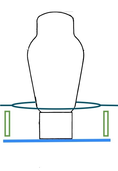

Do "cooling holes" around a tube really make sense?

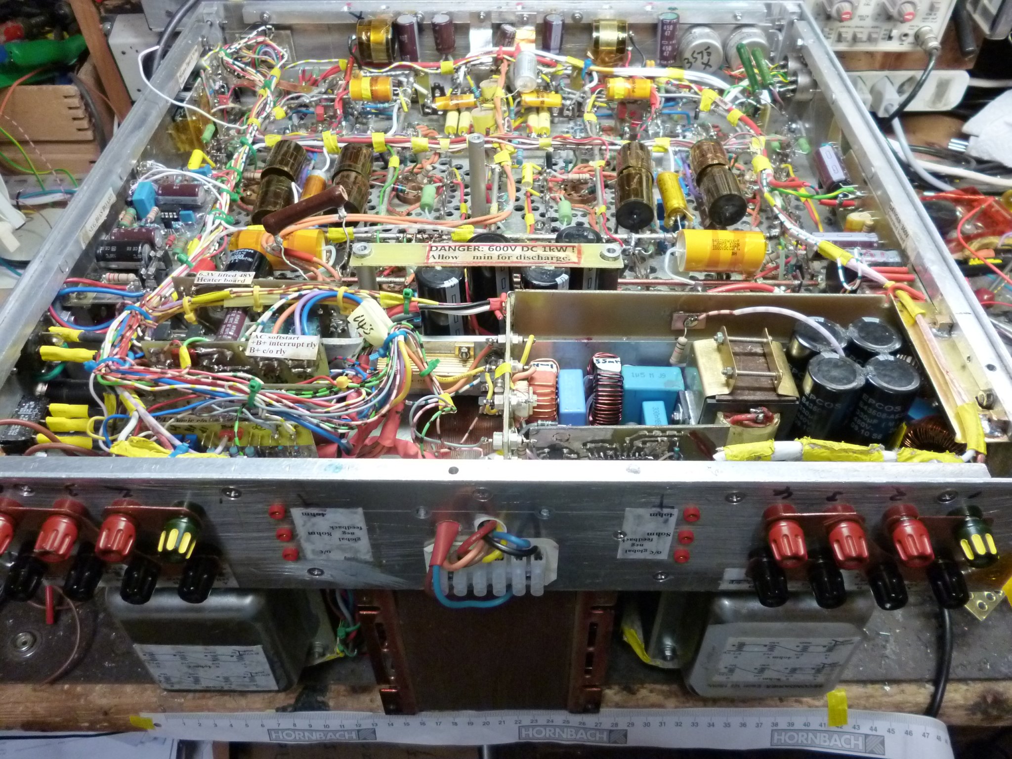

Don´t forget with a closed chassis that inside for every 10°C temp rise over ambient temp, electroytic cap life halves, even though over the decades vast material improvements have been made. I still apply the old rule to mount where possible such caps in the lowest part of a ventilated chassis where it is cooler. The top chassis plate with multiple tube mounts can get astonishingly hot with power tube anodes on the verge of glowing in class A. If caps have to mounted on top, a heat reflecting plate fitted. Constructors cosmetics.
In the accompanying pic of this high power amp relevant ; take note of the electrolytic cap positions away from potential heat sources relevant to any such design. The perforated aluminum top chassis common to my designs implies evenings patience with a pillar drill. The under cover (not shown) also similar.

What I've done with top mounted tubes is mount the socket on its own small board and hang it from the top plate with standoffs or if they're microphonic tubes, with silicone mounts that come with some case fans.
By dialing in the best distance below the top plate relative to the size of the top plate's through-hole you can net a sort of venturi effect.
I've done this a number of times, the hole size determined beforehand (of course) and then once built, running the amp perched between a couple of blocks at either end til warmed up, smoke fed in underneath , changing the length of standoffs for best effect. Worked for me. Like Anatech says try and measure. It's straightforward and doesn't take long.

I asked if these holes are useful. So far, the result seems to be "only for the parts" in the case. I was more after if it is better for the tube, but seem not to have made that explicit enough in my OP.
