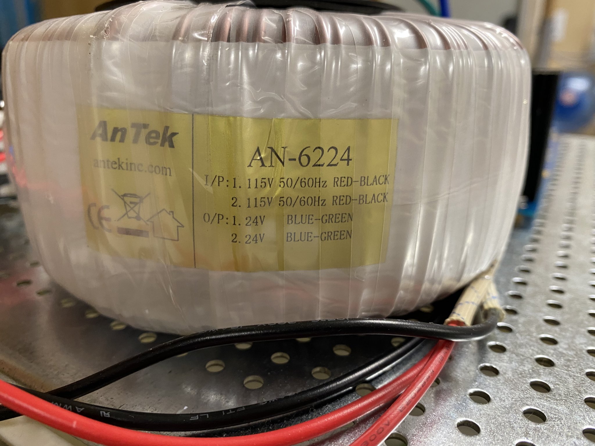

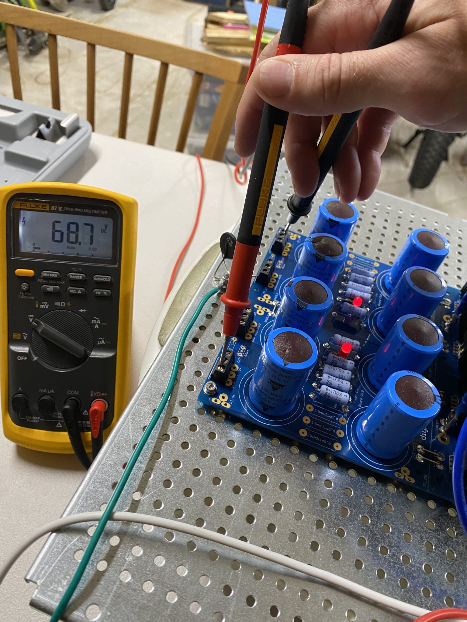

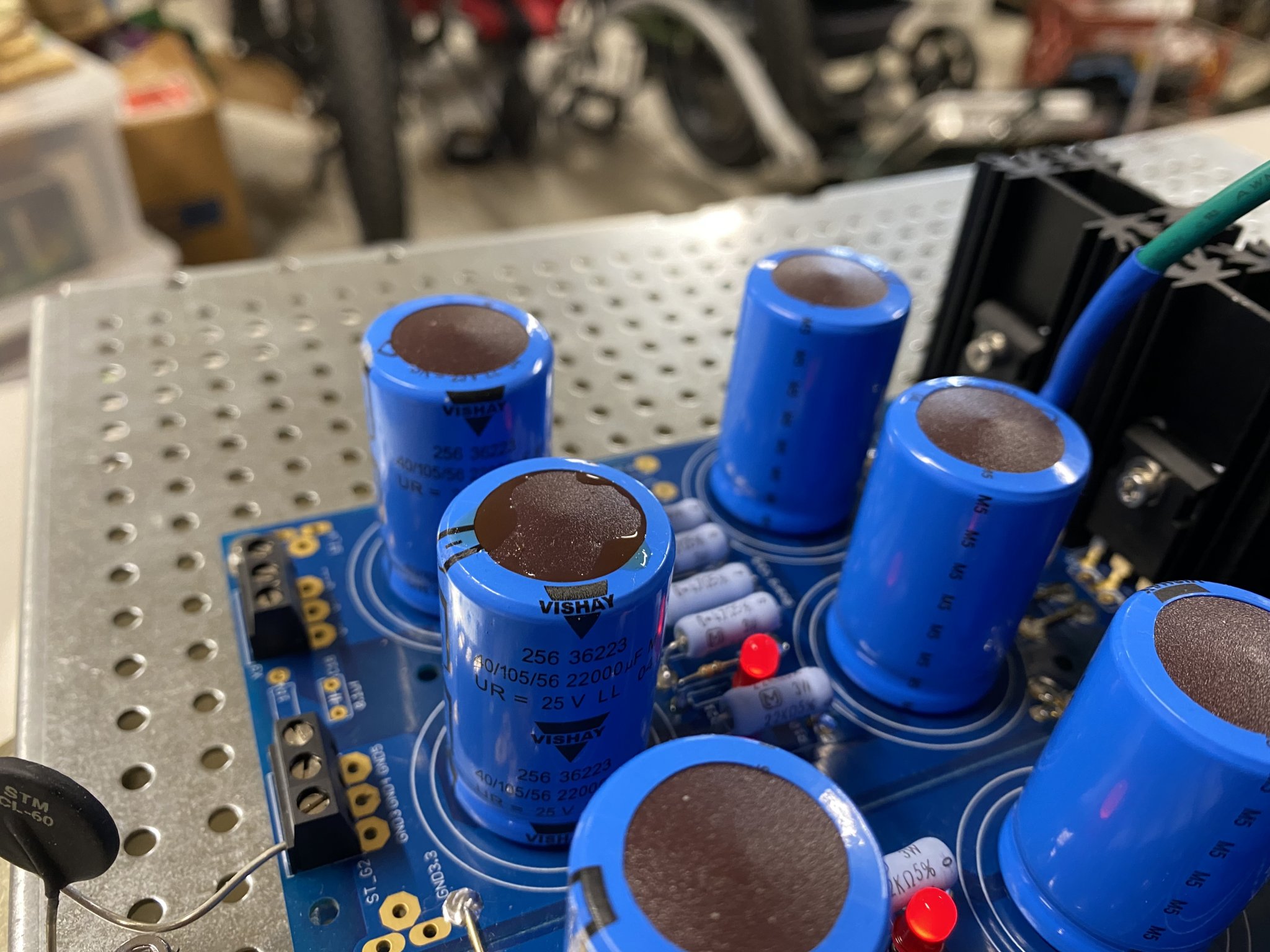

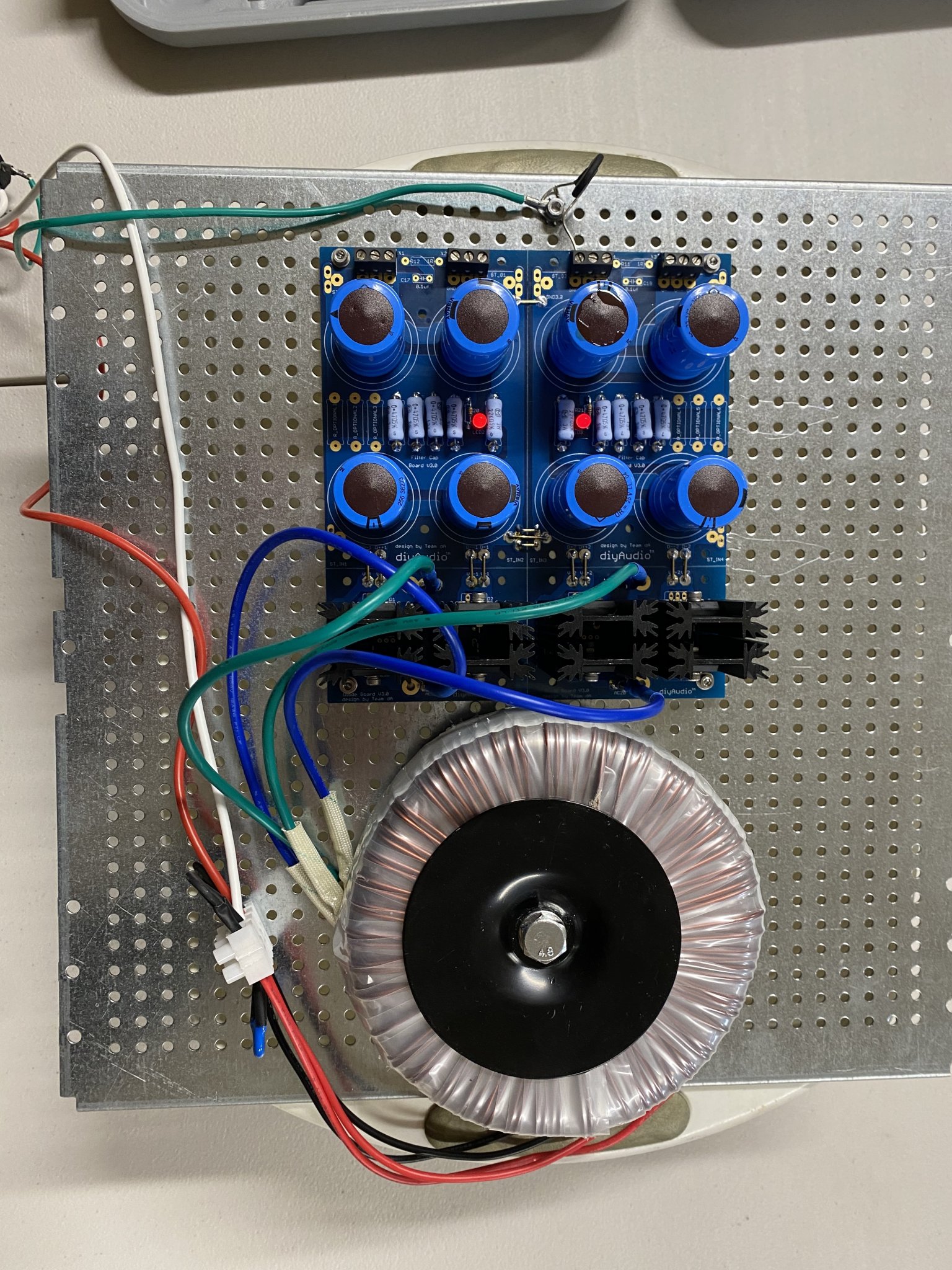

I'm in the process of building a pair of F5T v3 monos and built the power supplies using PSU from the diyaudiostore. I've had one of the PSUs assembled and running for about a week and upon inspecting it today, noticed the capacitors were bulging/leaking. I assume there's a mismatch between the capacitors and transformer, but I'm not certain. Any ideas what would cause this to happen?
1. Transformer - AN-6224 (1x)
2. Capacitors - 25V/22,000uF (8x)
Thanks in advance!

You are over-voltaging your caps. Rating on the caps is 25VDC. Using a 24VAC secondary after rectification will be about 34VDC. That looks to be what are measuring with a total potential difference of 68VDC from V+ to V-. (34 Volts per rail).
Those caps need to be replaced with higher voltage rating or go down to a x-former w/ 18V secondaries. Given this is the F5T, I'm guessing you want to keep the 34VDC rails so higher rated caps.
In the meantime, I recommend powering it down and not turning it on until the caps are replaced.

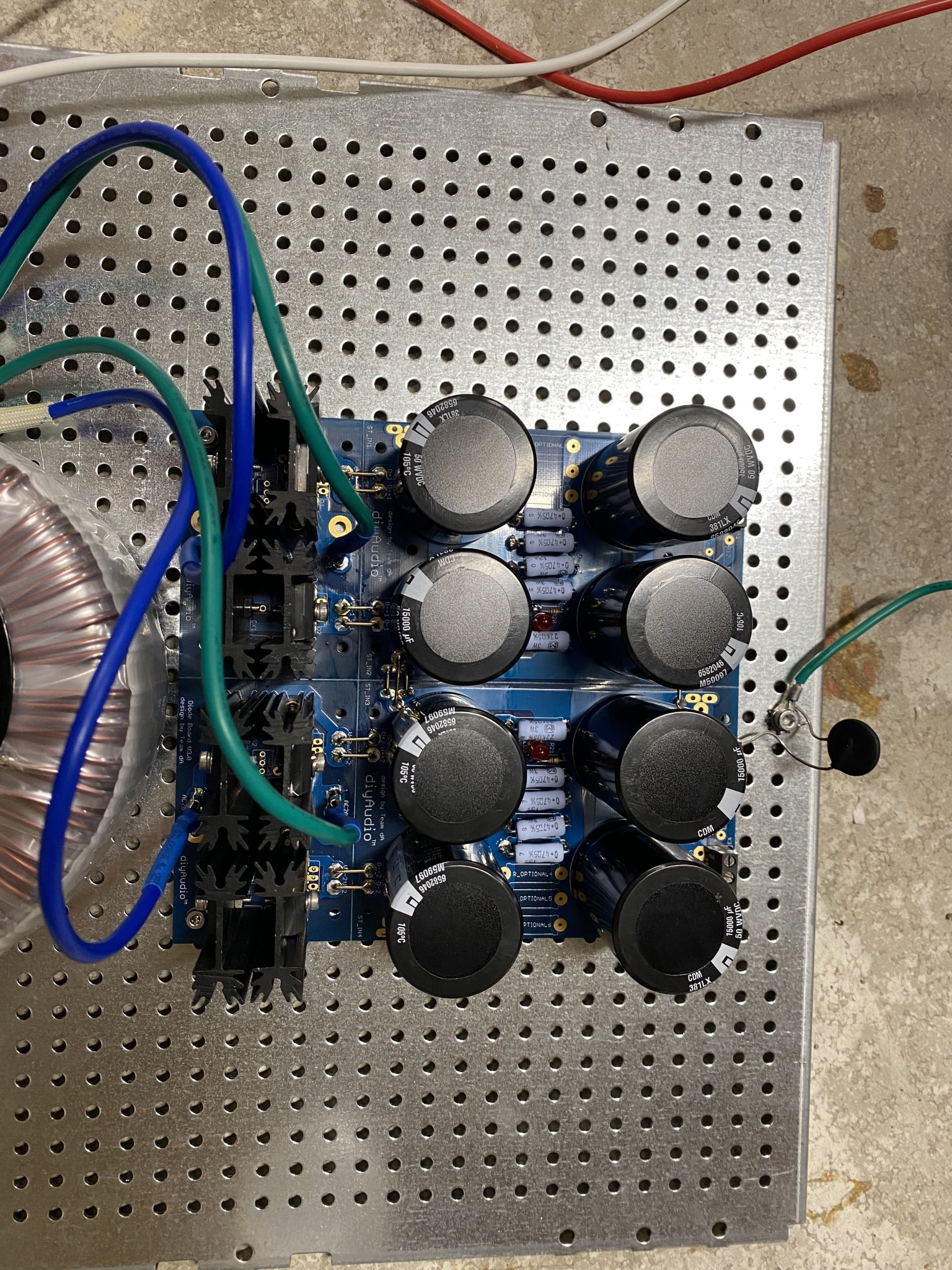

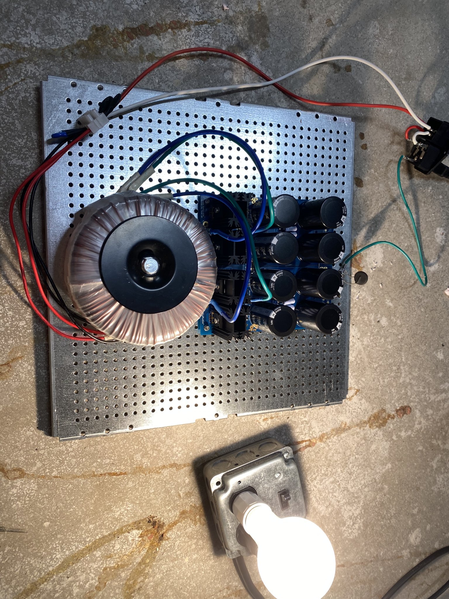

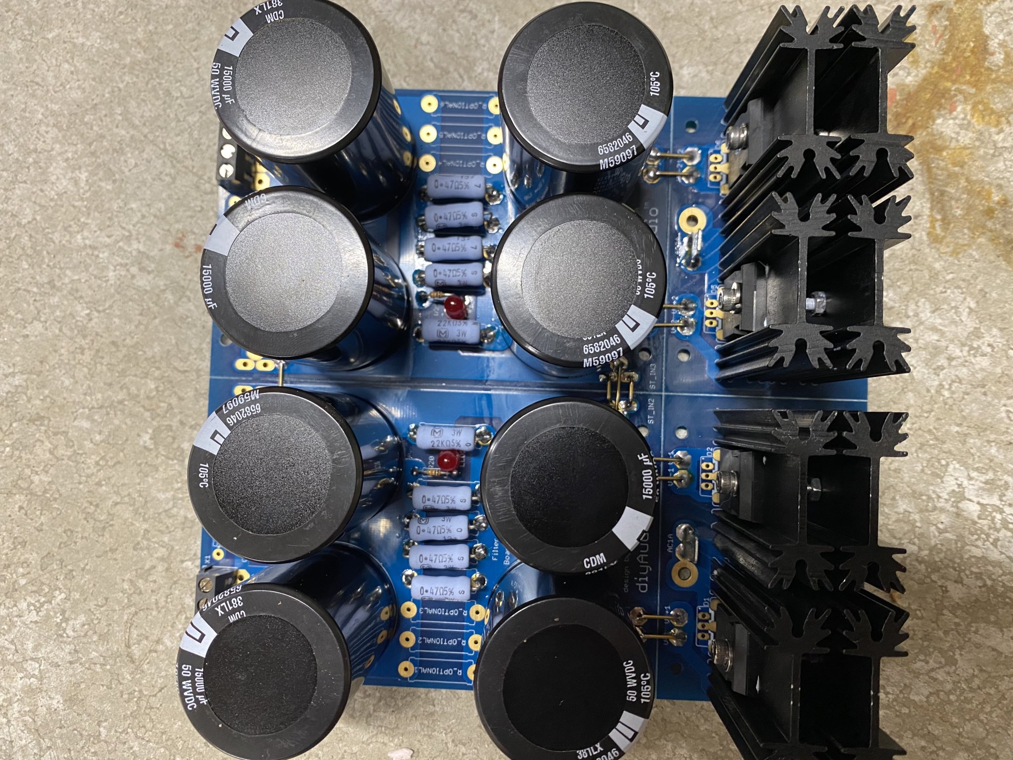

explicative Just got my 50v/15,000uF caps today and put them in my psu. After consecutive 5A blown fuses after startup, I added the dim bulb tester to see if there was a short - it lit up like a christmas tree. Any idea what I've done wrong? All else has remained the same from my previous post (#1,842).
600va PSU
8x 50v/15,000uF capacitor
5A fuse
600va PSU
5A fuse

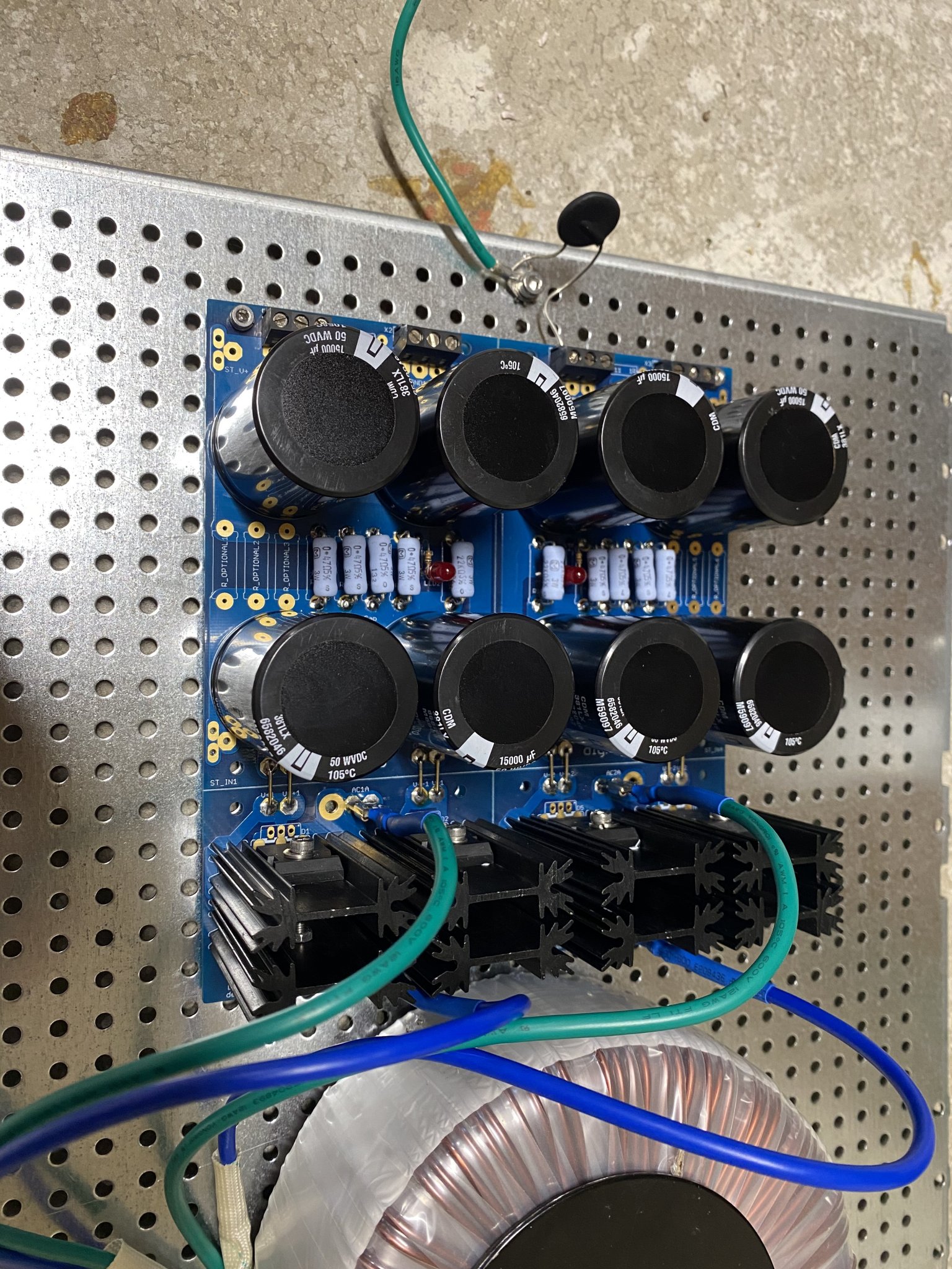

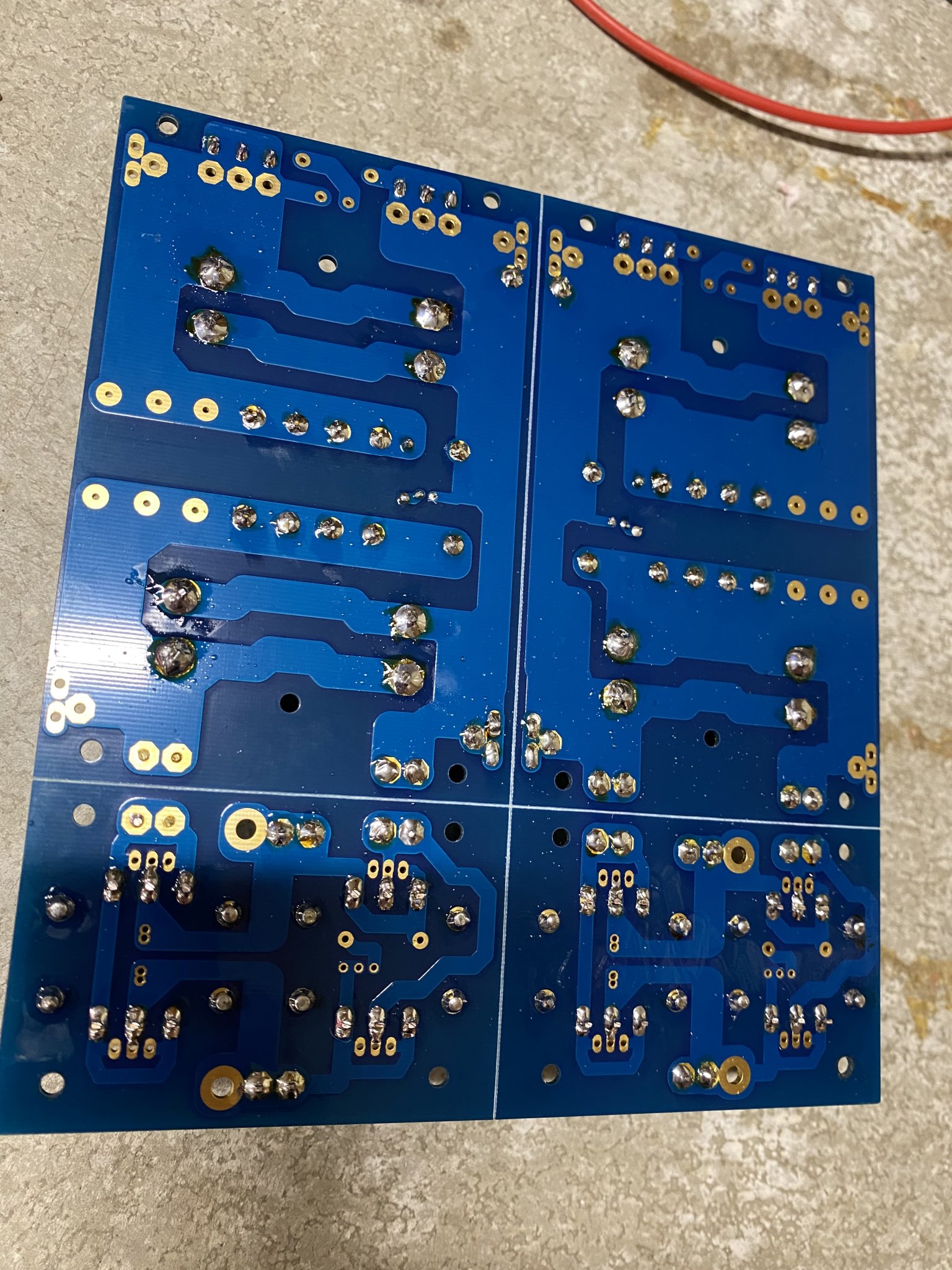

No soft start board yet...just the CL60's in series. Here are a few more close up pics of the solder pads. I did notice one of the new capacitor leads was touching the metal baseplate during the initial startup, but I've since trimmed everything.
.....I did notice one of the new capacitor leads was touching the metal baseplate during the initial startup, but I've since trimmed everything.
That could do it - a short to ground.
