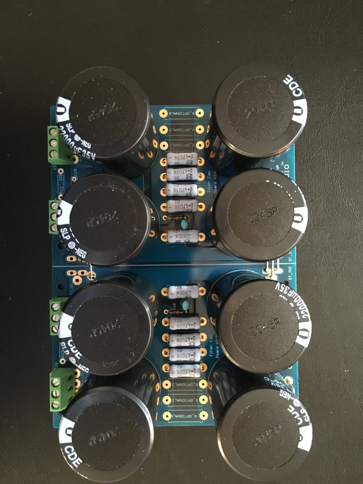

Ok, I’ve searched everywhere and cant find Any discussion of this question. When attaching the transformer secondary wires to diode bridges, should the ac phase be reversed for the negative side of power supply? As I study Nelson’s power supply schematic for f5t, for example, it looks like positive side ac is hooked up to A and N, and that on negative side the secondary ac phase is reversed N and A. Does this matter? Looking at 6L6‘s various build guides, he keeps the ac secondary phases the same (for example, the Antek blue and green secondary wires attach to both bridge rectifiers on same ac terminals for positive and negative leg). Does it matter? Thanks
Are there any simple multimeter tests that can be done before adding power? The adding power for the first time is a little scary. I do have a dim bulb tester ready to go, so I’m covered there.
Set your multimeter to measure resistance, no power to power supply, black probe to Ground, red probe to V+, there should be resistance measured.
Black probe to V-, red probe to Ground, there should be resistance measured.
I still don’t have r9 and r10 in yet. Will that matter?
For the first test, I get .568 for every GND spot on the board. Second test is .563.

@Mulburg - I know you didn't ask, but you don't need a high wattage bulb to test an unloaded supply. Just a tip. 5 or 10W bulb is fine (and gives you more safety margin for your first check).
No, you don't need R9 or R10 in place for testing. They bleed the caps. It's going to take awhile for them to bleed without a load and without bleeders. So, just be aware, and either install them or manually bleed the caps as needed.

R9 and R10 are bleed resistors so that if there is no load (ie amplifier board) connected when you power off, the resistor will discharge the capacitors. However if the LED and its resistor are installed, they will bleed off the capacitors.
As for the resistance reading, what are the units of 0.568? Ohm? kOhm? Always include unit of measurement when reporting. When you have the red probe on V+ and the black probe on Ground, the measured resistance should rise as the multimeter charges the capacitors. The resistance should be much higher than 1 Ohm.

Gotcha. So, you did the two measurements and got 568,000 ohms and 563,000 ohms? 0.568Mohms & 0.563Mohms. Similar to what Ben said, and I had asked earlier re: the confusion with your current limiting resistor for your LED... be sure you always provide units and prefixes as appropriate. Quite a difference between <1 ohm and a few 100 kilo-ohms 😀
If it is MOhm, then that is good. There are no shorts.
Looking at the picture, the capacitors and resistors appear to be in their correct places. I see that the bleed resistors are in place too.
Looking at the soldering, it appears to me that the copper pads at the capacitors are not fully filled with solder, and the solder joints appear rough. However I am not totally sure because it is hard to tell from the picture. A good solder joint should be smooth and shiny.

I see A LOT of pads with not enough solder and what look to be cold joints. It's a wild guess, but I'm going with either too small a tip, an old worn tip, or not nearly enough oooomph in the iron.

I have my multimeter set to auto, it defaults to mega ohms. It seems to work when I switch back and forth from a resistor, r9 for example. If I hold the probes in place, for the above tests, the values do steadily decrease.What do you mean by "M for the tests"?
There are a couple capacitors that I agree with you on the soldering. I’m going back over them as we speak. It’s a good iron just a sketchy operator.
