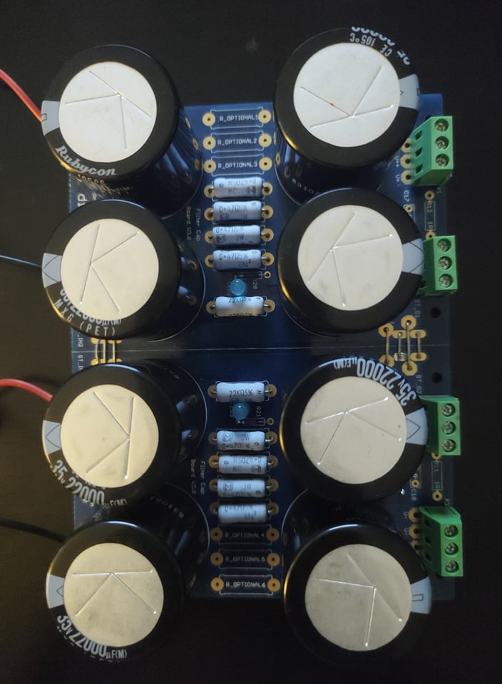

Hi all
Hope this is the right place to post.
I am having trouble with my F5 that has died since being at a friends. It uses the V3 PSU.
I have had it running for a bit over 18 months and all was good. Now it had come back dead. No LEDs on the PSU and no voltage at PSU filter board outputs V+ V- GND.
I have voltage at the transformer and the DC outputs of bridge rectifier when filter board not connected. When connected no voltage at D+1 D-1 D+2 D-2
I have pulled the filter board out of the chassis to test but I am only a dumb sparky and with caps etc in circuit the ohm readings are a little funny. Can see some resistances rise obv going through the caps.
Everything looks ok on the filter board but I still can't get it to power on even with amp boards disconnected.
I guess something has gone wrong with the amp boards but just starting at the beginning and im up to the filter board.
Any help greatly appreciated.

Thank youBen Mah, on the previous page, recommended a test for me when I had just finished my board. Maybe that would help rule out a short on the board?
I found his post
Set your multimeter to measure resistance, no power to power supply, black probe to Ground, red probe to V+, there should be resistance measured.
Black probe to V-, red probe to Ground, there should be resistance measured.
Yeah both have rising resistance which is what I saw before.
the rising resistance should be your caps charging.
As Ben pointed out, could be a solder joint or trace gone bad. Occum's razor points to a solder joint of the two. Pictures of the underside would help. The ones on top look bone dry but I know some folks don't flow the solder all the way thru and on both sides.
