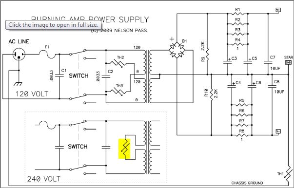

I am going to build an M2X amplifier, I am putting together a bom for the PSU.
I found these capacitors recommended in the thread:
SLP223M035H9P3 Cornell Dubilier - CDE | Mouser Belgique
SLP223M035H9P3Mfr.:Cornell Dubilier Aluminium Electrolytic Capacitors - Snap In 22000uF 35V 20% 105C
I will use a 300VA transformer 2 x 18V, 8 x 22000uF 35V capacitors, I will omit the input snubber and the optional PI resistors. I suppose this is a good plan?
As for the protection (see picture), will be building 230V version:
-I will fuse the mains (1.25A slow blow)
-I will fuse between the psu and amplifier modules, what fuse should I use here?
-thermistor between primaries of transformer, what thermistor to use?
-thermistor from chassis to mains ground, what thermistor to use?
-I also see 2 capacitors on the schematic, why are they there (and why also before the switch?), what type and values should I use?
-any more protections needed?
Anyway, I look forward to your advice. Regards, pieter

You can ignore my last post, I already figured it out what components to use.
CL60 thermistors, X1 capacitor 3.3uF (found as safety capacitor in mouser).
It seems to be a much asked question, maybe include it in the build guide so people dont keep asking the question over again.

Before you order your CL-60 thermistors, you may want to check out this thread by Mark Johnson:
Not thrilled with CL-60 inrush limiter in USA/160W Class A First Watt designs
