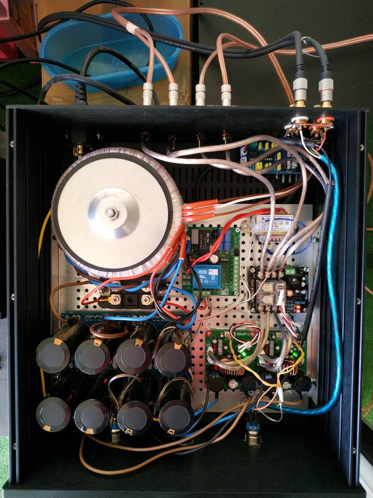

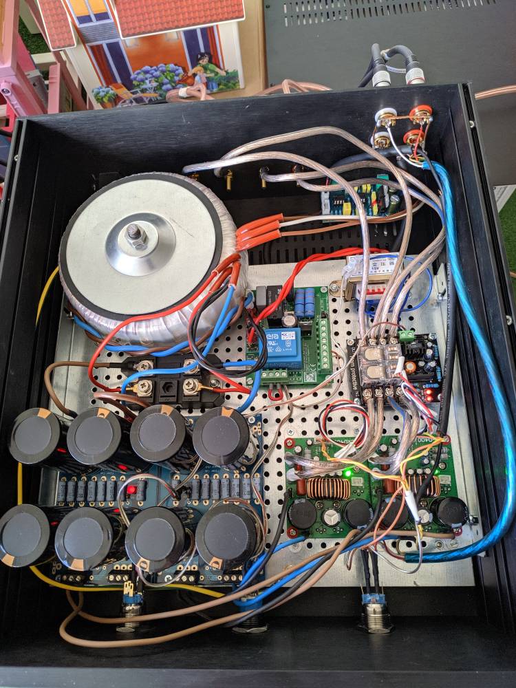

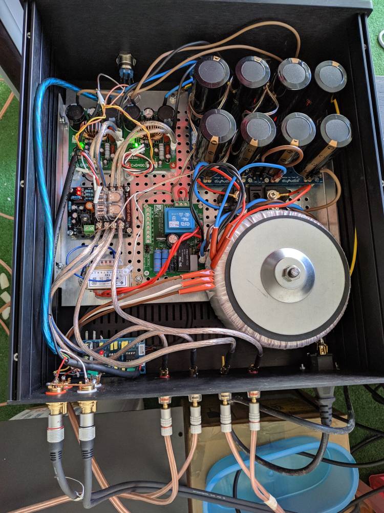

Hi, after weeks of time spent in waiting for parts and building, this is my implementation of this PSU board. It's without the rectifier part, to which I preferred a monolithic one.
Now, all I wish to know is your opinion about any possible concern or doubt about safety and if there are some adviceable or mandatory changes I can do.
Thanks in advance,
Gaetano. IMG_20190702_080226.jpg IMG_20190702_075104.jpg IMG_20190702_075029.jpg

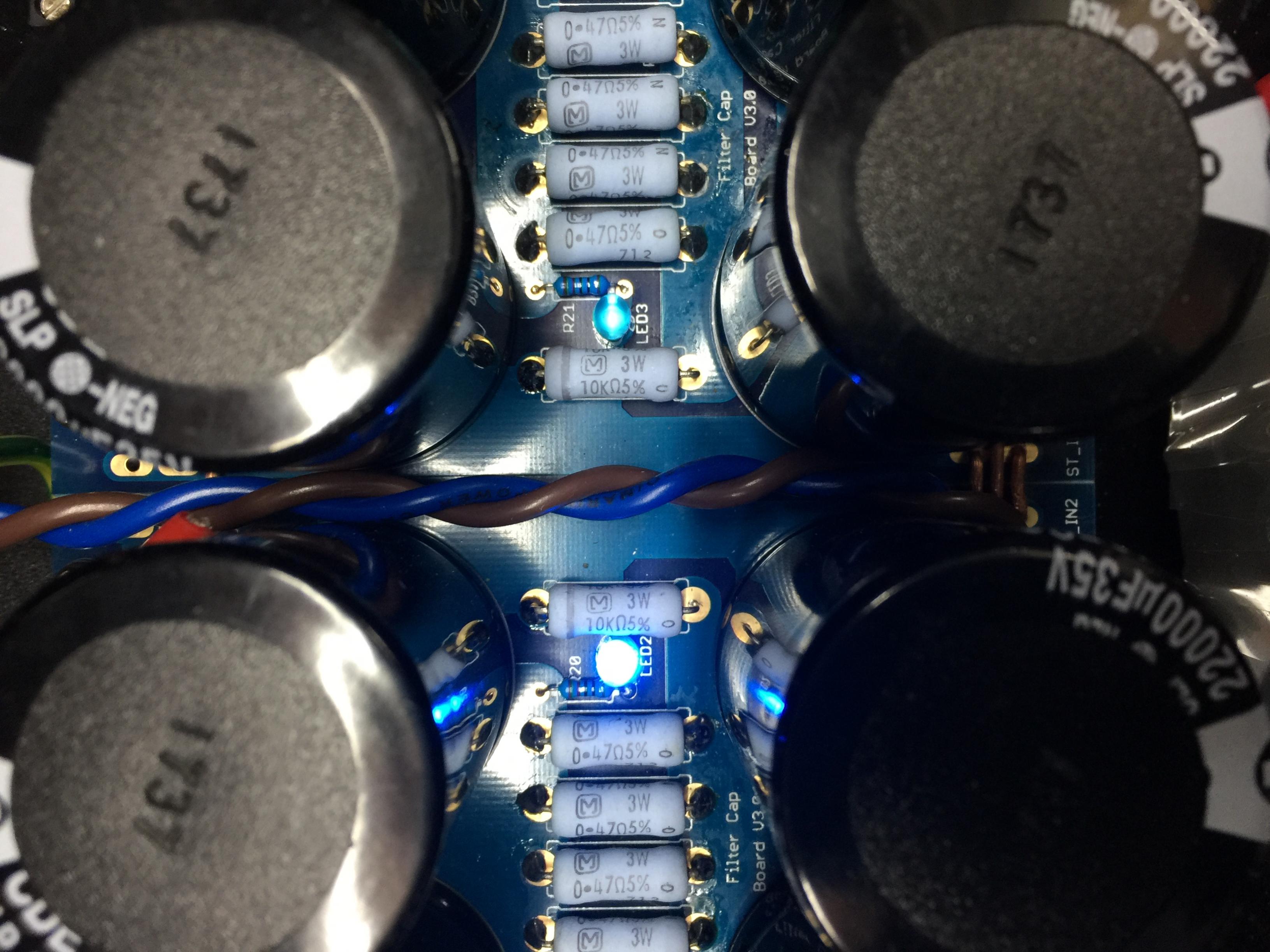

Hello. My LED3 is not glowing and I read -25V at R21. Does this mean I’ve installed the LED backwards? LED2 is all good by the way (glowing and 2.5V at R20).
Speaking of LEDs the first page says the anode and cathode are depicted by a semi circle however both LED 2 and 3 are semi circles. Can someone help me with the orientation of this? Does cathode point to r10 and r9?
Thanks in advance.
Joined 2019
Thanks in advance.
This should help.
https://www.diyaudio.com/forums/ima...mentation/P-PSU-1V30/P-PSU-1V30-schematic.pdf
Try using the traces from LED2 and LED3 to R20 and R21 respectively as the reference points on the board. I found that easier for me to figure it out when I had the same question.
If that's frustrating... then no. The cathode of LED2 points to R9 (away from R20) The cathode of LED3 points to R21 (away from R10)
