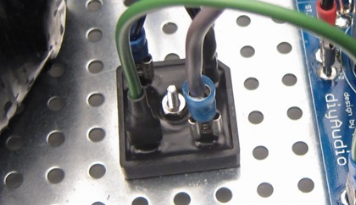

1)See screenshot, I regularly see this connector terminal block being used (looks useful and tidy), does anyone know what this is called or know a parts number?
2)Anyone have a suggestion for diode heatsink electrical isolation pad type?

It's a monolithic bridge rectifier. See post #1 of this thread, then do a search for more info and suggested part numbers. Several members, including me, have posted recommended part numbers for use with Pass class A amps.
Thanks for the info. Sorry, I was confused because it was not listed in the BOM.
Using 2 monolithic bridges is a lot cheaper then the diode bridge, and more simple.
I found this bridge, seems like a good option, what do you think?
Vishay GBPC3510-E4/51 BRIDGE RECT 1PHASE 1KV 35A GBPC
GBPC3510-E4/51 Vishay Semiconductor Diodes Division | Discrete Semiconductor Products | DigiKey
I suppose I also need isolation pads for mounting the bridge on the bottom plate?
Is there anything special I need to know if I use a monolithic rectifier instead of the diode board?
