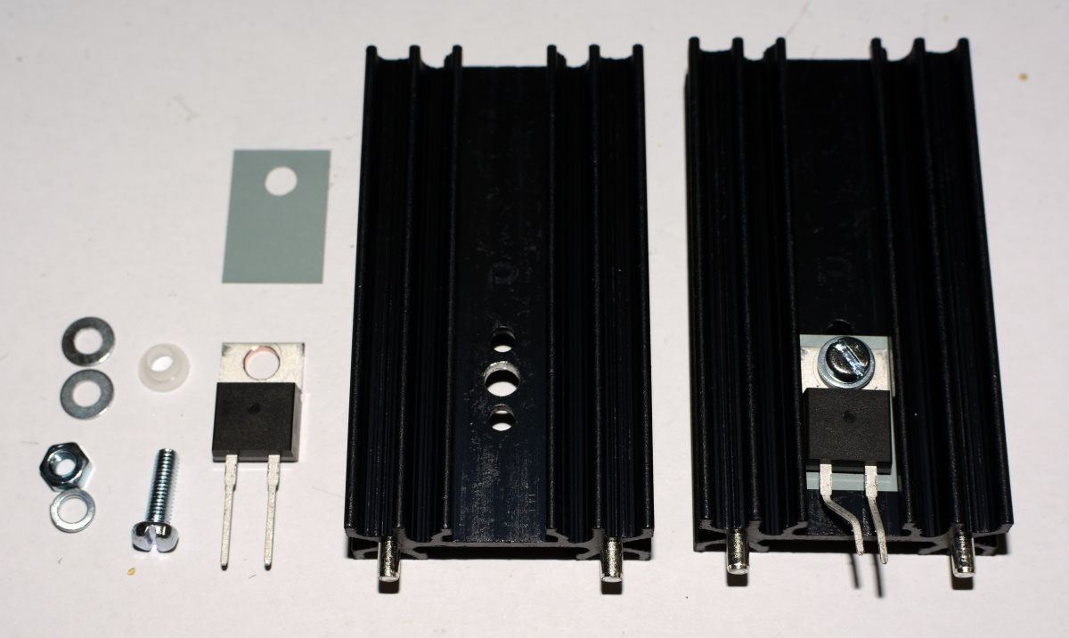

I don't have the special nuts…..what is the name of those?
They "bite" then touching the heatsink?
I think I should also be able to change a diode when all is assembled…..if one of the diodes fails during operation.

Hmmm... I thought SOP was always to attach the part to the heatsink before soldering so that attaching doesn't put undue stress on the solder joints...?
I am with you JeffYoung, that was my impression as well.
MEPER, i believe the nuts are called kep nuts, but i havent found the danish name. Tubeampdoctor sells them, but they are pricey.

My intention is to mount heatsinks first (they are soldered to PCB). Then I will attached the TO-220 diodes to the heatsinks with screw and nut and after that solder the diodes. The problem is when all four heatsinks are soldered that there is not much space to mount diodes. I could mount diodes first on each heatsink and then solder heatsink and then solder diode. But I should also be able to change a bad diode.

Kep nuts, K-nuts, Nuts with lock washer. 6#32 8#32 M3 M4 M5 M6 M8 304/201/Carbon Hex Lock Nuts Keps Nut Tooth Washer FZ | eBay

If a diode did fail, I'd clip its leads, unsolder the heatsink, and then unsolder the clipped leads.
Swap diodes, re-solder heatsink and re-solder diode.
Ok.....it should be possible to unsolder the heatsink. But maybe a problem that will never occur. The solder joints for the heatsinks are "through plated" so could be difficult with only one iron. Maybe a hot air gun can heat up both joints simultaneously.

I ended up using isolation pads and old fashioned isolator for the 3mm screw. Then I needed to "up-drill" 3mm holes in diodes and heatsinks to 4.1mm to be able to insert isolator. In the old days holes had the right sizes? …..I refuse to use nylon screws for this task...….

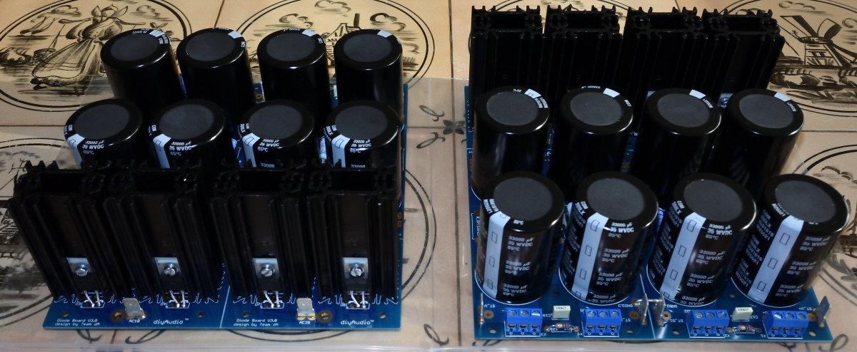

I understand why people just use a diode bridges but these Cree SiC diodes are nice and wire path from diodes to caps very short which I think will give less radiated noise.
A practical question:
I have heatsinks in similar size as in at the picture (from the guide). When heatsinks are mounted (soldered) into place how to mount the diodes using screw and nut? ….not much space between heatsinks to get a screwdriver in between?
How to solve this is not shown in the guide in this thread?
Maybe to have the nut at the backside could be a solution and then use a pincet to hold the nut to get it on the screw and after then a small wrench to hold contra. Any other suggestions?

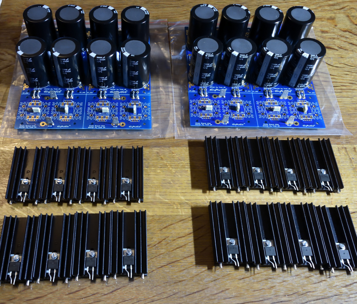

I installed my diodes on the heatsink before the heatsink was installed on the board. I had no issues using this method.
Dan
Yes, I will be doing the same. I am preparing 16 diodes + heatsinks for the two PSU boards. It just takes a little time bending legs etc.....to ensure a proper fit. But quite relaxing mental job. 🙂
You can get the isolator tabs and inserts in either metric (M4) or imperial (#6 machine screw, which is about 3.3mm).

The isolator I used was made for 3mm screw and hole needed to be drilled 4.1mm in both diode and heatsink and for the isolator pads I used a tool for making holes in leather belts to make the hole a little bit larger so isolator for the screw could fit. All 16 diodes are now mounted on heatsink and ready to be installed. I have tested that all diodes are electrical isolated from heatsink. I like that even that it is not strictly necessary.
+1.Hmmm... I thought SOP was always to attach the part to the heatsink before soldering so that attaching doesn't put undue stress on the solder joints...?
To change diode - we have to unsolder heatsink first.
Normally I would install heatsink first and solder it in place and after that install the diode but due to very little space on PCB for mounting I did it as above picture shows. It would have been nice if diode just fit into holes on PCB without bending legs. Seems most of these TO-220 diodes has pin1 = Cathode (case) and pin2 = Anode?
So...….now finished and a very quick function test is performed to see that components works as expected…...caps gets right voltage etc. Next step is to solder components into Pass MX2 amplifier boards. I made two PSUs as I build mono blocks. Power supply build is often the most time consuming of such a build.
