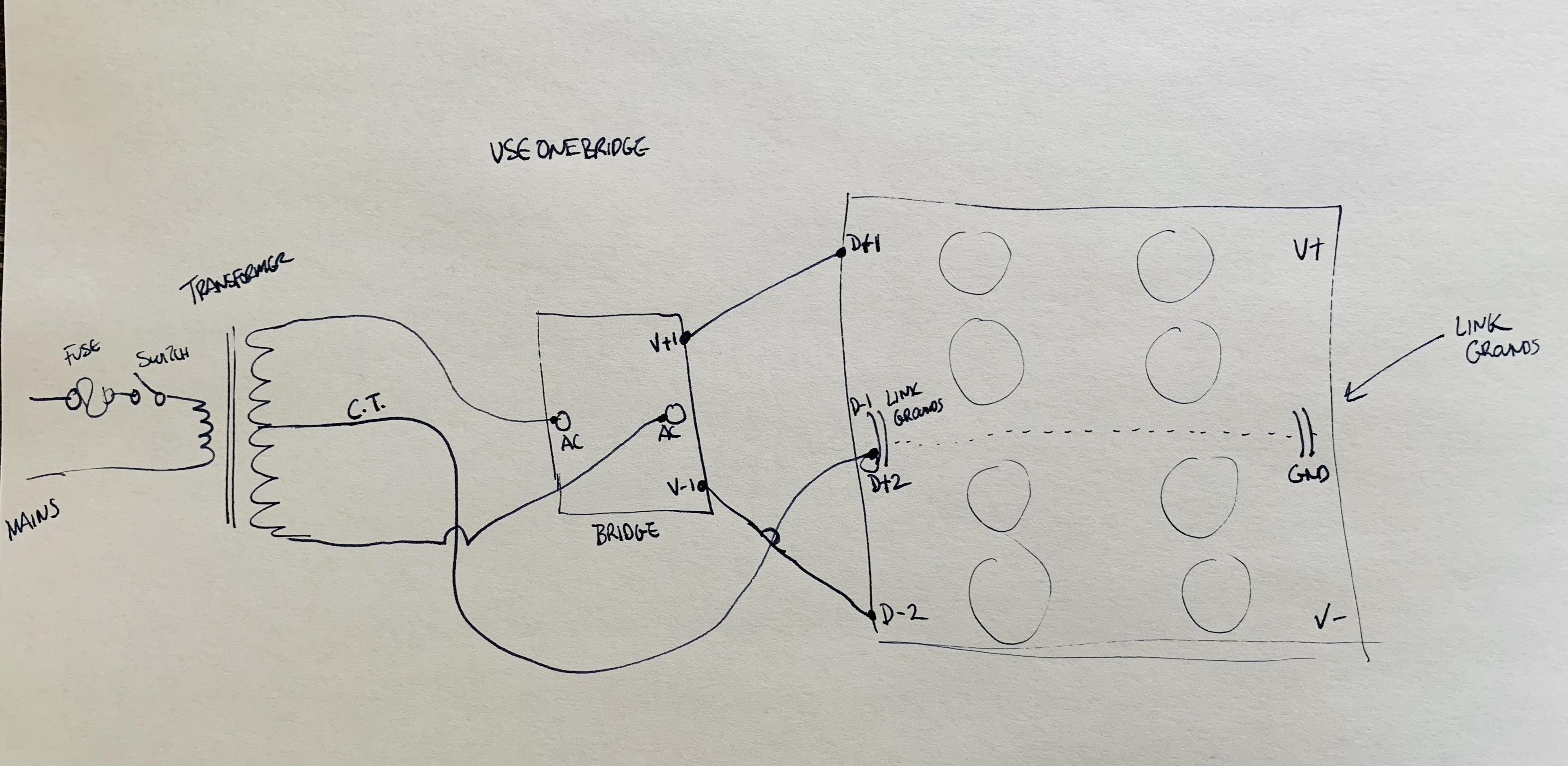

If I keep only a rectifier, but I want to mantain the whole filter board, how can I join the part 1 with the part 2? How must I manage ground? Ground comes from the 0V of the transformer and should enter the filter board. Where?
See diagram - :D

Feel free to snap off the diode section and use monolithic bridges. They work and sound great!
