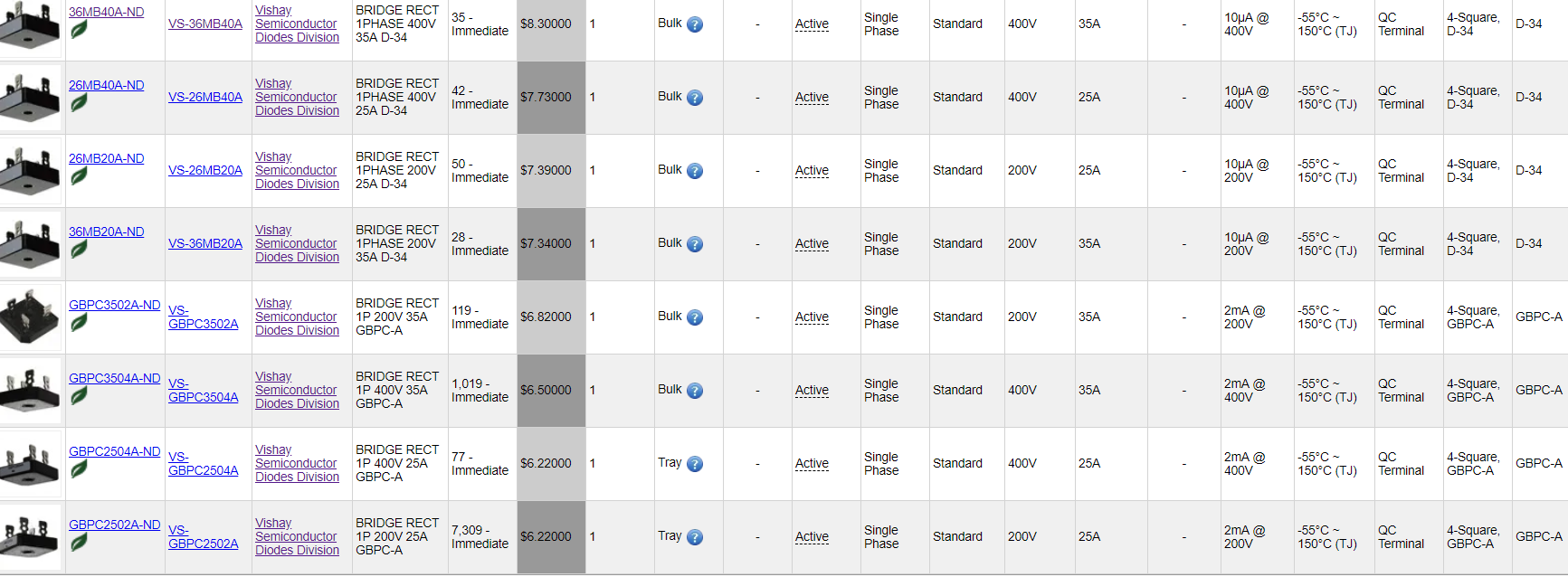

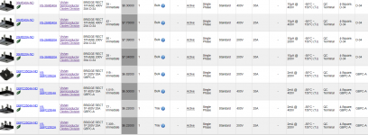

I'm struggling to choose the right spec bridge rectifier. The MUR3020 I understand is 15A and 200V. Could someone recommend one of these in the attachment?
Just not sure if going up to 400V is necessary. I was thinking:
BRIDGE RECT 1PHASE 200V 35A D-34
OR
BRIDGE RECT 1PHASE 200V 25A D-34
Thanks.

I prefer discrete rectifiers, but many people like the monolithic units. They all perform well. The blocks are especially nice if you have space constraints in your chassis - they are so small - definitely a plus.
I think that the GBPC3504 (35A, 400V) is a good unit. If going with discrete rectifiers I have used the FEP30DP and it works well.
For the dollar difference involved, I would go with the higher spec part (400V) every time, although I've noticed that Vf can increase for the higher voltage parts. Try to select a piece with lower rather than higher Vf. This will leave you more potential on the rails of your amplifier.
-Keith-

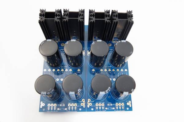

Board features -
The bridge diode section of the board can utilize either TO-247/TO-3P (larger) package devices or TO-220 (smaller). If heat dissipation / heatsinking is not an issue, you could also use conventional axial-leaded diodes. (Not shown.)
IMG_2135 - My Photo Gallery
If you would like to use snubbers on the rectifier diodes you will find that there is room for them on the top of the PCB, and inside the heatsinks.
IMG_2141 - My Photo Gallery
If you don't find enough room there, or would like to try a different snubber layout, there is plenty of place to connect on the bottom of the PCB, as you will always have one of the d=sets of diode pads empty - you can only use one type of diode at a time, for example if you are using the TO-220, the TO-247 pads will be empty and you may make connections there.
IMG_2142 - My Photo Gallery
For designs that require one, there is also room for a snubber on the output. (Per rail)
Also worth noting, in this photo you can see the multiple solder pads for the output - the row towards the edge is for the euroblock connectors, and the inner row, with the larger pads, for wire. There is also a place for a blade terminal. (Near the board edge, on the outside. To be better illustrated in a later photo.)

Capacitors -
As mentioned before, this PCB can accept caps with 10mm lead spacing and up to 35mm diameter. This photo shows 35mm caps next to 30mm. You will also commonly find some appropriate values in 25mm diameter.
PSU32 - My Photo Gallery
The addition of the large solder pads has obscured the markings on the PCB and the ' + ' mark is somewhat hard to make out. In each case the Positive side is marked with the open rectangle and the negative the white or filled-in rectangle. Remember that electrolytic capacitors are usually only marked on the Negative side.
PSU9 - My Photo Gallery
Note capacitor direction - you can see the negative markings on each capacitor.

Looking for a recommendation for a currently available make and model for the big filter capacitors. My build will be a M2, and I hope to try the F4 as well. There are many choices. I'm just looking for something reliable with generous capacity. I don't need to minimize costs, but I'm not looking to waste money. Thanks.
I like the Chemi-Con KMH series caps. I've used 15.000 µF (63V) in a F6 PSU, which i later upgraded to 33.000 µF (35V).
https://www.europechemicon.de/wp-co.../Snap-in UCC/KMH-series-Catalogue-8-2014L.pdf
They are rated to 105 degrees and reasonably priced.
10mm snap-in leads, no greater then 35mm diameter, minimum 25v, value between 15000-22000uF . Bigger value is not necessarily better, although bigger can size usually has lower esr and more ripple rating. 105c rating is beneficial for longevity.
Looking at Mouser stock right now, these look great - B41252A7189M000 EPCOS / TDK | Mouser. The NCC that Silas linked to above are also a great suggestion.
They look great, do check the snap in lead spacing.
I would buy enough to fill the board (8?) and as they are large around 140,000uF in total you will definitely need some form of soft start. I can't remember what the required ripple current rating was for my f4 but it wasn't out the ordinary, when you find a cap you like the look of, check it against a bunch of others and make sure it doesn't seem abnormally low.
