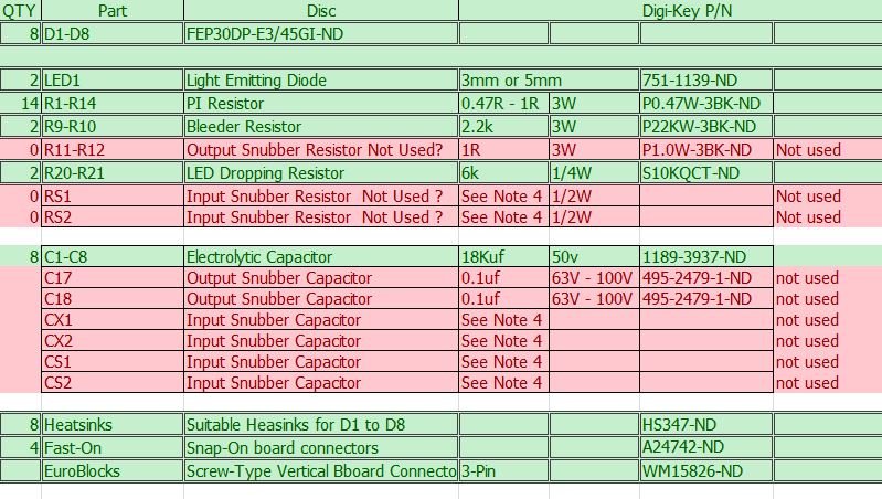

Okay people, it's been a very long time, sine I got my EE and I think I forgot most of it. :)
How's about a sanity check from you lovely people.
I'm using the Universal PSU board from DIY (Thank you very much)
Pass v3 board building Turbo v2
AN-6224 - 600VA 24V Transformer
I read where the snubbers are not needed for Class A, so they have been omitted. Please take a look and correct me if I have anything wrong, missing, or suggestions for changes.
Special thanks to 6l6 for his work here and to the late AndrewT for his no ******** to the point info. Also, all the others, I have read hundreds of pages getting ready for this build and am still rather clueless.

I myself prefer to include Rs1, Cx1, Cs1 and Rs2, Cx2, Cs2 after doing a quick Quasimodo test.
In your final amplifier, either the transformer rings, or it doesn't. The cost of installing those components (2 resistors, 4 capacitors) to absolutely guarantee that it doesn't ring, is so cheap that I just always include them. If they weren't strictly necessary in this particular amplifier, so what? They saved me the hassle (and possible mains hazards) of performing lab measurements on a fully assembled F5T which is driving multi hundred watt dummy load resistors. Just to find out whether it does or doesn't ring without those R's and C's. My personal reaction is: no thanks. Of course different folks think about it a different way, and come to different conclusions.
I looked up your AN-6224 transformer in the Quasimodo results thread but, unfortunately, nobody has reported any measurement results on that particular unit.

Thanks Mark, I'm certainly would use them if I had a clue what values to use. In hindsight, I maybe I should have went to the Q-Test thread and looked trans that would fit my build with data.... If you were not so damn far I'd bring the beer and we could test it. :eek:
Aside from that, I think that thread had build plans... Hmmm

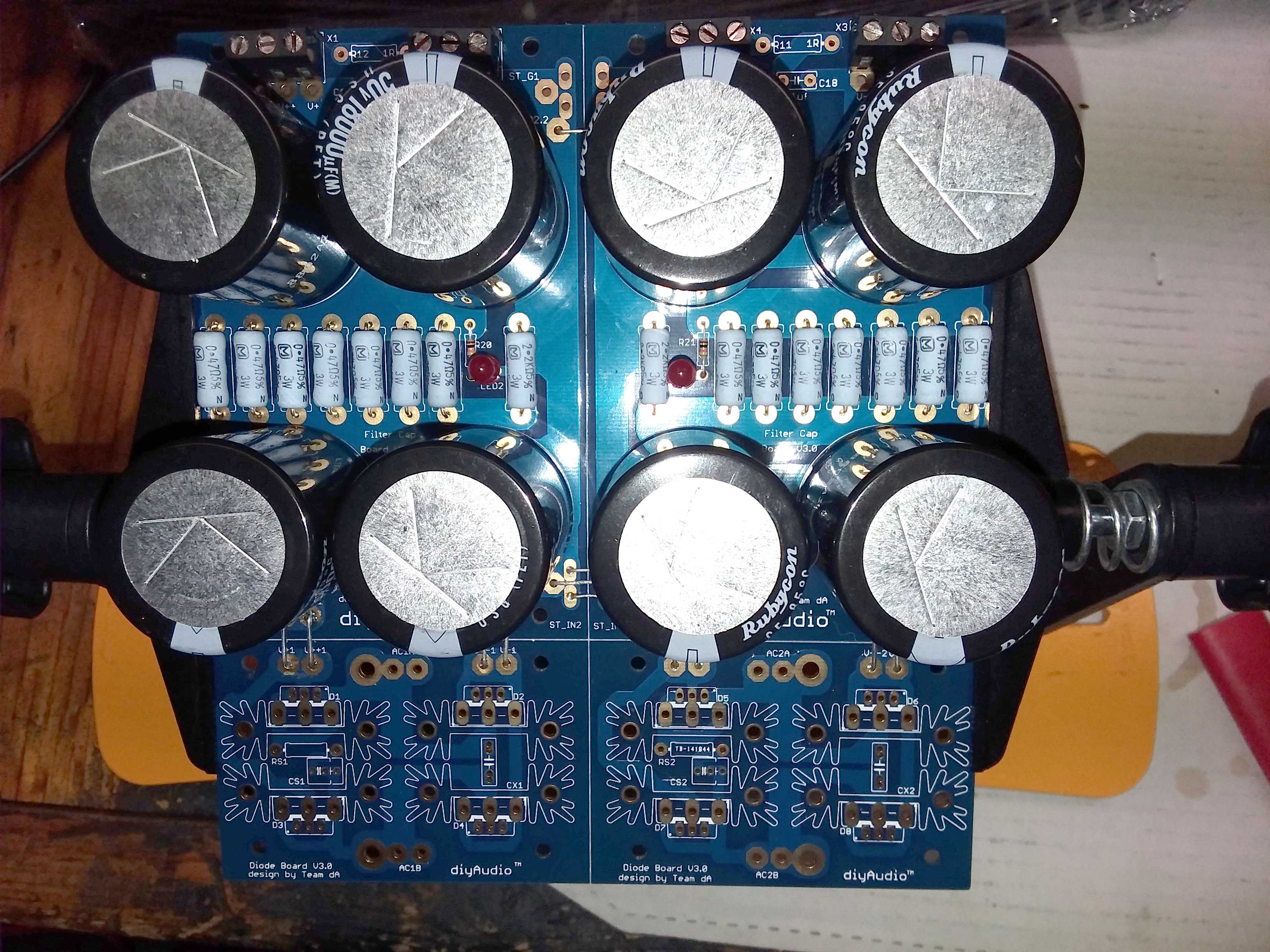

A quick shot to let ya'll know I'm actually building one.

If you decide to use the diode portion of the PCB (bottom of photo in #956) with two-legged diodes, I encourage you to go slowly. Look at the photos attached to post #1 in this thread, for example this one:
When bending the legs, I encourage you to go slowly. If you overbend and break one of the legs, you just lost a couple dollars. Worse still, you may not have ordered extra diodes, so now you need to reorder and (ugh!) wait for the second shipment.
@Mr. Johnson
You know I noticed that photo when reading and I wondered about the 2 leg package there?
I'm using FEP30DP-E3/45GI-ND anything I need to know there? I was holding off installing until I looked at the snubber in the middle of the diodes. I have read so many pages, that I'm a little confused on where and what with the snubbers.
