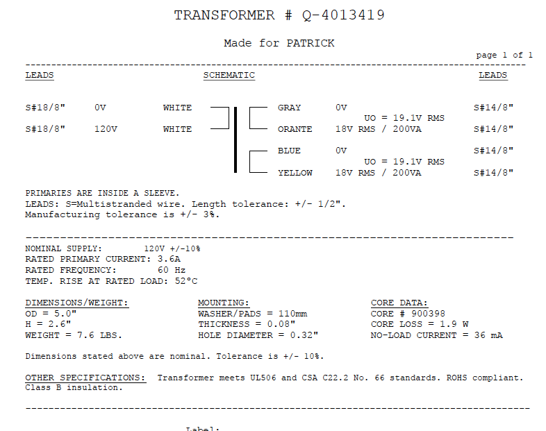

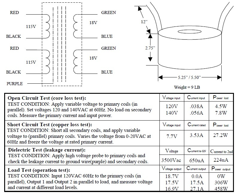

Is there a "quality" factor in transformer design? Say Toroid vs Antek for a 400VA 2x18V transformer? Or is it the law of diminishing returns? The Toroid being more expensive—just for kicks, since the Antek AS-4218 has been out of stock for some time—probably due to this forum (they have 6 now)—I got a quote for a transformer from Toroid (they have a great logo haha.).... They want some big bucks for it comparatively (if you buy just one) unless you can buy like 100 of them... their price is still double Antek if you buy 10+ at a time. Toroid however sent a very detailed spec sheet for their transformer.
If there is a quality thing here... and there's a reason to do anything (and spend double on a transformer)... I'd be willing to do a group buy.

What brand do you mean by toroid?
Is it the below?
Power transformers - Shop Toroidy.pl
If yes, they also have 3 different lines: e.g. standard, audio, supreme audio. I wonder which one you compare to?
Maryland, USA
Toroid Corporation, US manufacturer of Toroidal Magnetic Components

Comparing the specs (or providing them here) of the Toroid model (assuming Toroid Corporation, US manufacturer of Toroidal Magnetic Components) you were quoted vs. the Antek may provide some clues re: claimed performance, but it may be simply economies of scale. Without the specs, there's no way to know for those specific ones. In general, yes - some transformers are better suited to applications than others. I learned a bit when comparing Antek's AN line to their AS line as an example. I'm confident that I've read somewhere that ZenMod has his toroids made in a way he appreciates. Since I can't find the specifics at the moment, he may elaborate.
Edited to add - looks like the right source per your follow up post.
... Does it matter that the Toroid one has only 2 primary wires? Is that because it's been speced more "specifically"?
The Antek can be used with 110V or 220V mains. The Toroid can only be used with 110V.
Jeff.
Jeff.
That is what I thought!
