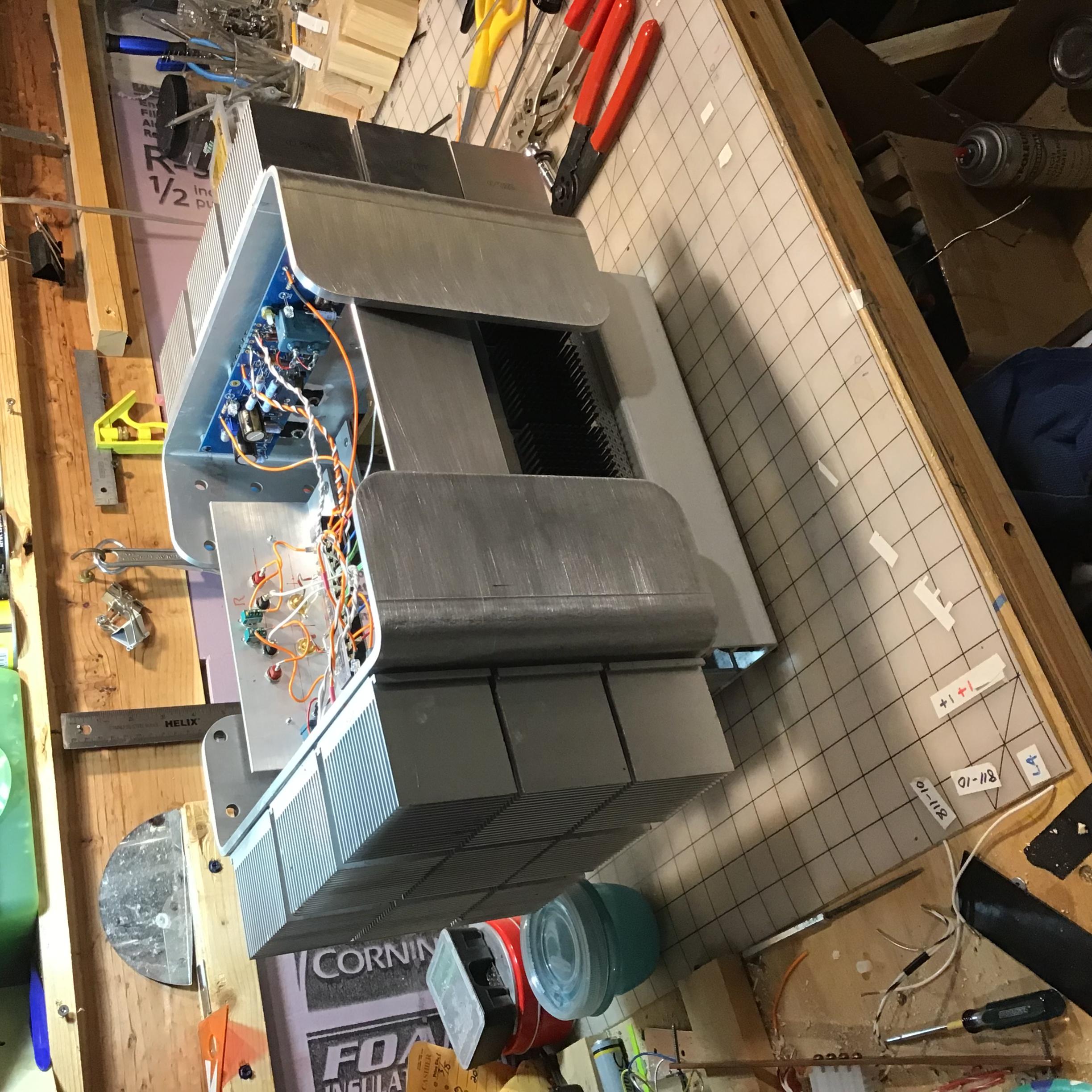

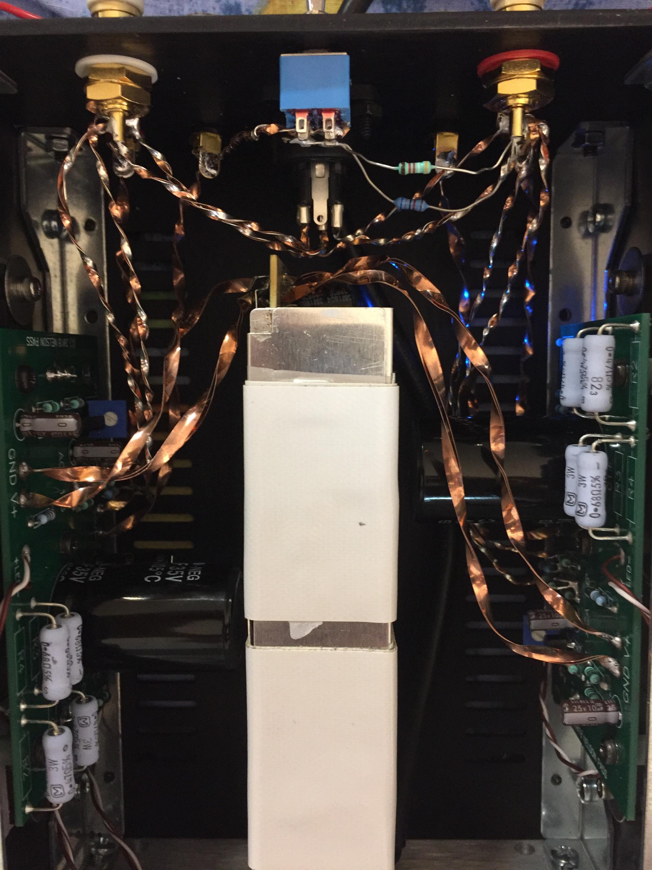

Some part seems to have lost its mojo
It’s been since the start of this thread that I’ve had my power supply board up and running in an Aleph J... but now the transformer is... not humming, it’s pulsing, softly perhaps four times a second. For a time it was dimming the LEDs on the board, one side only. It does not always exhibit this behavior.
I Can hear it when I’m close but the amp ran ok. It’s a mechanical sound definitely coming from the transformer. Do I suspect the transformer itself or some other aspect of the amp?
Everything was built right, what might fail that would cause pulsing?

6L6,
I Measured bias across R18 per Aleph J build instruction....0.45 volts dc on the right channel and 0.47 on the left.
I had an issue with a very different tube amp that had LED lights, Christmas lights in fact, that were run off the incoming household voltage. They dimmed/flashed at about the same rate: 4/s and messed with the music presentation until I swapped them out for better bulbs... could the LEDs on the boards have any strange effect? I used some cheap blue LEDs both on the Aleph J boards and on the PSU boards...

With my problem of the 4 cps noise coming from the transformer, seeing as the amp worked fine for five or six years, the question must become in my mind what things wear out?

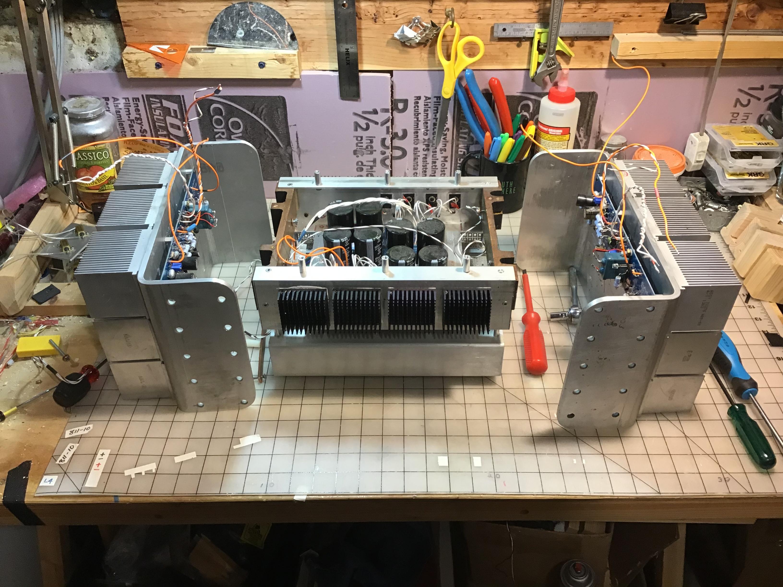

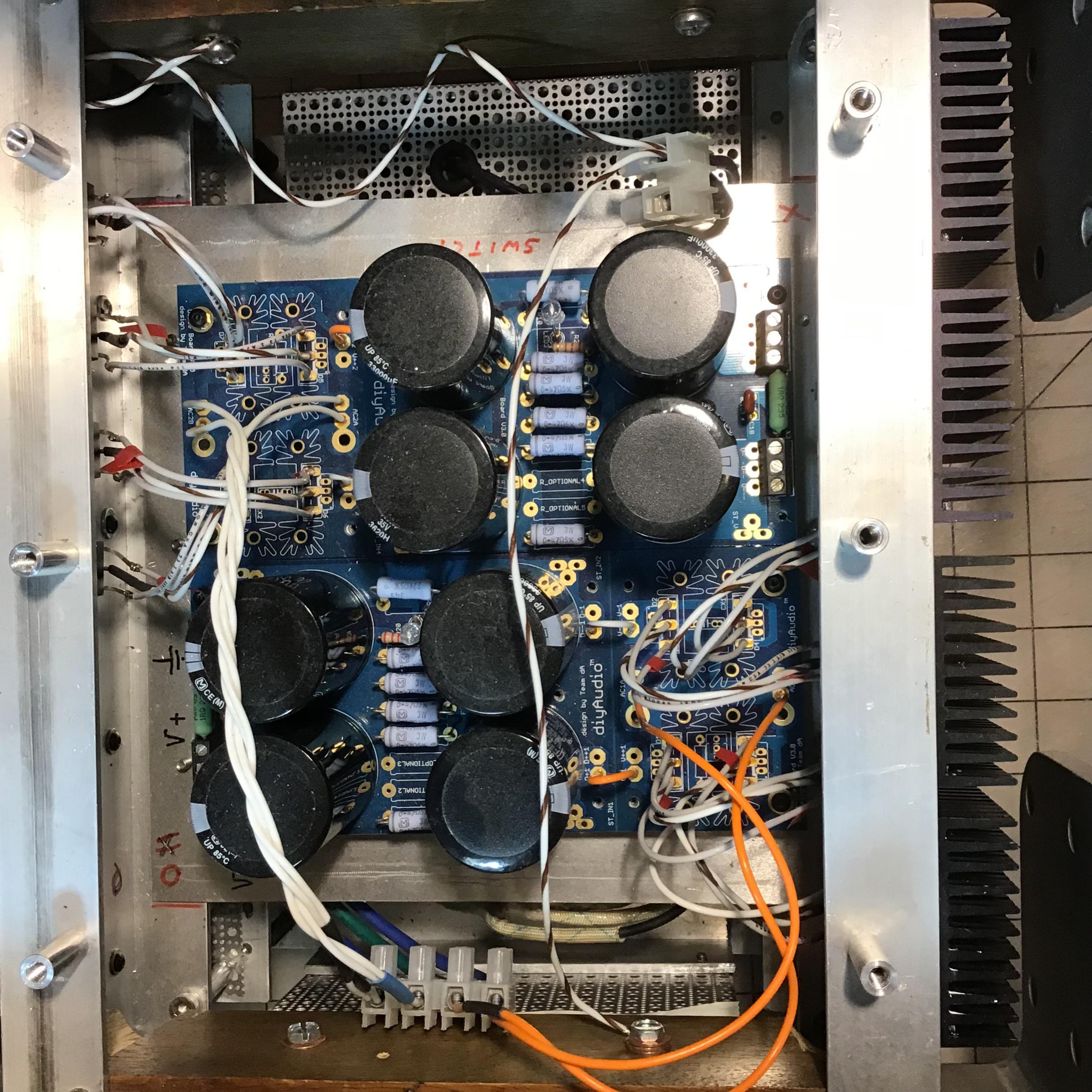

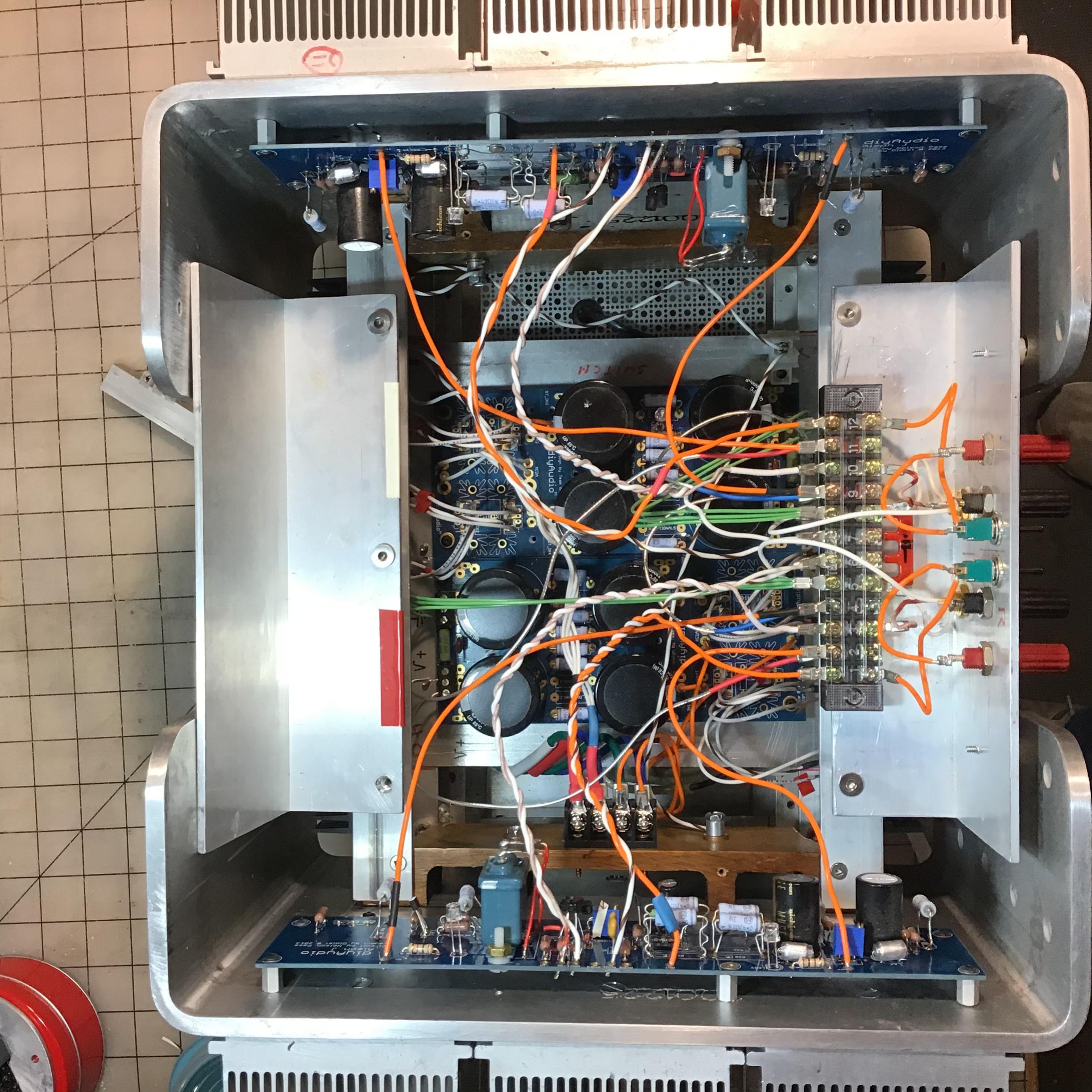

The phots only show the general construction. The PSU is central. I did attach the diodes to the frame for heat dissipation, no wires became crossed/touched there. All solder joints are in good shape and all barrier strips were possessed of good contact. There is no corrosion.
I’ve not gotten down to the actual transformer yet. Is there a way to test it to reveal any anomalies?

Well.... your power supply wiring is waaay toooo long. The whole current path:
transformer - power supply - amplifier - speakers wiring should use as thick as practically possible and as short as possible wiring (bus bars even...).
Check the ACA wiring, especially DC bus from the SMPS to either PCB.
Your concerns are appropriate. There are unique problems when building vertically, some leads must reach across and up, that’s unusual.
It’s not the cause of my issue, I’d like to make clear, my suspicion lies with my choice of connector. Solder would be best but sometimes one must consider the build and tear down sequence. In those cases where a barrier strip is called for I’d recommend standard screw down barrier strip with good copper spades.
The Aleph J was my first SS/Nelson Pass build. I built the case and heat sinks from scrap. I could not afford a pretty premade box, spent all my coin on the other parts. I recommend this approach for creative minds only. I just no longer recommend or use those white plastic “Euro” barrier strips. They have fail me too many times. In theory they are better, in practice, they are not!
For those who wonder about sonic issues with the connection type or any extra inches of wire... don’t worry. It is the wire path more than the amount of wire that matters. (It’s the circuit design that matters most of all!). I’ve not heard any difference between a good solder joint and a good compression joint but I admit one needs to revisit compression joints 10 years down the road while a properly made and cleaned solder joint will last a very long time before needing cleaning. But they do age, and they do require cleaning... and most of the refurbishing work I do finds poorly made solder joint far more difficult to fix than any spade connection. And I’ve seen many a poor solder joint! Most have never been properly cleaned after being made. Flux is nasty and does your circuit no good.
It seems strange for someone asking for diagnostic assistance ranting about build technique I’m sure! I come at this from an artist/craftsman’s perspective, from soldering jewelry to soldering components. Friends asked me to look over old gear and a made a new friend who was a military radio man from the days when radio was king. I’ve also been a technical illustrator for service manuals so I’m keen on being able to access and service anything. I’ve no comrades in this path I’ve taken into the world of HiFi. I very much appreciate all the help I’ve received on this forum. I’m trying to pay it forward.

Ok, I’ve fixed the wiring. It was in fact the problem... not a failed component! Everything works fine and the new wire paths are an improvement. Five SS amps and six tube amps from scratch have me finding better solutions even if many would scoff... but hey, what’s the point of building for yourself if you are not going to explore your own abilities and style?
