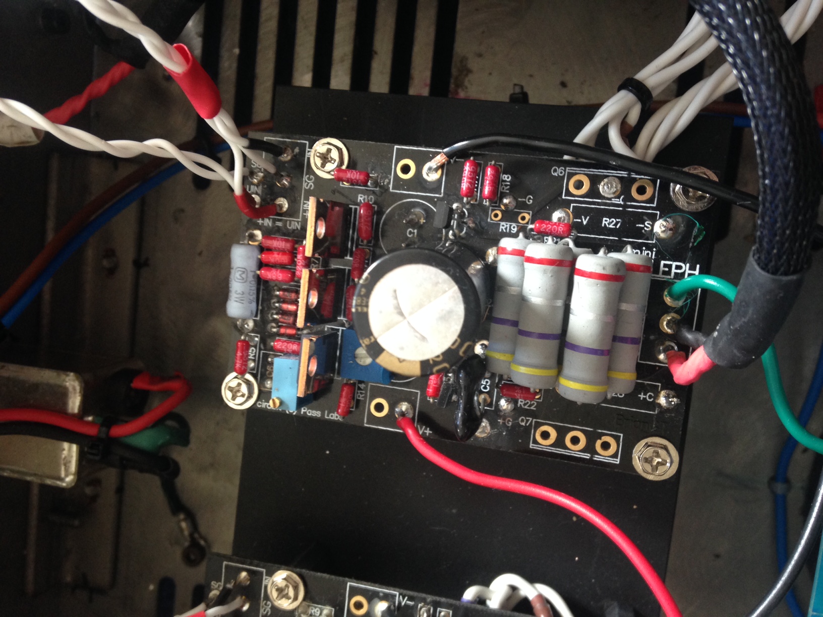

…. on my boards I have 390r at R18 .

I don't see an R18 in the schematic. The resistors you are looking for will be the largest ones on the amplifier board. They will be very low resistance and will be hot when the amp is operating. I can tell you which ones you are looking for if you post a picture of the amp board.
It doesn't look like your schematic matches your boards. Those big blue ones to the right side would be your source resistors. Looks like there is 5. There should be an even number. One for each output device. You should find the proper schematic so you know what the bias setting is supposed to be. If the bias is set too high you will melt your amp.
There is another underneath . The stuffing guide would probably be more help.

You need to find the ones that are connected to the source leg of each output device. Looks like the output devices are remote mounted. Follow the wire from the source leg of the output device to the first resistor they connect to. Those are your source resistors and where you measure your bias current. I can't say for sure what the bias current is supposed to be without the proper documents for your amp.
