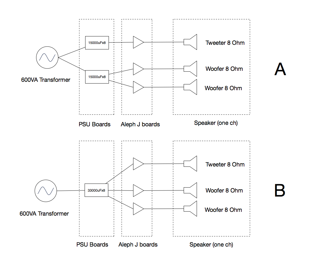

I'm working on multiple Aleph J (digital crossover + 3x2 ch aleph J).
A question about PSU.
Will it make any difference in SQ between attached A and B configuration?

Simple is good, more capacitance is good, simple has less chance for error.
Thank you. Great. I respect NP's simplicity and it's the key of the good sound, but when I do something myself I always forget it.
Just one more question.
Original Aleph J has 8x15000uF, as far as I know. I always wonder if 15000uF would be the "sweet spot" for AJ, since NP could have chosen larger ones (22000 or 33000uF) without increasing the cost and the size much, but he didn't.
Knowing what I know about how Nelson buys parts (which is to say in very large quantity...) 15,000uF was probably a sweet spot in terms of usefulness across the entire line, not just that particular amp.
That size is more than enough for a very quiet PSU. We in DIY land like to increase it, because as we all know, total and complete overkill is just barely enough.

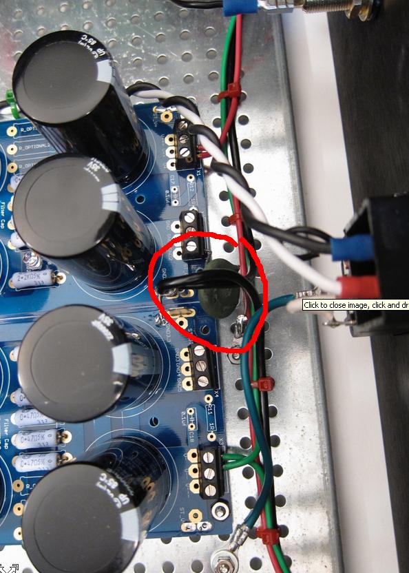

Hate to say it but these are some of the worst looking solder jobs. For DIY duty the HASL board finish does a superior job. The examples shown do not demonstrate solder flow through the plated holes and nice fillets. Gold is o/k in a solder bath environment where the joint can be flooded with clean solder. For hand soldering, it is the worst. Gold inter metallic products create some real crap.

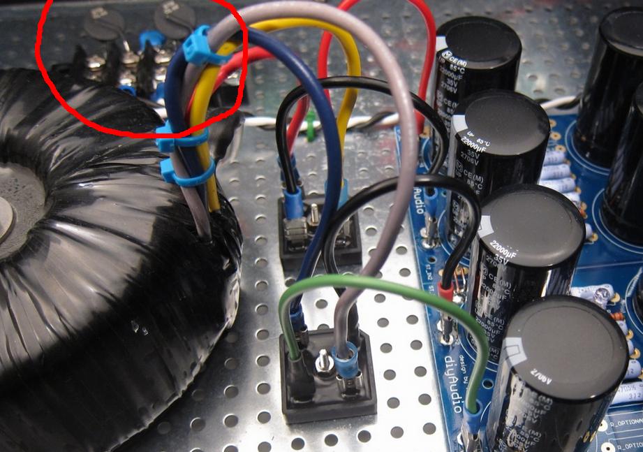

Then, in the attached images, I see a few components which I can't see in the schematic. What are they and what is their function? And can someone give a few snubber R and C values that will work with the Honey Badger (for the components listed in the schematic)? The math involved and the means to get the ESR value for the transformer are beyond my abilities, I think... A suitable transformer could be this one, I think.

Can you tell me anything about the snubber components?
Thanks again!
