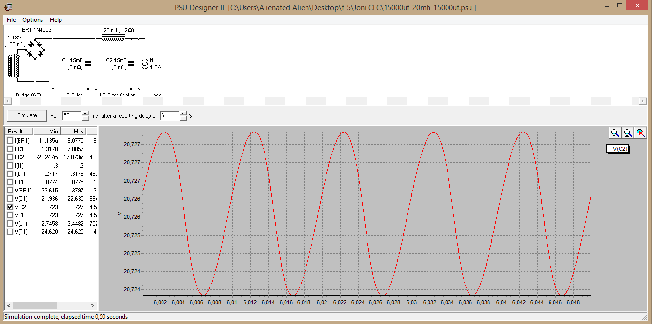

"With CLC part 20mH and 1x30000uF on each side of the coil, there is virtually no visible ripple. Signal modulation was also less than about 16mV pp.
Only 1.8mH as in the diagram, shown not long ago, gives visible ripple of about 144mV pp with sinus form, and signal modulation is approximately 16mV pp.
Although I once have discarded CLC part because of a "Boogie Woogie sound", think I'll try again for my last and ultimate class A amp. The problem is getting into 20mH with minimum resistance.

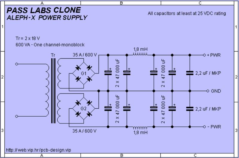

Or maybe this one: Jantzen Air Core Coil 20mH AWG17 2,55Ohm, 000-1718 - Fidelity Components Shop
I found this CLC schematic. This is probably the one they are discussing in the Norwegian site, but instead with 30 000uf on each side of a 20mH inductor.

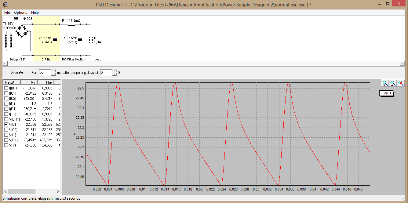

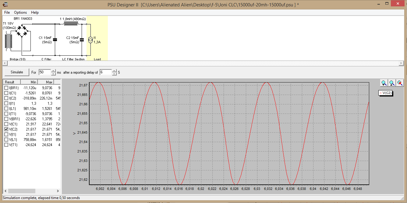

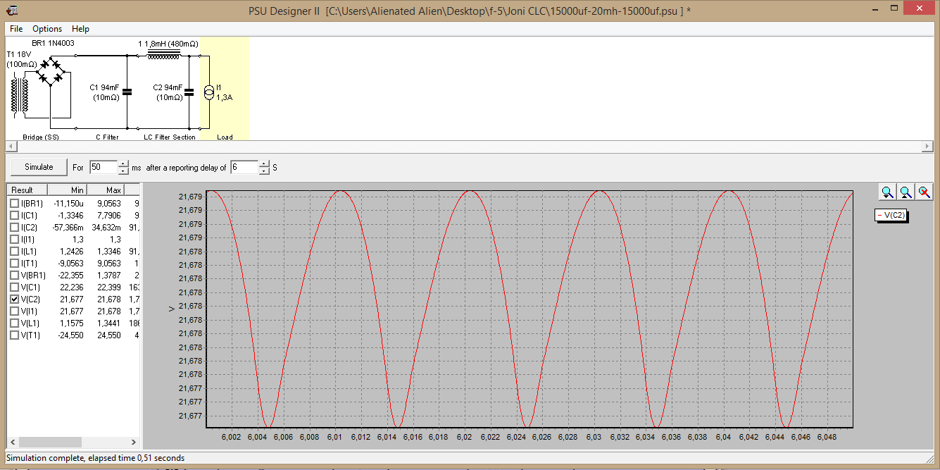

Attempts at simulating a CLC PSU:
I have never used PSU designer II before, but here we go.
Uknown parameters:
¤ The resistance of 18 + 18V 400VA Antec trafo. I found one example where a 30V trafo had 100 milliohm resistance.
¤ The resistance of the caps. I found one example stating that 15 000uf caps have 5 milliohm.
Other facts:
20mH was difficult to find with low enough resistance.

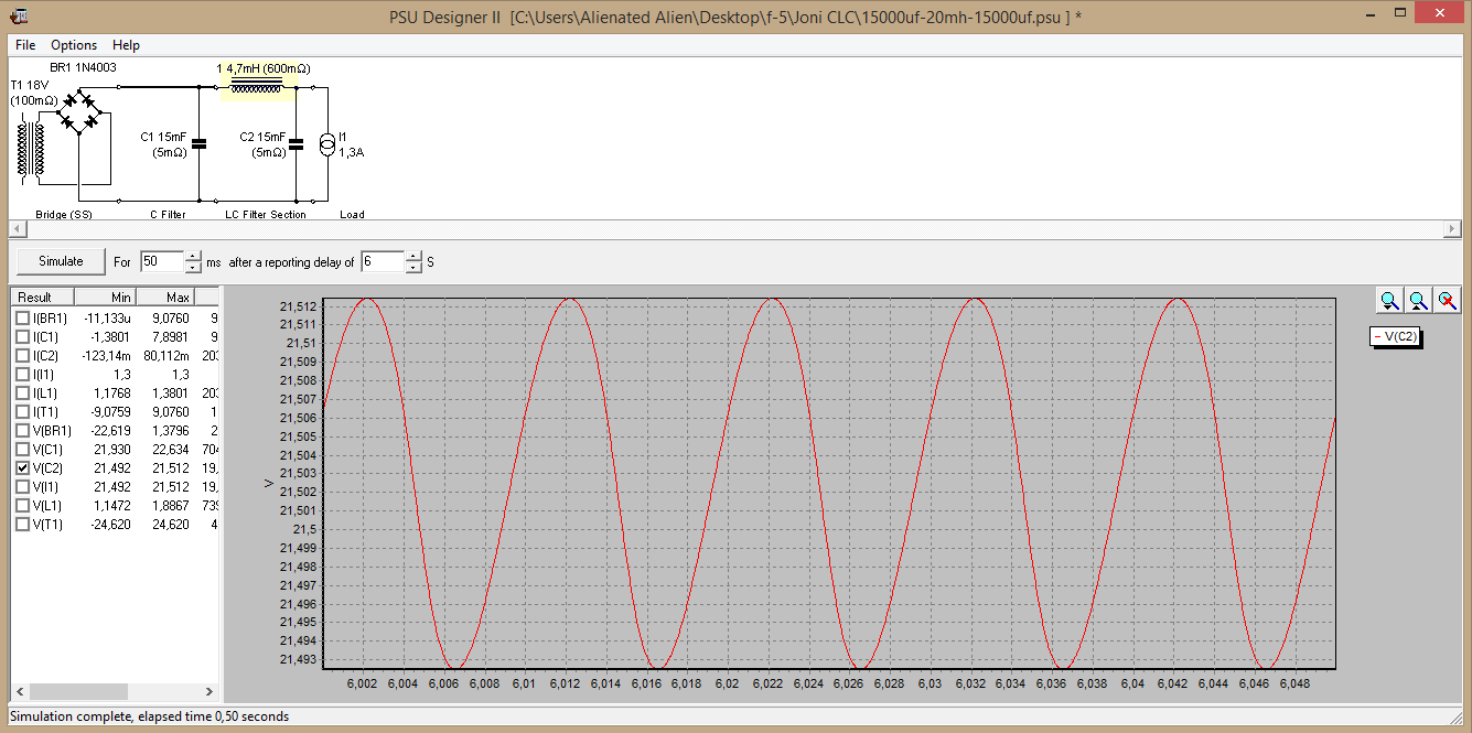

The resistance of the 4,7mH/0,6 ohm/350W Jantzen foil inductor is known. This is the largest air coil with copper foil I found at partsexpress.com. Foil has much lower resistance than regular inductors between 0,48-0,6 ohm, but is it low enough not to produce heat? They handle 350W so it should be enough.
I chose a 1N4003 as bridge rectifier (30A/200V). Mark J suggested more than 30A for larger capacitor banks but, the PSU designer II simulation was not affected much by this choice. Something to consider later.
¤ I hope I am correct in assuming that the F-5 has a 1.3A load on the PSU.

4,7mH/0,6 ohm/350W Jantzen foil inductor: Jantzen Audio 4.7mH 14 AWG Copper Foil Inductor Crossover Coil
1,8mH/0,48 ohm Jantzen foil inductor: Jantzen Audio 1.8mH 16 AWG Copper Foil Inductor Crossover Coil
A thought from all this is that the roundness of the curve is sensitive to the resistance of the capacitor. I don't know the resistance of the capacitors, as this is not written on the cap. So I am left guessing, and this affects the simulations a great deal.
Uknown parameters:

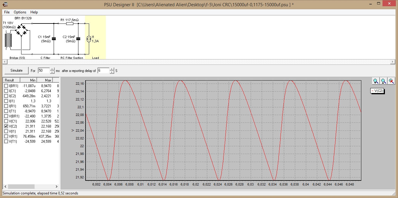

Attempts at simulating a CRC PSU:

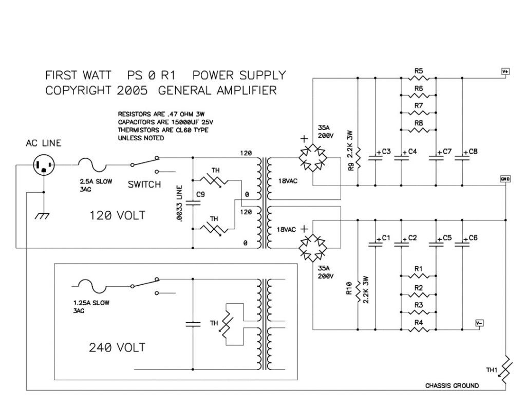

I give you the original Nelson Pass CRC power supply from the F-5.
You decide if it is correct. I did my best, but I am bioengineer, dammit, not an electrical engineer. 🙂
I added the 0,1175 ohm resistor because: Req= (1/0,47+1/0,47+1/0,47+1/0,47 )^-1= 1/8,51 ohm = 0,1175 ohm
Hope that is correct.
Papa's CRC PSU is pretty jagged. I guess that is why CLC is preferred.
The 1N4003 is not a good choice of diode for that supply, not even in simulation. Compare its datasheet "max average current" spec against the simulated load of 1.3 amperes: oops!
I suggest you simulate using 35A, 1000V diode bridge rectifier in the GBPC package (like this one). There is a SPICE .MODEL for it on the Cordell Audio website.

CRC:
I simulated the wrong cap for the original F-5 PSU. Here is how it looks like after the second caps, on two different bridge rectifiers. Still pretty ugly graphs. Would be fun to do the CLC.
Mark Johnson: I found a stronger rectifier for you in the red graph. This one: BY329-1000 Datasheet - Philips Semiconductors | DatasheetLib.com
I see no difference between 1N4003 and BY329 in this particular graph.
