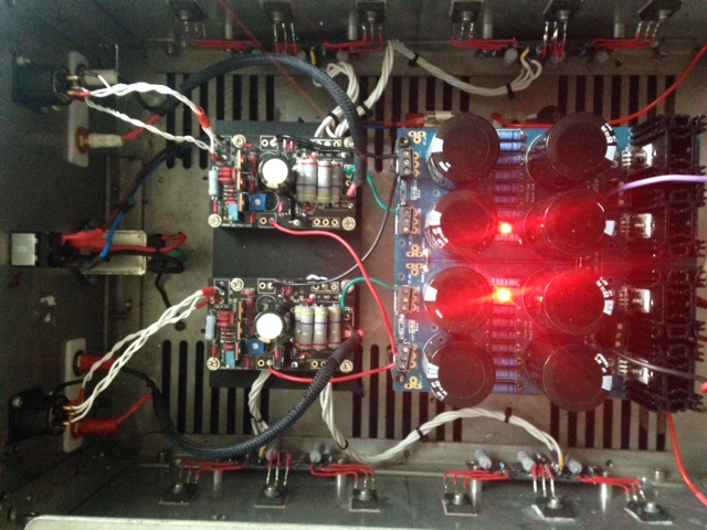

Hi Folks ,
I have sound from both channels ,but a good hum to match . I haven't connected the star ground yet . I have a cable prepped complete with in CL60 .
From what I understand …. this goes from the G on the psu to the chassis ?
Thank you , Richard

"star ground", what do you mean?
The amplifier must have a Main Audio Ground.
It's where the Signal Input, Signal Output and Power all receive a common reference from.
If you don't have this wired up the audio just won't work !
Or
did you mean Protective Earth?
This makes mains equipment safer to operate.
This is what will blow the Mains fuse if there is a catastrophic mains failure inside the Chassis, that shorts to Neutral or to Chassis.
This does not stop the audio working. This does not cause hum.

Did you mean A connection from Chassis to main Audio Ground?
This is what stops exposed terminals becoming Live during a catastrophic mains failure.
This too blows the mains fuse.
If you have audio and hum, then that is due to a wiring error. Not to a missing Chassis connection.

I have audio and hum ….. I have no star-ground connected to the chassis .

No connection to Chassis will not stop the amp working.
No connection to Chassis will not cause hum.
Your hum is coming from a wiring error.

Ok …. found the source of the darn hum ….. XLR cable . Duh 🙄
Now I just need to set the DC off set …. I have -9.8 and -28.7 …. I'm lust watching it as the temp goes up !
From what I've read , I need 100mv using multi-turn at R8 measured across the speaker output .
Have I understood this procedure correctly ?

This does not sound right...................... From what I've read , I need 100mv using multi-turn at R8 measured across the speaker output .
Where is R8?
Where is 100mV AC or DC measured?
Where is R8?
mV DC measured at the speaker terminal . R8 is the up-right multi-turn closest to the rear of the PCB .

That's not a chip amp. It's a class A amp. Sounds like you're confusing DC offset with bias adjustment. DC offset should be as close to zero as possible when the amp is warmed up. Normally you measure your bias current at an emitter/source resistor. The grounding scheme in that schematic looks dangerous.

I have ignored the grounding suggested on the schematic …. As you pointed out …. I'm pretty confused about the bias/ offset thing .

Chip amp normally refers to an amp in an integrated circuit. To set your bias you need to measure the voltage drop across your source resistors. If you used .47 ohm resistors for R118, 120 & 122 you should measure 235 mv across them. Measure across all three one at a time and average the result. After that is set, check your DC offset at the speaker output and adjust it as close to zero as you can. Normally your bias adjustment is what determines how hot your heat sink will be. The more bias current you have, the hotter your heat sink will be.
