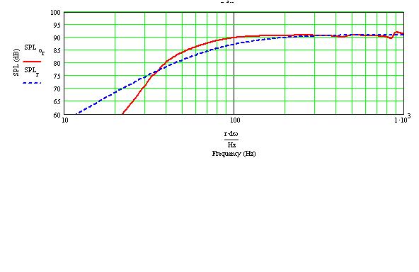

I was reviewing some of the design work That MJK did with the Fe164. When he folded the TQWP it developed a ripple in the mid frequency range. One of our earlier designs has the fold point just below and behind the driver with the fold going side to side. This results in a wider front baffle, yet it appears to charge both sides of the line equally. With the fold going front to back I think it might be important to ensure the line gets charge equally. I am not sure how this can be evaluated?
Any thoughts?
That's surprising. All the statements I've read concerning folding pipes say that there are no detrimental effects. :xeye: Did I miss something?

Maybe I read it a little too fast but I think the diagram on page 11, 12 shows a ripple. I am not as up on the theory as you guys I just threw the idea out there. I may be off the mark and it may not be an issue.

Depends how well you fold it... in my fold the drivers are still appearing the same offset from the end of the line... in your fold they have different offsets (not necessarily a bad thing, just another detail the models don't handle)

I suggest that we take a step backwards for the moment. One thing we have not done is set performance goals.
I suggest that the performance of this reference project should exceed the performance of the Fostex reccomeded enclosure:
http://www.fostexinternational.com/docs/speaker_comp/pdf/recom_enclose/127e_enclrev.pdf
Having said that, I think the next step should be to model a single driver design that will better the preformance of the Fostex design.
Once that is in place, the bi-pole version should essentially be a matter of doubling the mono-pole design. We could also investigate series and parallel connections.
If we do the bi-pole design first, we have no relative benchmark to judge the performance of the design.
Anyway, just my 2 cents.
