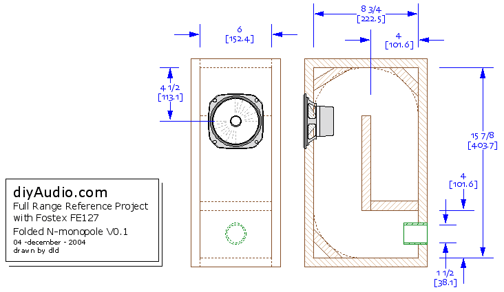

x. onasis said:"Elegantly folded"? I like the sound of that. What sort of bass are we expecting? I'm imagining a rather deep, narrow box that's only about 18-24" tall sitting on it's own matching sub for a stand. Go ahead, tell me the sub won't be necessary.
The narrow deep box isn't the perfect fold, but i'm still noodling it. Folding it for wide & shallow is a bit more elegant fold wise -- it ends up being wider & shallower (which with the monopole could push the baffle step low enuff that reasonable proximity to real wall would deal with baffle step.

gmilitano said:Assuming that Zport = 28.5
Set Zport to 30" -- a port out the bottom would work too.

x. onasis said:I'm imagining a rather deep, narrow box that's only about 18-24" tall sitting on it's own matching sub for a stand. Go ahead, tell me the sub won't be necessary.
1st draft of the narrow folded box... (using guess & by golly method)
Sub not necessary to enjoy the music... only if you want to shake the room.
dave

Well, I need to get into the fun. Here is what I have come up with. It is a little larger than the v0.1.
I'd appreciate it if someone could look over my model to see if there are any errors.
I chose the internal dimensions 6.5" X 10" so that the enclosure could be built with standard 1"X8" and 1"X10" boards which should have a nominal 3/4" thickness.
I'll have to check, but I think a 3" OD pipe has an internal radius of 1.414".
Gio.

a nominal 1x8 would be .75"x 7.5" I believe.
A nominal 1x10 would be .75"x9.25"
1x12 = .75"x11.25"
Maybe finish material is different but I don't think so

BL is not doubled when wiring in parallel. Also, because of the larger size of the cabinet LF begins rolling off prematurely.Modeling two drivers in Martin King's MathCAD worksheets
