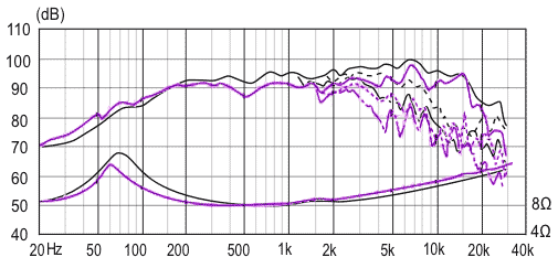

For comparison here is FE126 (black) vrs FE127 (purple) factory FR & impedance
dave

You needed to read between the lines, my 1st choice is the 127 -- the 126 has too low a Q to use in anything but a horn (but it does have an extra couple dB sensitivity)

I like the FR and extra couple dB sensitivity of the 126. However, I was wondering about the low Q and thinking it may be a tad bright.
The 127 has a couple more peaks and dips, but shielding makes it more versatile.
I will be happy with either one.
The 127 is about $1 more than the 126 so price difference does not really matter.
It looks like we are leaning towards the FE127E.

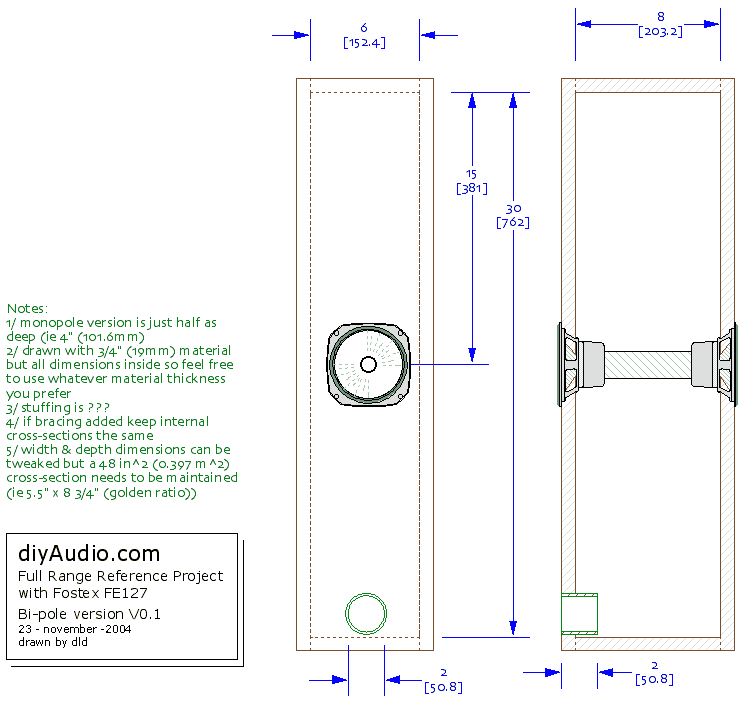

Now that it appears we have a driver, maybe we should all post links to projects that use the 127 or similar fullrange driver, and think about them. There is no reason we have to do only one design. In fact I propose we first do 2 designs- a bipole, and one with a single driver. Maybe they are basically the same design - one with BSC filter, one with 2 drivers and a bigger box. Or maybe each completely different
I'm just going to throw out some numbers then I have to get back to gluing up some cabinets.
Internal cab dims for bipole: 30"H x 6"W x 8"D. 2" dia port 2"L.
Driver should be near the middle of the line as much as possible.
Opinions?
Here is v0.1 drawing of Tim's suggested ML-TL. Since it has the driver a 50% this could be elegantly folded -- particularily interesting for the monopole version... i'll have to dig out Denson's paper and do it mathematically proper instead of the usual guess & by golly method.
dave

Monkey-works time!
Why not use a combination of an omni with direct raditor? This way you could get a LOT more bass at less cost WITH-OUT a crossover - allowing 16 ohm or 4 ohm impeadance (assuming both drivers are 8 ohms). Additionally you'll be able to use the BEST driver for the money for your upper-mids and tweets and perhaps even shape the rear of this driver for better sound.
planet10 said:
You won't get more bass than can be had out a quarter-wave resonator, and a dipole BR -- by its very nature -- will get NO bass. Are you sure you don't mean bi-pole?
The only point of a BR would be to get a box that is shaped much closer to a cube.
dave
