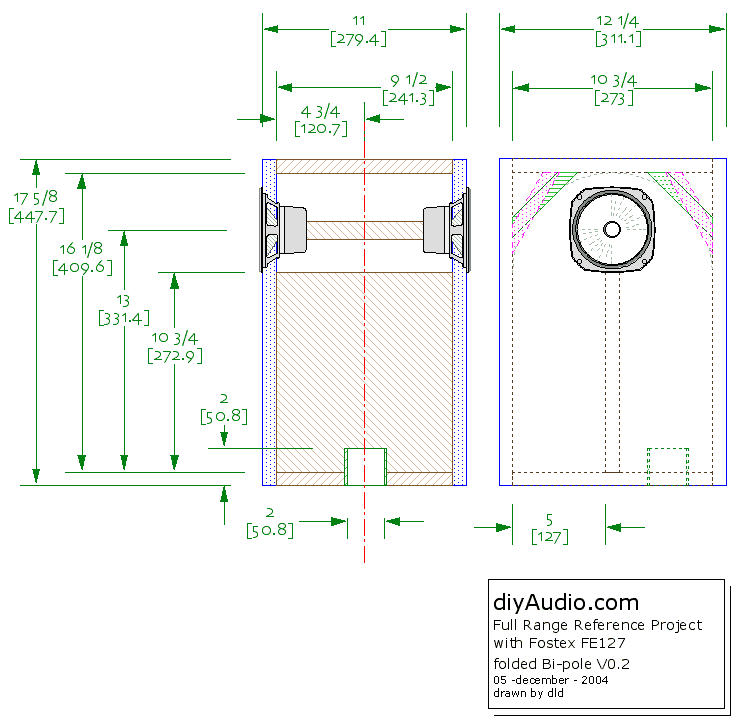

planet10 said:Tim,
If you were to put a rebate into the baffle to flush mount the front of the 127, out deep would it be?
dave
The frame itself is only 2mm plus the final thickness of whatever sealant is chosen. The underside of the frame is not flat (the edge is rolled over) so the sealant will not change the total thickness very much. Since I'm using rope caulk I would stay at 3mm or 1/8" in the States.

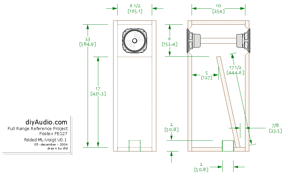

Anyway, how about this?

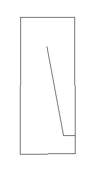

Internal dims of 23"H x 6.5"W x 10"D. Drivers mounted on the narrow side 20" from the bottom (internal). Internal baffle when viewed from the wide side begins at 6" down 5" from the back, tapers to 1" from the back. A 2" x 2" port at the bottom on the back. Image below from Martin King's MathCAD worksheet

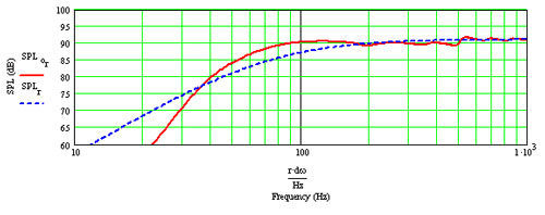

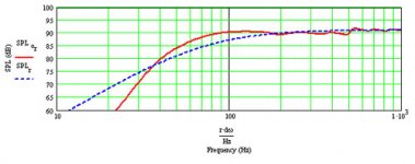

Timn8ter said:Gio
BL is not doubled when wiring in parallel. Also, because of the larger size of the cabinet LF begins rolling off prematurely.Modeling two drivers in Martin King's MathCAD worksheets
Hi Tim,
My model was in series. I have gone through the MKJ document and while the text does not mention anything about doubling Bl in series, the example on the last two pages does show Bl as double. In that regard, it is not clear if Bl should be double or not.
Also, how do you know that the LF begins rolling off prematurely? Is that shown on the graphs or is that experience? I like to play around with the MathCAD models, but initial sizing of the cabinets is what I struggle with the most.
Gio.

Yes, I see where you show Re as double, I'm sorry for missing that. Just to be crystal:
TS parameters for two FE127E wired in series:
Fs = 70.4
Re = 13 ohm
Lvc = 0
Bl = 8.28
Sd = 133cm^2
Vas = 19.8 liter
Qe = .50
Qm = 3.33
For parallel Re would be 3.25 ohm and BL would be 4.14.
On page two of Martin's document the only time doubling BL is mentioned is when two drivers are wired in series. Compare my graph to your graph and you'll see where the LF begins to roll off. It may be personal preference but I like to keep LF up as long as possible before rolling off. Just MHO.
Great, sounds like I have the parameters all down, thanks for your help.
Perfect, I now understand what you mean by LF roll off, you mean the slope of the line (sorry, I speak better math than english)! Ok this makes sense.
Now, why I keep harping on the bass is becuase the series example of the 40-1197 in the MJK document. The 1197 has an Fs 0f 83 and a Qtd of .372 compared to the Fs of 70 and Qtd of .435 for the FE127E.
Despite that, the 1197 is getting about 62Hz at 0dB and 55Hz at -3dB, while we a more like 80Hz at 0dB and 60Hz at -3dB. Considering we have a bigger driver, with lower Fs and higher Q, I think we should be able to better the LF of the 1197 by 10Hz or more.
I was hoping to be able to get more low end out of these two drivers. Perhaps we should ask the question of how much bass we would like to see out of this project?
I would like to see (hear!) at least 50Hz at -3dB or better.
Anyway, lets hear what others think.
Gio.

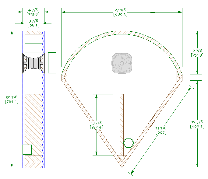

juggle2 said:One might hope the term "elegant" would suggest more universal appeal.
A term from my math days... nothing to do with visual appeal. But i did come up with one that was not your regular box -- the geometry is probably too extreme to work (which is why i held off posting it). The terminus would probably be best not as a tube, but built in as part of the box -- perhaps a development of the point. Flip it 180 degrees and you could hang them from the ceiling by the point.

planet10 said:a little creative paintwork, and no one would know its a speaker...
dave

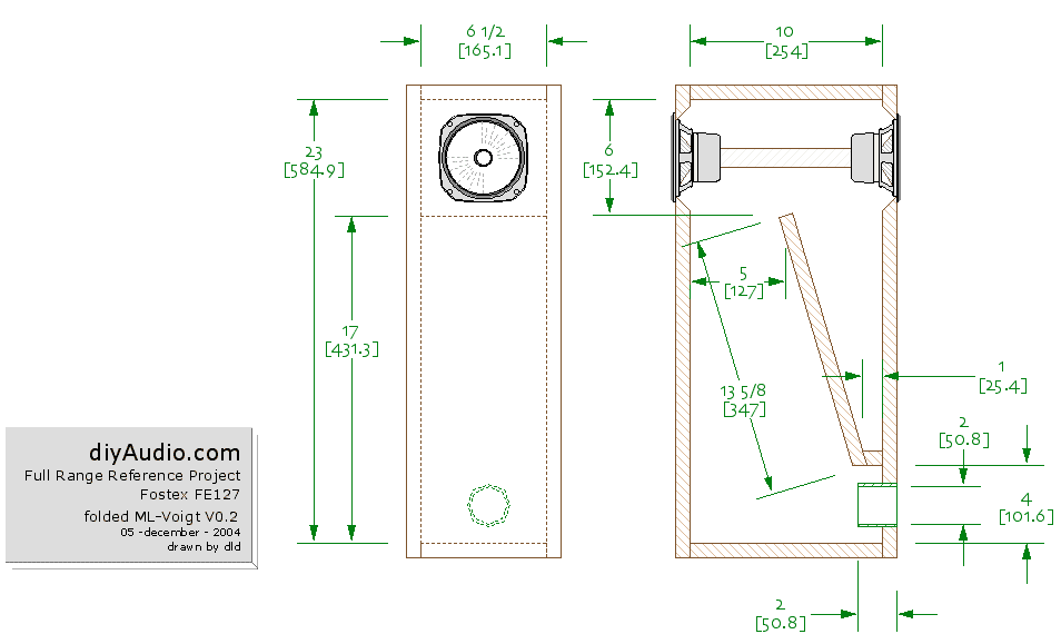

Timn8ter said:The curved top is interesting but...
The Flat-Top (tm) version:
internal reflectors are optional (2 possible drawn in green & magenta)
Port out the front, back, side, or bottom (as illustrated).
Next up the lated Tim suggestion. Supper 1st.
dave
Timn8ter said:Internal dims of 23"H x 6.5"W x 10"D. Drivers mounted on the narrow side 20" from the bottom (internal). Internal baffle when viewed from the wide side begins at 6" down 5" from the back, tapers to 1" from the back. A 2" x 2" port at the bottom on the back
Like this?
dave

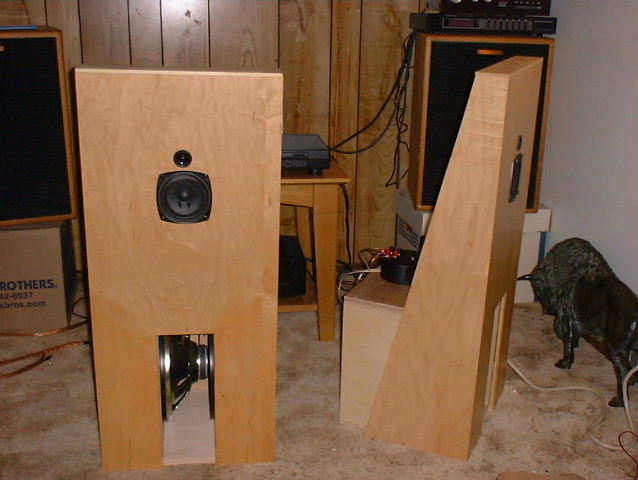

Morning boys:
I foolishly went to bed last night and missed all the fun. Somewhere back in the discussion things turned to a stand mount for the bipole. Any reason we could not do the bipole as a free stander tower. Some designs I have seen put a pseudo stand together with a short cabinet. It uses a down firing port and a slant front. This could easily be mounted on a solid base. The space behind the slant can be loaded with either lead shot or baked sand.
SCD said:Morning boys:
That was actually discussed earlier and is the reason for the down-firing ports in the drawings from Dave except for mine, however, it's easy enough to move the port to that position. Determining the output for the port in a psuedo-stand will be an interesting exercise. GM had described how to do that without turning it into a horn. I'll have to look around for that info. IIRC, he recommended having the port tube exit into a slot port. My bipole FE103E uses a slant front which interestingly enough sounds better when it's off the floor several inches.
