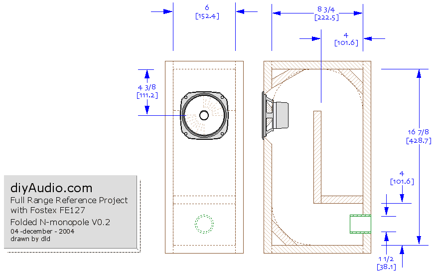

Timn8ter said:I was trying to figure out what the physical measurements of the line and CSA were. At first glance the line appears too long. Pretty darn close for gosh and golly though. Can that line be shortened up any? Something like L=32, CSA=24?
That design is as close as i could get to 30" long as i could get (by gollying) and has 24 in^2 CSA. If you want it 32" increase the height -- including the middle divider -- by an inch.

At L=32" and CSA at 24"^2 it looked pretty good.

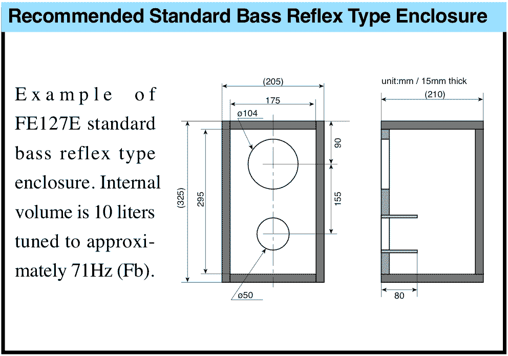

Fostex recommended enclosure
Not being a big fan of BR in general -- i have heard some that are OK -- i'd stay way-way away from the double bass reflex... and from the tuning on the BR i'd say we are already achieving a lower F3 (due to the support of the quarter wave resonance). All the BR gains you is some cabinet size savings (10 litre vrs about 14 litres)... the ML-TL is also inherently better braced (and if you routed off that top-front void would give you a little bit of un-rectangular flair to the box.

I could see the CSA but didn't know L. L=30" produces a slight bump in the upper bass which isn't a bad thing when contemplating baffle step. Could make calculating a BSC difficult or unneccessary.

Timn8ter said:I could see the CSA but didn't know L. L=30" produces a slight bump in the upper bass which isn't a bad thing when contemplating baffle step. Could make calculating a BSC difficult or unneccessary.
A bump also probably means a bit less desirable group delay thou...
Here is V0.2 which is an inch taller to make the line 2 " longer. The driver also moved up an inch to keep it in the middle. (keep in mind that tho deflectors are probably more important as braces than they are as reflectors, ie the woodwork challenged could leave them out to simplify things).
