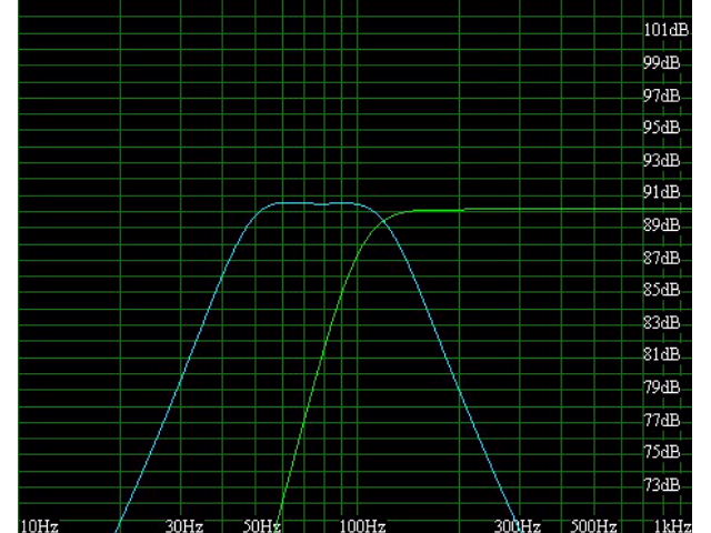

Below is a winISD screenshot of a 1197BR and a 8" Dayton 4thBP. If the Fostex could be integrated, it could be a solid bottom end w/o passives. Just a thought.

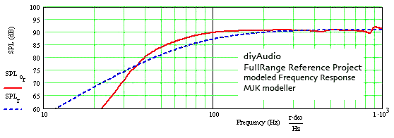

You should be saving those as gifs... i cleaned out the jpg noise, added a title and put it back.
60 Hz F3, 40 Hz F10... pretty amazing for a 127mm driver.
I'm thinkin' this could surprise a few people :^)
dave
Lucky for me you're not asking for a vector format. 😀
I've seen several surprised faces when the FE127E is demo'd. 😎

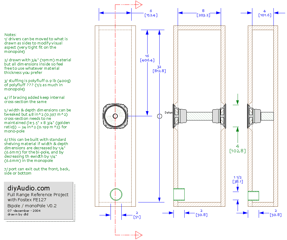

planet10 said:next... v0.2 of the bi-pole & mono-pole with provisions for building out of shelf material (see note 6)
extend sides or front & back (or both) by ~19" to get a free-standing box with driver at 36"
dave
Looks good. I imagine we could also do a version with the driver at say 25% from the top or something.
Another thing, can the bi-pole be folded?
Gio.
gmilitano said:I imagine we could also do a version with the driver at say 25% from the top or something.
The driver offset from the end of the line is used to kill the 1st undesirable line harmonic... its placement is critical....
An example of the folded one has been posted -- Post #95 (althou may need to adjusted for length -- still haven't dug out Denson's paper + we've increased line length from 30 to 32")

Hello dave:
I was studying the diagram from post 96. It may be an artifact of the sketch but it looks like the volume between the drivers is a little high. Could you check, I think the volume on the right side has been double counted.
I really like this presentation, I am thinking it would look similar to my current MLTL if I extend the sides. I checked with M last night and she likes the presentation as well. I may end up with a fleet of Fostex speakers. A bit of a stereo design showroom so to speak. All I need is a handmade tube amp or current source amp.
Hello dave:
Re: folded volume
96 is an alpha drawing of #98 which is more correctly as Tim envisioned it (he specified the dimensions -- i noted to myself that the partition is 6" from the top and 5 out from the sides). This design has the issue of the 2 drivers having different offsets from th ened of the line... this means that a model (with 2 driver equivalent firing out the top) is not necessarily going to as accurately portray things as a design where the 2 drivers have the same offset... it could work great thou.
dave
SCD said:I was studying the diagram from post 96. It may be an artifact of the sketch but it looks like the volume between the drivers is a little high. Could you check, I think the volume on the right side has been double counted.
dave
Re: Re: folded volume
That was my attempt to come up with a narrow front baffle. #95 is a more accurate fold but I wonder if it's possible to make a psuedo-stand that is less than the width of the cabinet.
