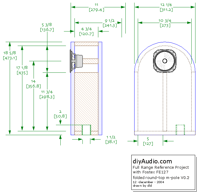

I finally got some time to play with v0.2 of the design and the MJK MathCAD software some more.
The mono-pole, bi-pole parallel and bi-pole series have essentially the same frequency response, with the exception that the parallel is about +6db in sensitivity.
I was supprised to see that the mono-pole and bi-pole series have the same response. I would have expected more bass out of the bi-pole. Is there any reason why this is the case?
For tube amps, I like the idea of an extra 6dB that you get with the parallel connection. However, I don't know if most tubes amps can handle the very low impedance (<3.5 ohm!)

I went through the design some more and read over the MJK two driver doccument. The actual reason may be that each driver in a bi-pole system has 1/2 the displacement of the driver in the mono-pole version.
In going through the mono-pole and bi-pole design, I discovered that the volume of port on the bi-pole is not double that of the mono-pole design.
The bi-pole port radius should be SQRT(2 * 0.75) = 1.225". I have attached a MJK mathCAD simmulation of the larger port.
I don't know if a 1.25" port can be attained, therefore, one may have to use two 0.75" ports. The two ports would work nicely out the bottom. A while back, Dave had a nice plan for the 40-1197.
Yes, that's the correct formula. Something strikes me odd about using a 2.5" port though. The modeling shows little difference other than slightly lower port velocity and slightly higher box tuning.
When Tim specified the bi-pole he gave a 2" port... for the monopole i divided the area in half, it came out to 1.4x something diameter so i just rounded it to 1.5" since that is a standrad size in NA... it may need to be a tad longer because of that approximation.
Until someone actually builds them, the port size is really just a close approximation.

planet10 said:speaking of monopole... here is the up-to-date round-top folded monopole....
dave
I think i may give these a go next weekend...got some time on my hand...now this is basically my first DIY home audio project. Sence it looks "cute" according the the boss....i got the approval..so with that...i had one question...would anyone have any recommendations on stuffing...as in how much and where exactly.
thank you
