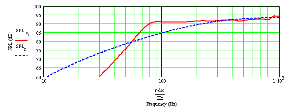

The rising response of the 126 probably makes it more suitable for a BLH. My usual reaction when I see that in a TL is to tune the cab higher which, in this case, brings the F3 to nearly 80Hz.
Graph courtesy of . Martin King's MathCAD worksheet .
Timn8ter said:brings the F3 to nearly 80Hz.
that's not all that bad... a loss of 10 Hz to gain 2 dB more efficiency -- maybe some other gains too?

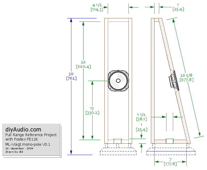

One of the reasons all the version numbers on the drawings are still WAY less than 1.
dave
I sort of understand the need to mechanically couple the drivers in a bipole but it´s the first time i saw a monopole speaker coupled to the back-wall. Or am I misinterpreting the drawings in"diya-frref-020.gif" ?
Dave, which program do you use for your drawings?
Still looking for something simple to make sketches with.
Nice project, BTW. (itches already)
joensd said:I sort of understand the need to mechanically couple the drivers in a bipole but it´s the first time i saw a monopole speaker coupled to the back-wall. Or am I misinterpreting the drawings in"diya-frref-020.gif" ?
In the absense of another driver to actively cancel newtonian motion, this scheme ties the driver better to the mass of the cabinet and minimizes it. A more elaborate scheme actually has a tightening mechanism so that you can dial in the amount of pressure on the driver.
VectorWorks. May not fit into your budget, but despite some serious horsepower & feature set, is very simple to use for these kinds of drawings.
Once i have the drawing done, i just get the size i want on the screen, use the OS X built-in screen snap and take the resulting pdf into PhotoShop to tweak it and save out as a gif file.
