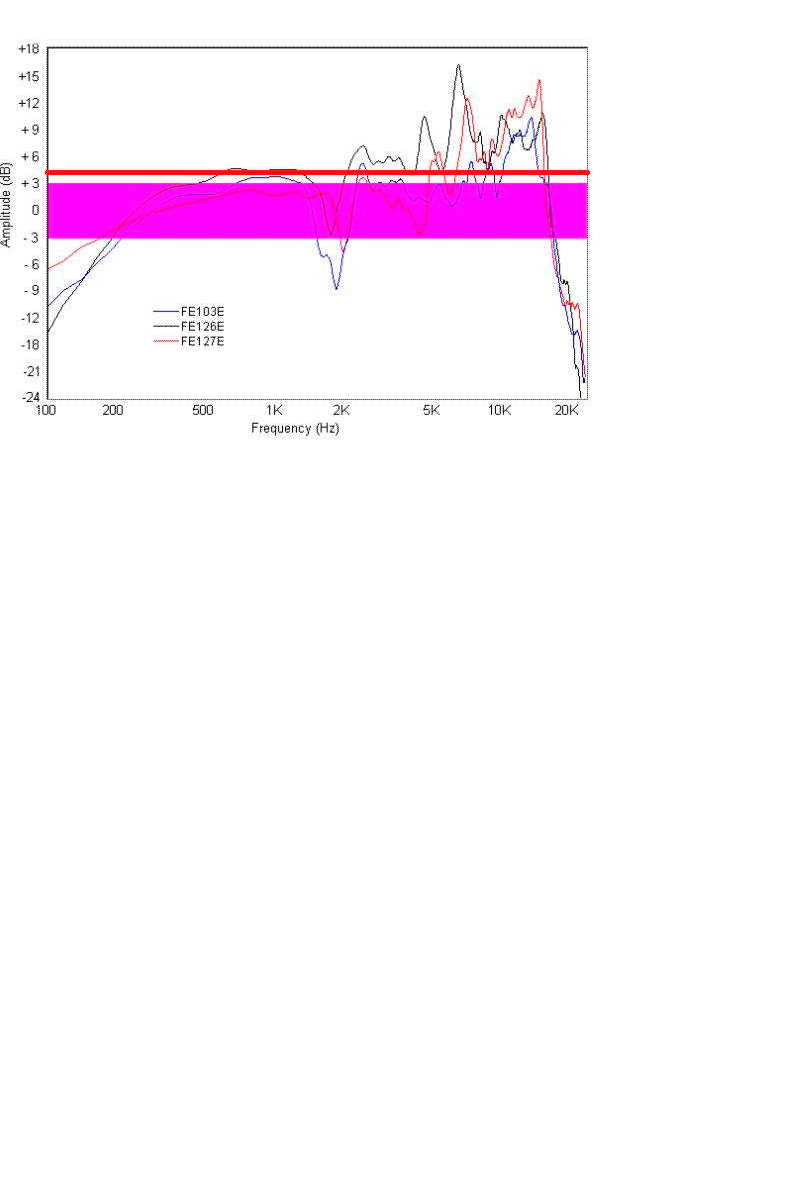

The curves are nice. I wish I had the skill set to understand them. Here are a few questions that come to mind:
Will the curves change once the drivers are broken in?
The low frequency role off seems quite high when compared to the published specs (fe127) is this a part answer to my first question?
The spikes and troughs seem to be consistent amongst all three drivers with the 126/127 curves being almost identical with a slight off set. Are there treatments that will help to smooth out the curves to improve the driver or are we trying to make a silk purse out of a sow's ear?
The work you did with the TB driver was very impressive do these drivers hold similar possibility?
Thanks again for your efforts. Lot to discuss here now.
You'll have to explain your conclusion. The black line is the 126 which, to my eyes, doesn't look as good as the other two.
Difficult to explain... but I try. 😉
If I watch to the second graphic I see that the black line has only peaks and nearly no gaps between 2 and 10 k. In the contrary the red line seems to be really more tormented in this area so I guess more difficult to tame...
But perhaps I am wrong :cannotbe:

That's a fair interpretation. My take on it is that the 127 is nearly +-3db to 5kHz before it goes beyond that. This is why I mentioned a filter centered around 7k (guess) might be all that's needed to clean it up well, IMHO. I appreciate Mark including the FE103E which is known to be a relatively smooth driver. Now we can see it.
MarkMcK said:
The Fostex three driver comparison graphs opened much too small. I am posting a second attachment that should be easier to read.
Mark - nice work!
I am disapointed that the published Fostex specs do not show the same magnitude at the peaks and dips nor a rising response on the 127.
Also, the efficiency is published as 89, 93 and 91 dB for the FE103, 126 and 127 respectively. I don't see that big of a difference in efficiency.
Mark, do you also have the capabilities of measuring the T/S parameters? It would be interesting to see how close they are to the published Fostex specs.

Now, about interpreting the graphs. Try to keep in mind that people often see data as they want to see it and not as it really is. Our tendencies before we see the data can influence our conclusions based upon any data set.
First, all far field, wide band anechoic or quasi-anechoic testing rolls off the low frequencies. This is a function of the size of the anechoic chamber, either the actual or the simulated chamber. It is this chamber size phenomenon that is the cause of the low frequency roll-off seen in the three driver comparison graphs. For the test done here, 200 to 300 Hz is the lowest valid frequency. You have to do one test to get the low frequency and a different test to get the everything else response of a driver. I will be posting low frequency response results at a later date.
Now, I have no vested interest in the FE103E, the FE126E, or the FE127E. When I evaluate the data in light of the criteria set up for this project, my choice is the FE126E. I have an argument for why I prefer the 126, but others may have other preferences. Anyway, here is my argument:
First, one of the conditions for this reference project was high sensitivity. The FE 126E has the highest sensitivity. You have to look at the lowest frequencies to compare sensitivity in a bandwidth region not dominated by cone vibration modes. As I have repeatedly stated, when the output of a driver may vary by as much as 20 db over the specified driver bandwidth, what does a one number sensitivity rating mean? Answer: very little.
Yet, at these lower frequencies the FE126E is more sensitive than either the FE103E or the FE127E. What may be surprising, but really isn’t when you compare motor strength, is that the FE103E is more sensitive than the FE127E.
Two, the goal should be fairly balanced octave-to-octave output. The FE126E is more balanced that the FE127E. Indeed, the vibration modes of the cones of the FE126E and the FE127E are almost identical. They may not look identical because the FE126E does not suffer from a dip in the response between 3 and 10 kHz that the FE127E does (and the cone vibration modes are shifted slightly lower in frequency for the FE126E in contrast to the FE127E). If you compensate for the lack of the dip in response, then the FE126E is almost identical to the FE127E. If you attempt to filter out the cone vibration modes, the dip in the FE127E’s response becomes important.
Any attempt at filtering is attempting to approach the ideal response level of the driver. As we pull down the peaks, if the filter response to vibration mode response is not a perfect complementary match, we will also pull down areas surrounding the peaks. With the FE127E’s response already down in this very busy vibration mode region, we will suppress the output even farther. This will impede our ability to achieve octave-to-octave balance.
So, in sum, let us assume that a plus or minus 3-db range is our goal. With the FE126E we would have more sensitivity and a greater chance of achieving a generally even octave-to-octave output within a plus or minus 3-db range.

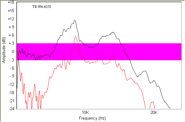

Last, the notch just shy of 2 kHz is not a measurement aberration. Remember how I described the test set-up. Tim also sent me another driver along with the FE127E. I simply swapped out the Fostex drivers and installed this other driver. All else in the test set up remained the same. This fourth driver does not show the dip in response seen in all the Fostex drivers.
Just for comparison sake, I attach the response graph of this fourth driver.
Good designing and good building,
Mark

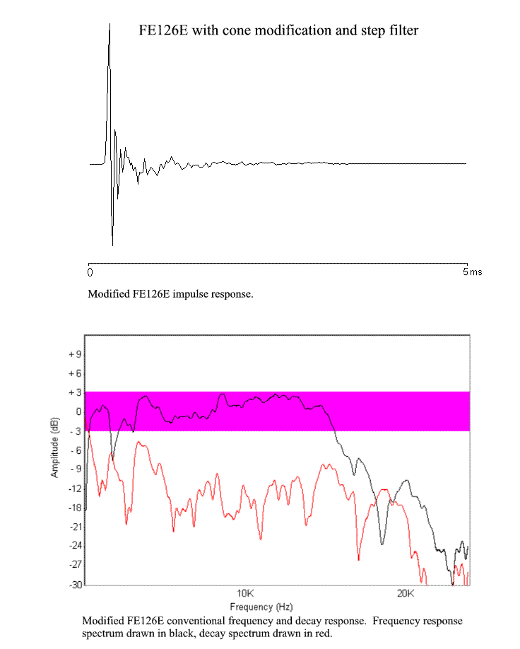

I am attaching test results of a first modification to the FE126E. A few points of explanation: Fostex’ banana paper cones are very noisy with vibration modes. They are much worse than polypropylene or the mag/AL alloy coned driver Tim just sent along.
Cone vibration modes may be independent, loosely coupled, or tightly coupled. Fortunately, several vibration modes in the FE126E cone are tightly coupled. That means that controlling one mode may take care of more than one. For the modification documented here, two regions of the cone are mechanically modified and a two-component step filter is used to control the rising frequency response. The critical regions where the mechanical modifications are made are 9 and 17 mm in from the outside edge of the cone.
With this modification, the driver almost qualifies as high fidelity. Except for the response dip just below 2 kHz, the driver does meet a plus or minus 3 db specification from 250 (the 250 is just the limit of the test and not the driver) to just under 16 kHz.
Good designing, good building, and may you experience true democracy,
Mark
