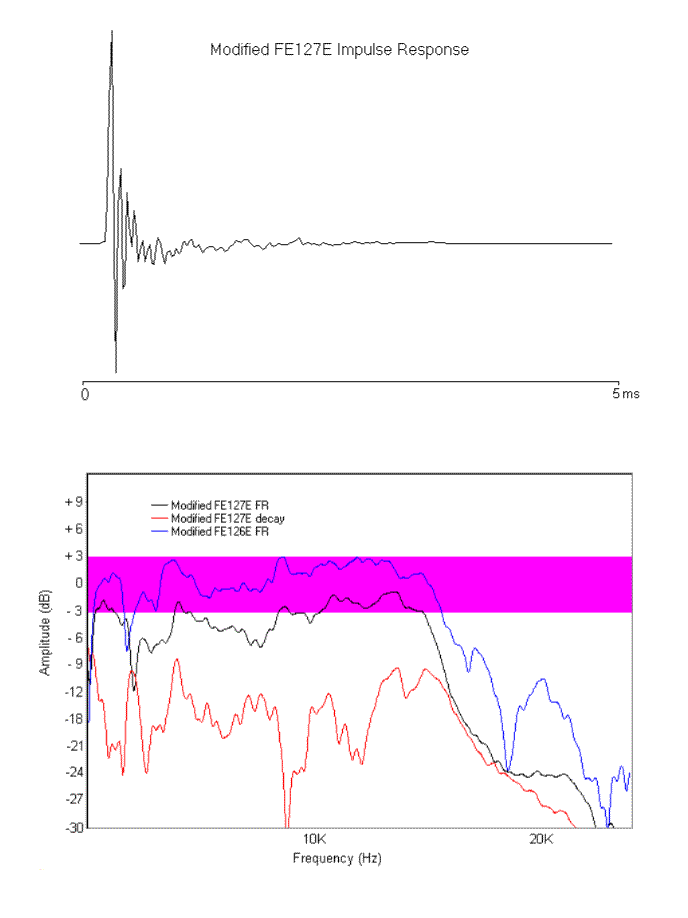

It is a good thing it was a cloudy, damp, and cool to cold day here. Otherwise I would probably not have ported the 126 mod to the 127.
Before I post the results I would like to say a few things about some ideas recently stated in this thread.
First, there is a problem with using a poor performing driver as a reference. To do so assumes that everyone hears the defects in the same way. There is considerable research to contradict this assumption. I remember an AES paper from as early as the 1970s about CBC's attempts to design a new monitor loudspeaker. They did considerable work on listening evaluations and evaluating the listeners. One interesting finding was that people rated loudspeakers differently depending upon the performance of the loudspeaker and the degree of listener's hearing loss. The poorer the performance of the loudspeaker and the greater the hearing loss the more likely to have wildly different evaluation ratings.
Two, I am not promoting the idea of driver modification for this project. I believe a better idea would be to reopen driver consideration. Despite testimonials of sound quality, I don't want to listen to loudspeakers based upon either the 126 or the 127 in stock condition; even for short periods of time.
Third, I am becoming somewhat leery of sharing the details of even the 126 modification because it ports so well to the 127 and because of the commerical project using the 127 referenced several times in this thread. Not my entent or desire to provide free design work for other's commercial endeavors. I do not know if this is the "risk" refered to earlier, but it is, then it was a valid concern.
Fourth, my modifications vary from driver to driver. Some are difficult, some are easy to implement. Each is designed for the particular driver. It depends upon the needs of the driver whether the modification is simple or difficult. While there have been two unsuccessful modifications posted to this forum, I have identified both of them as unsuccessful. For the successful modifications, the modification reduced unit to unit variability. In other words, you are likely to have more consistent results from the modified drivers than you are from randomly purchased stock drivers.
It is always possible to mess up any project, however, and the diyer would know better than anyone else what they are or are not capable of doing. Because of this, choosing a driver modification scheme for this project will eliminate some participants. That being said, I reiterate my earlier proposal to reopen driver selection. Let us see if we cannot come up with a driver that more people will hear as the same regardless of hearing loss and that does not need modification. Just a suggestion consistent with the design criteria set forth for this project.
Now, as to the FE127E modification. The cone modifications are the same as for the FE126E. The prefilter is different, much more agressive. Of particular interest is the sensitivity comparison of the 127 and the 126. As shown, the 127 is significantly less sensitive than the 126 and is comparable to a lot of other available drivers.
If you can drive the 127 to satisfactory listening levels then you can do it with other drivers generally considered too insensitive for use with low wattage amplifiers.

I am a little disapointed in where things have gone of late.
I understand your point but don't be disappointed, Mark's measurments have brought information, confirmations that wasn't available at the begining of the thread and that should be discussed IMHO, this is the reason of being of this forum and group working... 😉
OTOH I fully agree with you and I also see a danger of dilution of the interest.
Perhaps it's time to imagine the crossover which will be able to tame the FE127's peaks and gaps.

One major reason for selecting Fostex (brand not model) was global availability. Reasons for selecting the FE127E included ease of application, a wide FR, low cost and shielding. I can't think of another driver that meets this criteria as well as the FE127E. No, it's not perfect but that should be a given. I'm planning on building the bipole design posted earlier in this thread. I'm pretty busy but I'll attempt to get it done soon.
I still support the decision to use the FE127E driver. A little story first.
I had a friend in the Philippines build a TQWT for the FE127E following an invitation to put something in the DIY room at a hi-fi show in Manila. The reception was completely unexpected (although I liked the way it sounded). Suddenly I was being asked to produce retail versions to team up with a vendor's new tube amp that just happened to make a great combo. I contacted Martin King since I used his worksheet to come up with the cabinet dimensions and we have a standing agreement in place. (As a side note there have been several auditions but I have not sold a single unit yet. Things move very slow in the Philippines and I've only had a business registration for a couple of months.)
My design is single driver and uses a BSC and Zobel circuit. I have not now nor ever had any intention of adding modifications to the drivers. I happen to believe that many irksome qualities of raw Fostex drivers decrease over time. Besides, my Pinoy customers are very concerned about the appearance of their audio equipment. Modding the driver could detract from that. Hence, I'm happy to leave my design as is. End of that story.
My design is single driver and uses a BSC and Zobel circuit. I have not now nor ever had any intention of adding modifications to the drivers. I happen to believe that many irksome qualities of raw Fostex drivers decrease over time. [/B]
