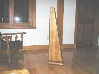

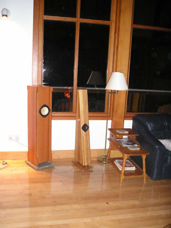

I just completed a 40-1197 tapered quarter wave bi-pole project. I put the driver on the slant face. I am so impressed with this presentation that I am going to make a similar one with the fe127.
Attached is a picture of my 40-1197 bi-pole, I must thank Tim for his help and design. I love them and they are getting better as they break in.
