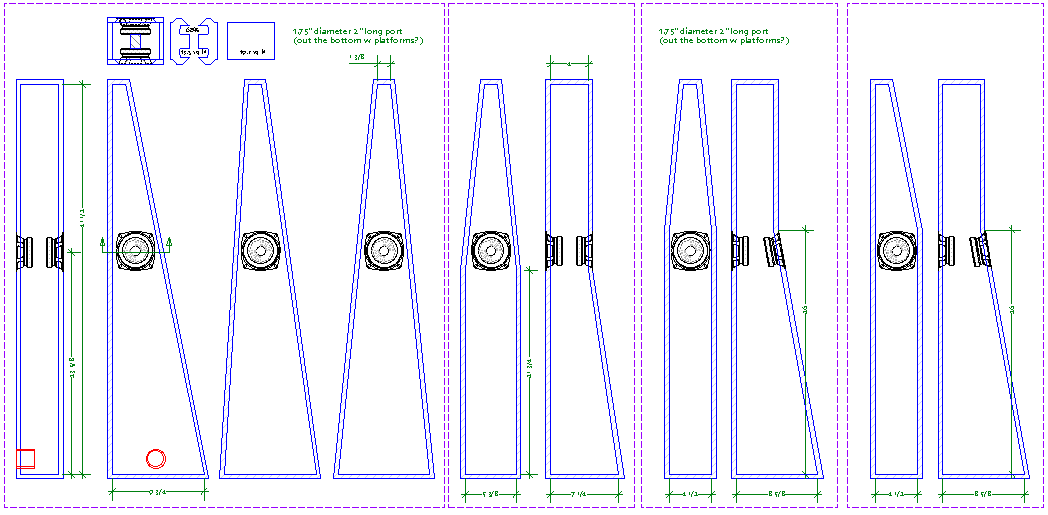

TQWT = TQWP = Voigt Pipe....
TQW = Tapered Quarter Wave
P = Pipe
T = Tube
A quarter-wave pipe that is small at the closed end & large at the terminus end... driver placed at 1/3 to 1/2 the distance from the closed end....
It has been found that these tend to work WAY better with a restricted terminus (ie ML = Mass Loaded)
Attached is a pic i had handy of variations on the theme (these are based on Tim's bipoler 1197 ML-Voigt).
dave

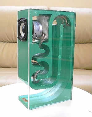

is it like this,if this works im putting up a pic.

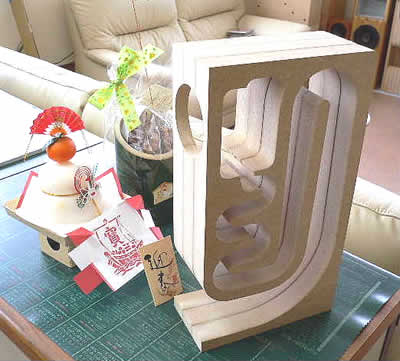

i found this kinda small speaker
it looks like a demo,you know,to show someone what somthing looks like,but not to scale? i wanted to know what you guys thought if this was a real speaker,and if it is,do you think it would work with FE127 or FE167??? them are the only two i have comming,so if not them two,then ill need another plan. i just think this one looks cool, and interesting. provided it would not sound like a toy.
let me know will ya,and thanx,
roy
