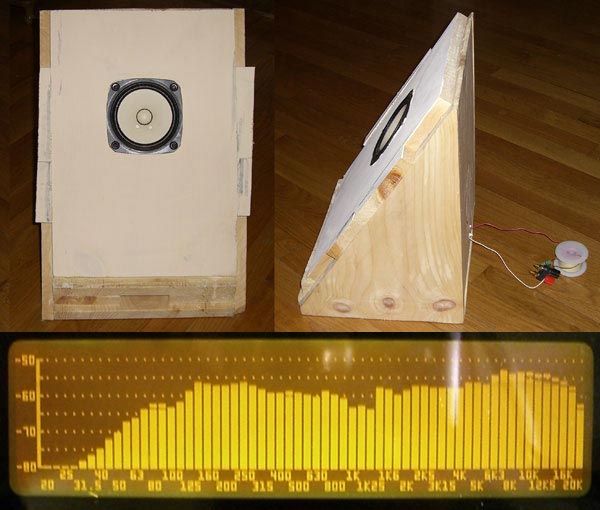

MisterTwister said:its approximately 13 liters, tuned to 50 hertz
Pretty close to Fonken tuning (but the Fonken purposely uses a port that pushes it towards aperiodic. What kind of port do you have?
dave
it's rectangular port in front, it's really hard to see on photo.
it's 3in x 0.75in and 3.75in deep.
top of cabinet is staffed with fiberfill (maybe i should add some more).
drivers' frames are covered with sculpting clay.
also bsc is added, which wasn't meant for this speaker, but fits quite nicely, at least to my taste.
it's 2.2mh inductor and 7ohm resistor.

just checked... Fonken is 13 liters tuned to 59 hz with a port with almost 6x the area of yours.

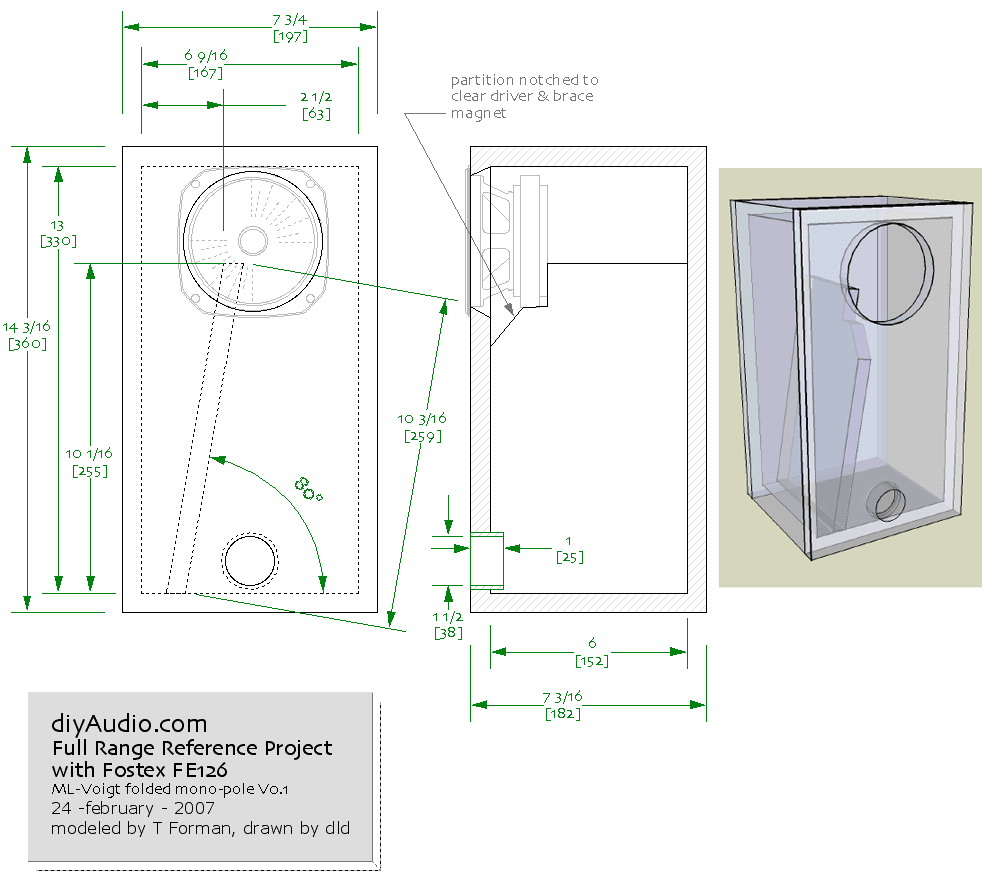

In post 527 Dave says the folded monopole design will not work for the 126. Why? I have a set of his modded 126s on the way and was looking at that box as a short term investment to have something to try them in until I can get to something better like the Frugel Horn. From my reading it seams like it will be due to bad bass but i' not sure if i'm right. If that is the only issue then maybe I can live with it for a few months. Could the design be changed in some way to work with the 126?
In post 373 Moray James posted about his 126 based karlson/TL box and I have searched high and low for drawings but can find nothing. Does anyone have plans for it? I like the look of that quite a bit. Thanks for any input.
The Qt of the FE126e means it is less than optimal for an ML-TL. Tim did post an ML-Voigt that looked decent
http://www.diyaudio.com/forums/showthread.php?postid=534730#post534730
This can easily be folded (& dimensions shuffled) if needed.
I don't think Moray published drawings for his FE126 design. He has for the 166/167 thou.
dave
dave
Folded would fit my desire to have it small. From looking at other drawings of folded pipes it looks like I would just take the pointy end of the enclosure and put it behind the lower part. I would then need to leave a gap across the top of the internal separation. Is this correct and do any drawings exist?
Does the port need to be on the bottom or what effect would moving the port to the front have?
I like that a lot thanks for the drawing. How tight should the driver contact the cutout in the brace?
dj_oatmeal said:How tight should the driver contact the cutout in the brace?
The magnet should press tightly against the brace. The part where the back of the cone is needs to be more open. It will look funny, but you could minimize that by rotating the driver so that the partition lines up with a basket leg.
dave
