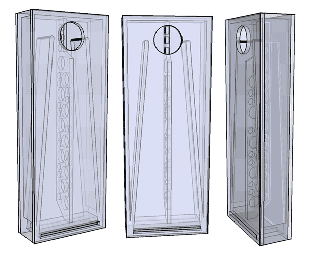

The rectangular shape behind the magnet to brace the drivers to the cabinet (monopoles) or each other in the case of bipoles.
It should be as tight a fit as you can make without warping the rather thin stamped metal frame. A slightly loose fit to the magnet with some duct seal or Blu-tack.
Take a look at the referenced sketch for a more detailed look at this bracing method.

RTF said:
Is there something significant about the rectangle behind the driver? is that a physical part of the design or just a visual reference of some sort?
As drawn it was intended to be a circular dowl between the magnets (or the magnet & the back in the case of the monopole. In practise this turned out to be clumsy. More work, but also more effective id a rectangular holey brace with tight fitting magnet cutout(s).
I have started revisiting these designs and as my penchant of late, any excuse to do a sketchup visualization so eventually more up to date drawings will appear. for now i will attach a visualization of Mileva (for the FE127) that illustrates a full length holey brace,
dave
