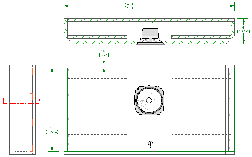

Keep in mind that the squish & stretch on these last 3 will have unknown affects on the performance.
dave
Those are Scott Dunn's (scd) variation on the Bi-Fonken. His latest comment "I got my Bifonkens hooked and playing. They are really nice. The treated drivers make a huge difference."
I've started to call them flat-face Fonkens & will probably draw the variation as they remove the step where you have to run the box thru the table-saw to get the 45 on the front.
In theory, there will be a negative affect on the edge diffraction, but if it is the difference between buidling or not building a Fonken i can live with it.
The only change is to ensure that the ports are adjusted to maintain the same length

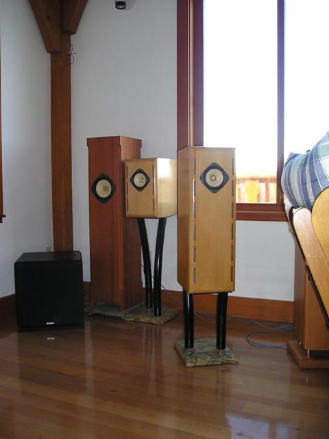

Did someone ask about my bi-fonkens. I did some modification to Daves drawings to come up with a presentation style I liked more than the sliced edge style.
I kept the critical stuff the same as Davids design but I used a 1 inch round over and adjusted the internal port length to compensate. I essentially doubled the single fonken design. Mine are made from solid fine grained Douglas-fir.
I am not sure if there is a problem with defraction due to the round over edge vs the cut off edge as these are bi-poles. There may be something there that some may get fussy about I just like the look, and they sound good to me.
The stands are custom made from polished granite and aluminium tubing (both fun materials to work with). Stand height is to ensure the drivers are at ~ 36 inches from the floor, cause that is where my ear is when I am sitting on the coach (just before I fall asleep). I have a small commercial sub that I use to augment below 80 cycles. I keep the sub turned dow low so it does not over power things. I am real happy with these and my wife likes the look, so all is good right now.
The only issue I have is that I have too many sets of speakers in the living room and the furniture is getting in the way.
I will take my camera home this weekend and get a few in the living room shots. It looks like a cold rainy weekend here so I will be gooving to some sweet blues this weekend.
Nuff said for now
I hope this helps
Pics of my bifonkens
Okay here is picture in the living room. All dressed up singing gently. I purchased a nice little SE EL84 when I was in China and hooked it up last night. My what a great combination. I have been listening to some vinyl from the old days and really enjoying things a lot.

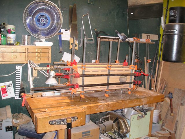

Here is a shot of the glue up. Lots of clamps. Got to move fairly quickly that glue dries fast. I usually wet down the joints first to help slow things down a bit. Things are a little tense from when the lid comes off the glue till when the lid comes off the beer. It is definitly worth though.
