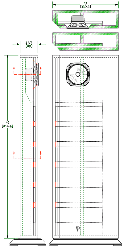

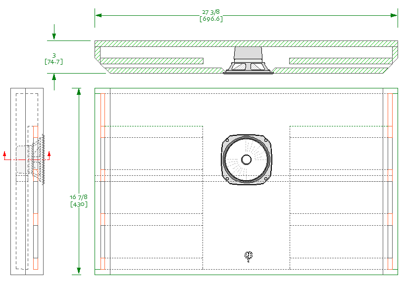

The BiFonken plans are in the Box Plan Library, and the alternative shaped Fonkens are in a thread on the Full Range Forum... i'll dig them out and post them & then i guess i should get the Fonken parts of this thread split off into their own thread.
dave
loninappleton said:Where in this long thread are the drawings and measures
for the long Fonken?

I'm familiar with the full range driver forum but did
not see or recall plans in the 'gallery' they have.
So anything you can repost would be good. No rush.
I'm trying to complete a BIB to see how that works.
dave
