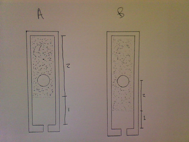

Hi
I am just completing my MT-TL monopoles (finally) with FE127E.
See: http://www.diyaudio.com/forums/showthread.php?postid=528564#post528564
I am going to line them with felt as per thread instructions.
I am not quite sure about the stuffing though. I have two packs of Monacor MDM2 300g/m2, but I am not sure how much to put in the cabinets. Each pack contains two 630mmx330mmx35mm sheets.
Also, I have read that only two thirds (2/3) of the transmission line should be filled. Is this 2/3 of the whole cabinet (A), or the whole of the top half and 2/3 of the bottom (B)? This is my primary question. I think that I am there with the stuffing density, I am going to use a pack in each initially.
Please see photo for clarification. The photo shows a cross section of the cabinet. My port is built into the base.
