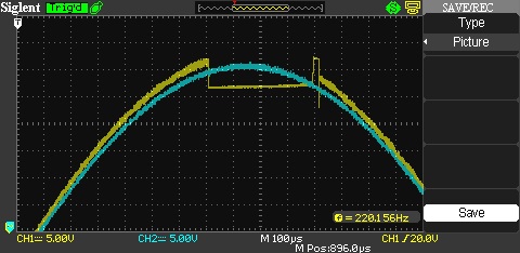

Here is how it looks on the scope. Max volume, no load. Rails are +/-67V
Yellow is right channel at 62.4V peak, green is left channel at 61.4V peak.

Hi reedcat,
Bias will not affect this. Your gain is different between channels assuming the amplifier is working properly.
Look carefully at the values of the feedback resistors. I always use close tolerance metal film types for this with the smallest tempco I can find.
-Chris
Hi Andrew,
They can if the amps "sticks" during clipping, then you get odd recovery waveforms as the feedback loop closes again. Don't forget that during clipping, the feedback goes open and no longer represents what the output stage is doing.
-Chris

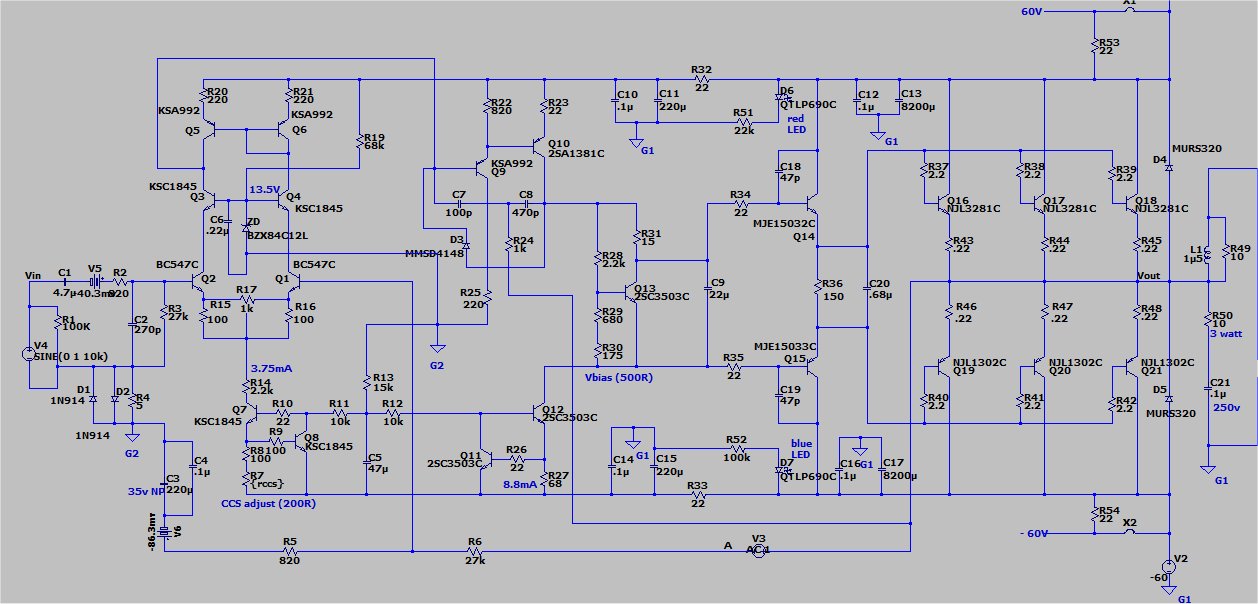

I assume these are feedback resistors going into input stage that I should be looking at, right? R6/R3 each 33k at the schematic.
Also, earlier comments mention adding baker clamp diode to prevent sticking at clipping. Are these the pair of D4/D5 connecting output and power supply rails?

The anti-sticking diode is across Q7/8.
It has to be rated for full rail to rail voltage. In your case that will be 2*67Vdc +10% for mains voltage variations.
Just found ostripper's comment on baker clamp diode. It goes between the output side of C8 (where C8 meets R31 and R28) and the Base of Q9 (where C7 meets Q9's base). It is marked D3 on this schematic (attached).

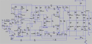

diyAB Amp - The "Honey Badger"
I am not sure if my PCB has it. Does anyone know where I can find the latest schematic for the board on sale? My BOM lists D8/D9 but I don't see them on the schematic listed on the DIY store front or in the schematic included in build guide.
Edit1: I found the latest schematic. It is that little image at the store front. The best way to look at it is right click and save it as an image file. Baker clam is marked at D10. My BOM doesn't have it so I probably don't have it in the PCB which explains the strange shape of the clipped sine wave
Edit2: I found the spot where the diode should be on my PCB. It is marked as "D-BC (option)". The spot is empty. I didn't fill it since the build guide doesn't mention it and the BOM doesn't have it.
