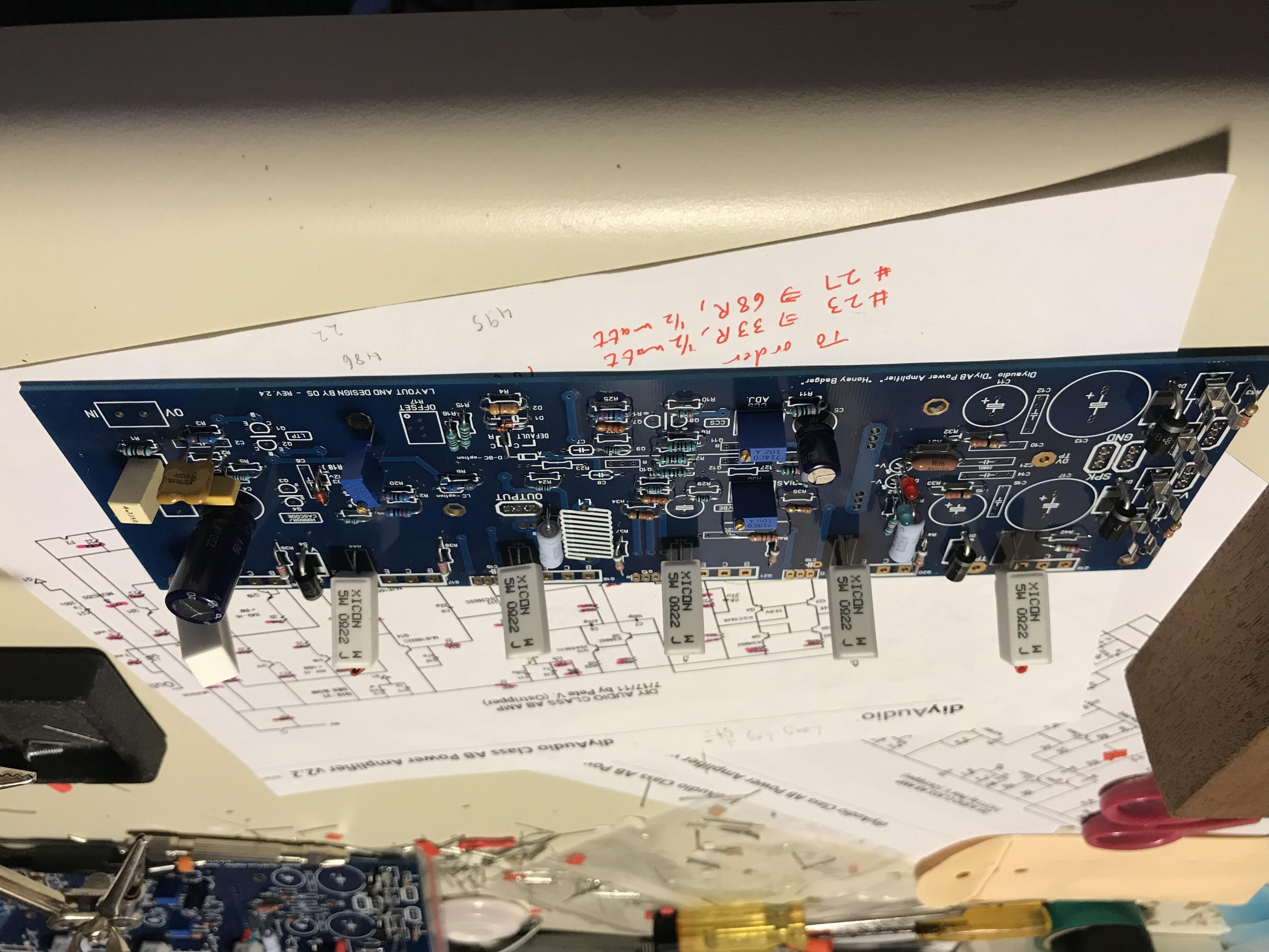

a 3pin inline VR can be inserted in either direction.Does the orientation of r17 variable resistor matter. Center leg stays in the center outer legs reversed. Can r23 and r27 be 1/4 watt?
As a variable resistor, it still operates the same. But the direction of rotation of the adjuster will either increase, or decrease the resistance.
You need to decide what effect you want when you turn in one particular direction and insert the VR to achieve that.
My preference is for the effect to increase when I turn in a clockwise direction.
eg. when I want to increase the output bias voltage, I want the resistance to decrease. I look at the PCB traces and find which two leads are shorted and find which orientation gives a decrease in resistance for a clockwise rotation.
That way I get an increase in output bias with clockwise rotation. But, That is a personal preference.
I know from looking at many Member designed layouts that most Members here don't care and some boards even have different rotation on the same PCB !!!
Looking closely at the build guide and the schematic, r23 and r27 seem to carry just under 9mA at their rated resistance. Power is I*I*R so only milliwatts across those resistors. Verified by a search in the build thread where the designer ostripper confirmed it (26 July 2013, post 384))
In fact ostripper's comment at the time was that most resistors can be 0.125W with no issues.
