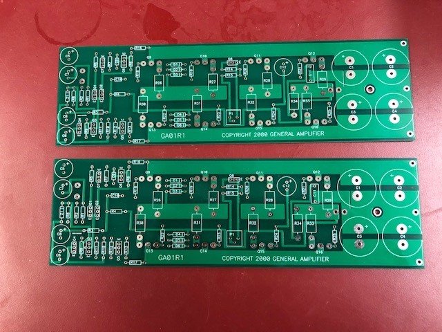

Woo Hoo finished my build of my badger boards last night i used MPSA18 from Mouser central semi tin leads for LTP. I cannot say enough good about these transistors they measured almost 700 hfe across all 20 pieces i bought was able to get 7 matched pairs FROM 20 PIECES my dc offset was nothing on both boards barely had to move trim to get to 0 and rock solid no jumping around i used my hp DC supply with current limiting set to 2 amps at 50vdc both boards dialed in fast using the 5U aluminum heatsinks i turned bias up to 40mA and they did not get warm definitely enough heatsink for 4281 and 4302 i used the updated BOM and its a winner i will finish dc protect power supply and soft start module and post some pics this build is very straight forward i had no mis haps the yageo resistors on BOM worked great they are a tight fit but that is the way to get best connect least resistance just clean boards up with 91 percent IPA put a new tip in your iron and enjoy the Build
