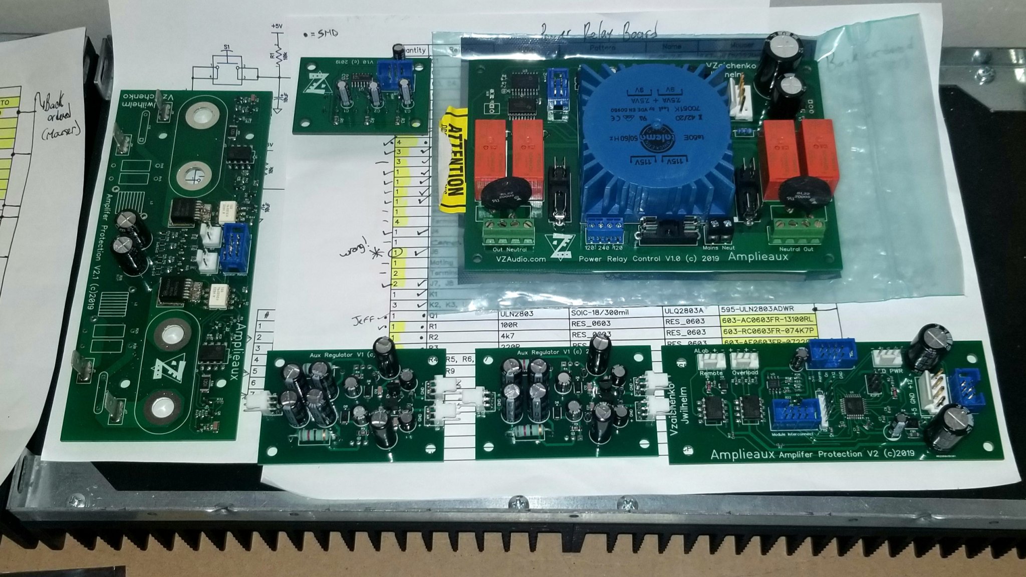

This is the way it sits on the bench today... It was my first time using SMD, and it was just awesome..."I've got a very soon to be completed version 2.4 Badger on my bench, with a VZDA protection system, and OLED Screen with Touch function."
Can you tell us more about this?😉
There are two daughter boards missing from the pictures, which mount to thermal sensors. The two Badger boards are ~75% assembled. I'm using a custom wound 800VA, dual 45V output, torodial XFMR, from Primrose (SumR audio) here in Canada.
I am building my Badger with the triple MJL4XXX outputs. I originally purchased the SS9014 LTP, but have since decided to avoid this, as there have been stability problems. Now I'm matching some MPSA18 (which are proven reliable) , and will hopefully find a few good pairs to use.
I work away (3 weeks away, 3 weeks home) so my progress is on hold for a few weeks starting today.

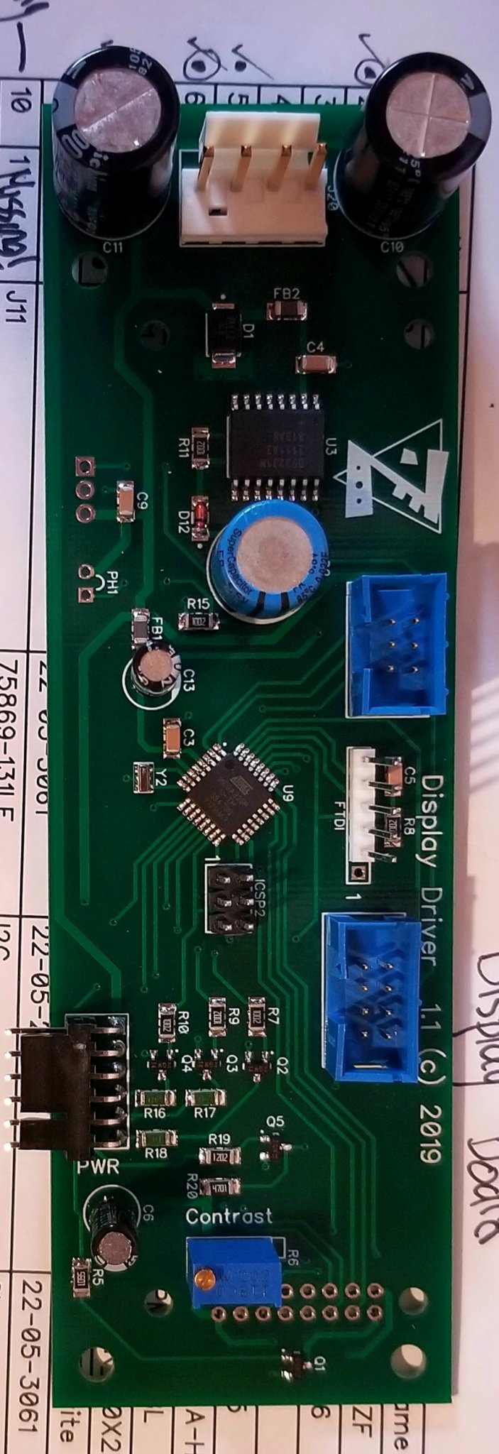

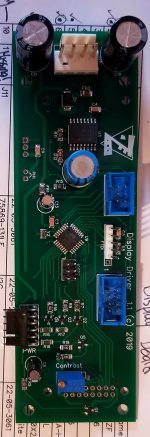

Is this amplifier protection compatible with OLED Screen with Touch function?This is the way it sits on the bench today... It was my first time using SMD, and it was just awesome...
The short answer is Yes.
The long answer is that the touch function is provided by a capacitive touch button that will mount under the OLED display, and along with the OLED, will fit neatly into the front panel under a piece of lexan/glass. The control board will be programmed to provide color selection, etc.
The front panel is getting cnc milled to allow these parts to fit properly together under the glass panel. From the user perspective, it will be "one screen".
The amplifier protection is actually separate from the display and can operate on it's own. The display board monitors temperature and has an RTC on it. If temperature goes out of range it sends a simple binary signal to the protection board to shut down. The protection board sends a simple hex code to the display board stating the state of operation. This is all part of the datalogging system Valery and I started on many years ago.Is this amplifier protection compatible with OLED Screen with Touch function?
This is the display system I was putting together for my Simpelstark amps before work got in the way. It uses a 2x20 alphanumeric display. If I ever manage to get some free time I want to redesign the display board with ESP32 and use WIFI for clock functions. In a preamp it could be used for remote control which is another project half done and waiting for time to compl
Thanks Jeff!The amplifier protection is actually separate from the display and can operate on it's own. The display board monitors temperature and has an RTC on it. If temperature goes out of range it sends a simple binary signal to the protection board to shut down. The protection board sends a simple hex code to the display board stating the state of operation. This is all part of the datalogging system Valery and I started on many years ago.
This is the display system I was putting together for my Simpelstark amps before work got in the way. It uses a 2x20 alphanumeric display. If I ever manage to get some free time I want to redesign the display board with ESP32 and use WIFI for clock functions. In a preamp it could be used for remote control which is another project half done and waiting for time to complete.
From what i understood this (lcd unit)is compatible with the newest version of speaker protection.
What about the touch pad function that helitim said?
We set it up to use a touch switch with a RGB LED that sticks to the back of the front glass
I ended up with an OLED alphanumeric display instead of LCD or regular LED because I wanted to do Green letters on Black background. The OLED was the only available option for this preference at that time, and looks really nice(in my option).
