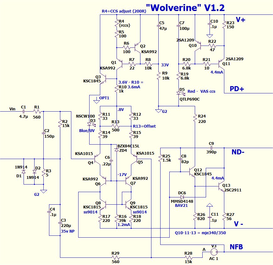

Curious about this as well. I have slowly (yes very slowly) been planning on building a poweramp. First i was thinking of building a Leach amp, but then i came across the honey badger which looked very interesting en easier to get parts. But i see now the wolverine is kind of the improved honey badger.So now that Wolverine is out, is there any particular reason to consider building the Honey Badger instead of the Wolverine?
What should i go for? Honey badger is far more documented and discussed on this forum, but improved version also sounds very interesting.
The wolverine amplifier is far superior, but a more costly and complex build.So now that Wolverine is out, is there any particular reason to consider building the Honey Badger instead of the Wolverine?

The Wolverine is far better documented than the Honey badger.Curious about this as well. I have slowly (yes very slowly) been planning on building a poweramp. First i was thinking of building a Leach amp, but then i came across the honey badger which looked very interesting en easier to get parts. But i see now the wolverine is kind of the improved honey badger.
Documentation includes.
1. a comprehensive Bill of materials.
a. Sheet 1 contains the Wolverine Project BOM (IPS board and EF3-X boards)
b. Sheet 2 contains help with output transistor, power supply & fuse selection depending on your speaker load requirements.
2. The Full Wolverine Project Schematic.
a. There is a colour 57 V and 64 V version of the schematic which show the DC
operating voltage and currents of the Wolverine circuit
Recommended rail voltages are from 35 to 50 VAC.
3. The detailed Build Guide.
a. A 42 page document to help builder of all levels.
The Build thread is also actively updated by the wolverine development team.
Last but not least, how they sound. I built first the Honey Badger, then a year later the Wolverine. I have to say that despite the HB is a good sounding amp, the Wolverine is fairly a step beyond that. For all the aspects. Power, control, sound stage, detail. I highly recommend it, too. All you have to add is buying more components and do more soldering. Required skills are almost the same.

That would be a complicated and controversial job, Wolverine can look back on a long history. Ostripper posted Wolverine V1.2 on 2014-02-26 in message #599 of the Slewmaster - CFA vs. VFA "Rumble" thread, it was intended as IPS for the Slewmaster OPS.
