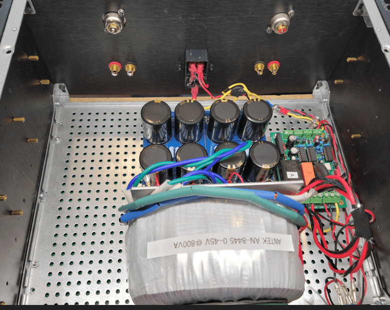

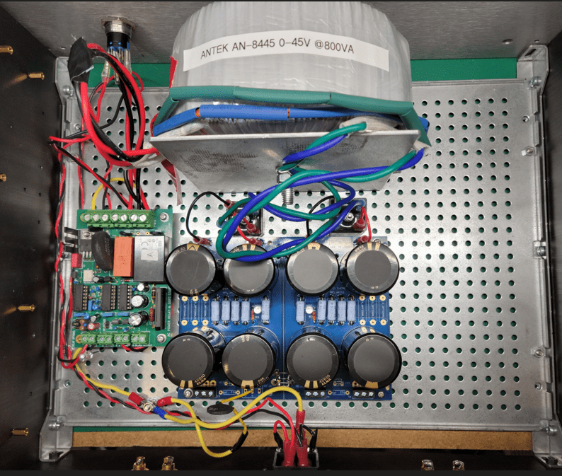

Hi all,
I've been studying this forum for several months. Started ordering parts, sticking to the BOM.
I've received the Antek AS 8445 0-45V @800VA transformer.
I've built FW clone amps, so have some experience.
My question: this transformer has 4 addtional wires running from it. I know what to do with the red & black, and green and blue, but not what to do with the brown & brown 18V or orange & orange 12V.
If I don't use them do I just tape them up?
As always, thanks for the assistance.
I'm looking forward to slowly assembling this amp.

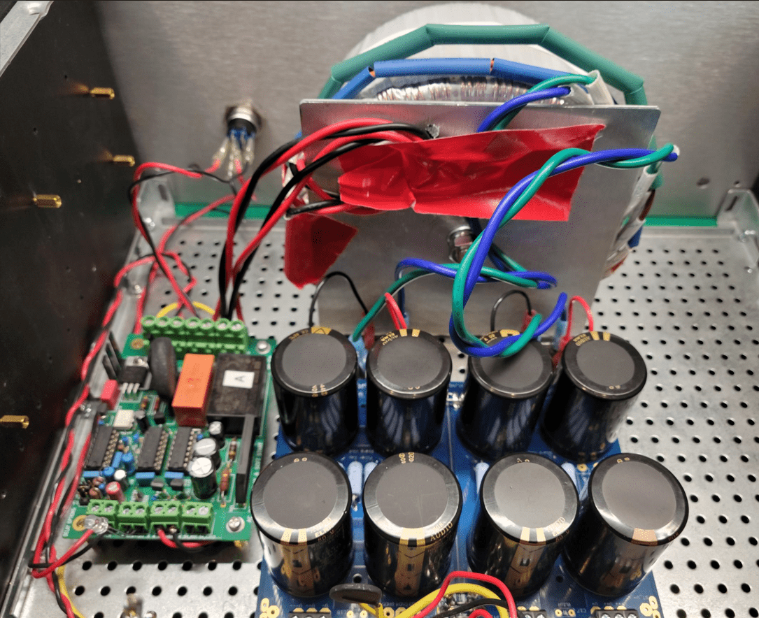

Joined 2005
I've assembled my PSU and wiring, including a Mark Johnson Low voltage on/off circuit that I have used in all my builds. Can't recommend it enough.
The Antek transformers I've used in the FW amps all had a ground wire. The Antek AN-8445 does not.
I'm using the same grounding scheme as before:
I'm using a SL-22 inrush limiter to the ground point.
I will trim excess transformer wires later in the build.
I haven't turned this on yet. Anything I'm missing in the grounding for the PSU?

I used the steel cge from a nad 955 that i had laying around its transformer almost identical size it shields the field around transformer that can show up as hum in your speakers they sell bands that wrap around torroid and shield it as well i think i saw it listed on anteks website in accessories that should help minimize that issue using cordless drill and a vise to twist wires for input and output also helps to shield from this routing wires away from amp board instead of crossing over them by utili all of these things helps to make it a quiet Amplifier well at least till you crank up the volume on your favorite music
