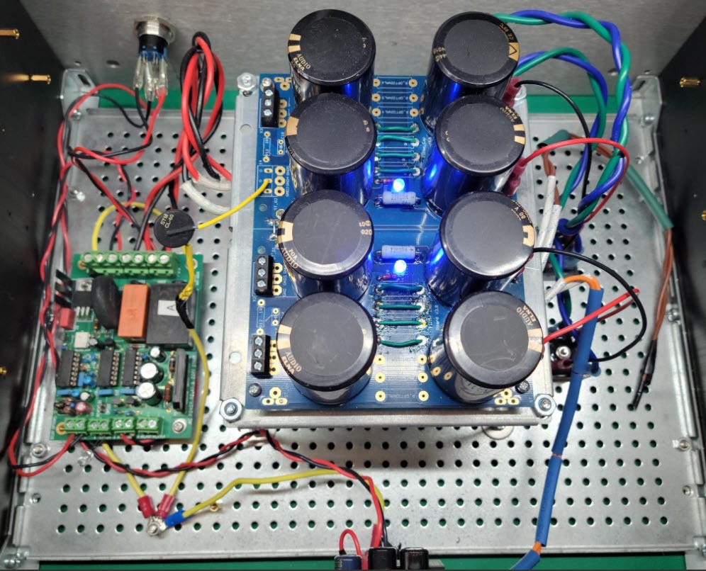

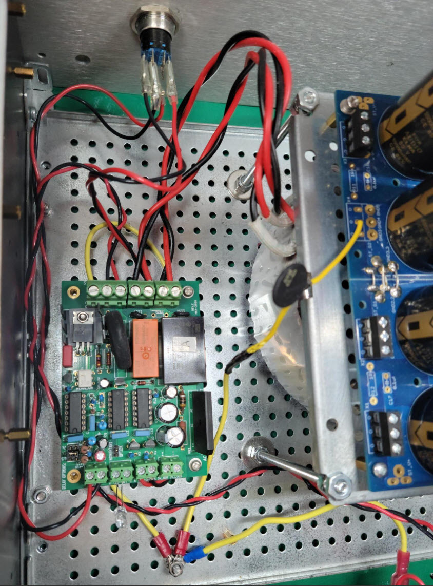

Ok, I'm back. I took a detour into the DC blocker world. Now I've built one and installed it. I was hoping that using the 12V leads would eliminate my hum.
No luck.

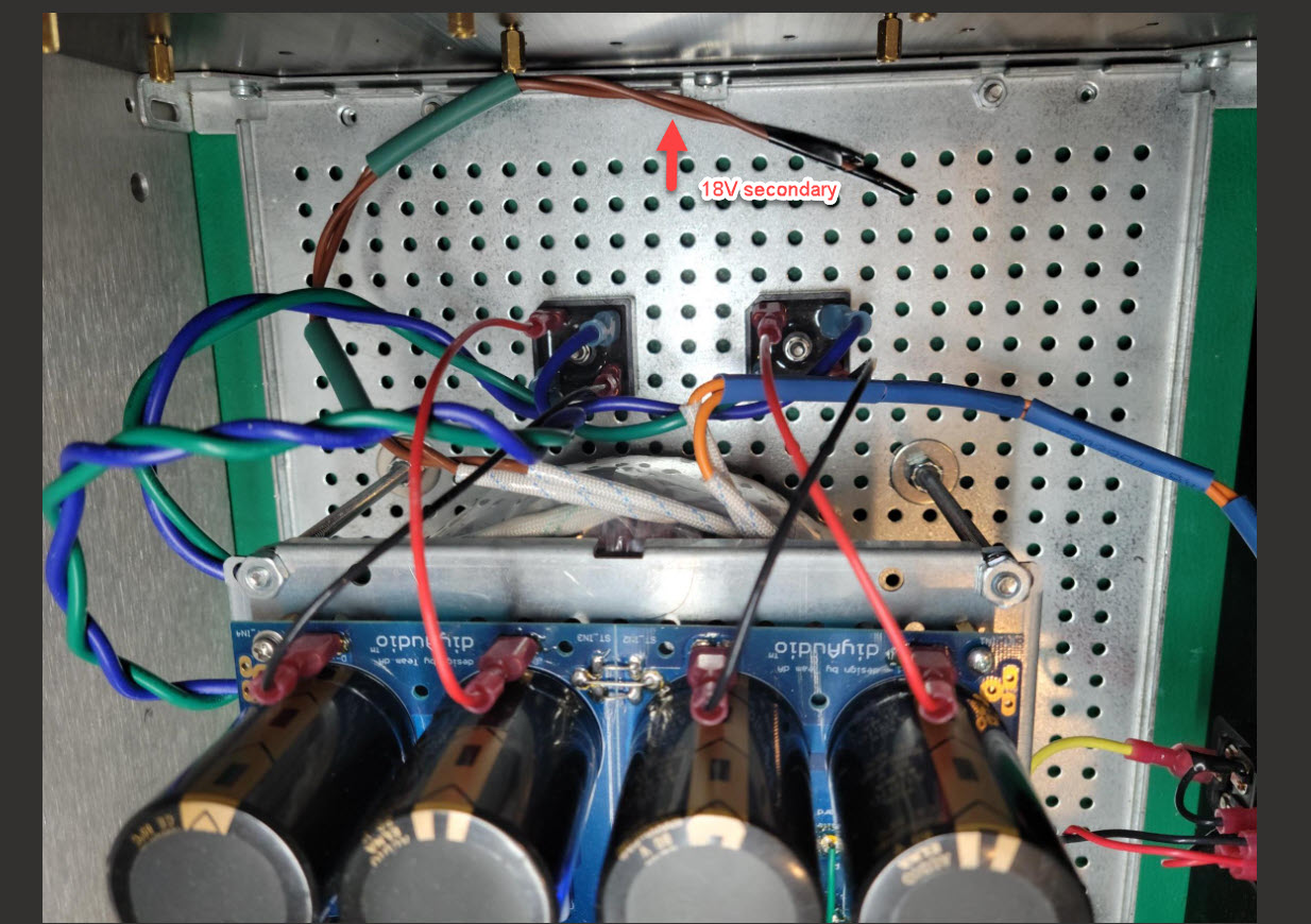

First question I'd appreciate input on is: what do I do with the 18V leads off my AN-8445 - 800VA 45V Transformer? See photo. If there some way that it is causing my hum? Oh, that it would be that easy.
I've built 4 F series amps without any hum issues. I guess it's my turn at bat.
Otherwise, I'm really open to suggestions.

Just tie the 18V wires off and insulate the ends. They won't be causing hum.
What sort of hum are you hearing? low hum or load buzz? Does it go away if you short the inputs? One or both channels?

Yes, that is my set up. I've used this in four F series amps with no issues. What am I missing or what is different in this amp? Note, I only have the PSU up and running, no amp boards installed.I assume your transformer is mounted under the supplies. Do you have a bolt through the metal plate through the center of the transformer? If so that will act like a shorted winding in your transformer and will buzz pretty badly.

The bolt through the middle of the transformer isn't a problem. The problem arises if the metal plate you have mounted above it contacts the bolt going through the transformer or the large washer on top. This would create a high current low resistance shorted winding for the transformer.
My question was if the bolt went through the metal plate your supplies are mounted on.
I realize with some chagrin that in my excitement I have interrupted the current conversation. My sincere apologies. I will follow the conversation quietly and learn.
UncleMud, we welcome all input here. Thanks for helping me get to the issue. I have checked and don't think the bolt is touching my plate. Just to be sure, I put a rubber mat in between. And still have a low hum coming from somewhere in the transformer/PSU board. That is all I have wired up at this point. No amp boards. Haven't even built them. I wanted to resolve this hum before going ahead.
