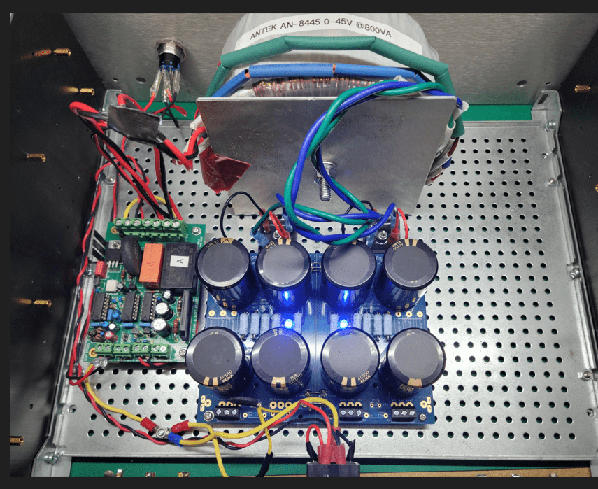

I powered up my PSU for the first time with the Antek AN-8445 0-45V @800VA and I'm getting 61.82 DCV +/-. So that's good.
But for the first time after 4+ FW builds, I've encountered a hum. Noticeable at turn on and sustained. Clearly my grounding isn't working.
I'm using the same grounding system I've used in the past.
Appreciate any thoughts as I continue to mine through this forum.
Can't tell from the angle of the picture but is the bolt holding the transformer touching the front panel?

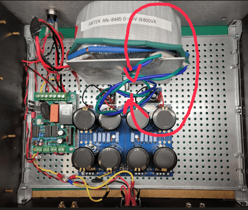

Your wiring doesn't look optimal.
Please review the attached documents.
You should not have wires wrapped around your transformer. I would rotate the transformer to a optimal position and run the wires as per the attached document.
Its also ok to cut them shorter to achieve this. They should also definitely be twisted tightly. Make sure you don't have a shorted turn on your transformer. This means that the mounting bolt is touching the chassis on both sides of the transformer. You may need to insulate one side.
There's also a few tweaks that you should preform. Did you use my updated schematic?
I've attached it below.
Check that you are using the correct values and component part numbers for R19 and D3.
Also if you're getting hiss on start up you may want to put 100R base resistors on the cascode q3, q4.
You can check out my build here
Honey badger build
Good luck 🤞

Stuartmp,
Thanks for the info. I will review the docs. I did a quick tour of your site - wow! I will return there often.
I wrapped the 18V and 12V leads around the transformer. Since I won't use them can I cut them off short and make sure the ends are well insulated?
I my raise the PSU over the transformer to get it into a horizontal position as I did on several FW amps. I should have though of that in the first place.

Yeah, the plate over the trafo touches the metal base plate of the amplifier and it forms a closed loop with the metal bolt. It could bring the trafo to overheat.
