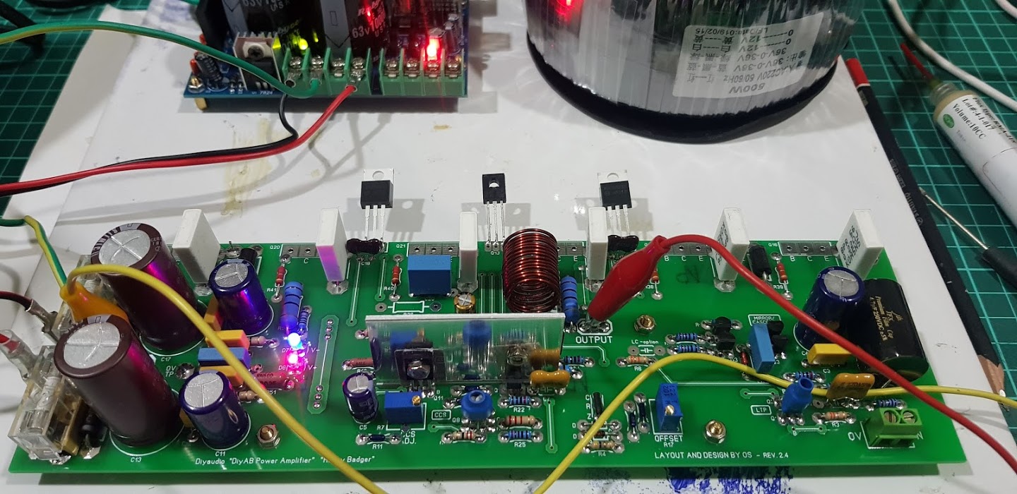

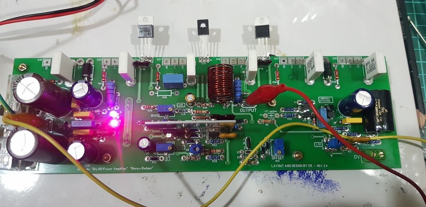

Bias not setting up correctly
Hi all,
I have almost completed building one channel of the honey badger amp. This is what I have done.
1. All components have been installed except the 6 power transistors (Q16 - Q21)

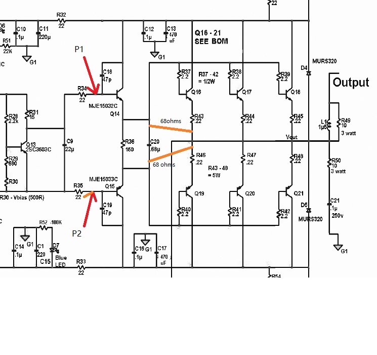

2. I've installed 2 x 68 ohm resistor across R40, R37 to output trace hooked to L1. This was recommended by Pete for the purpose of testing and setting the bias correctly.
3. R30 is set to 550 ohms using a 1k trimmer.
4. R17 is set to centre (500 ohm) of 1k trimmer.
5. R7 is set to around 75ohms using a 200ohm trimmer
Problems in bias adjustment. Reading obtain from Digital Multimeter in DC mV.
a. TP1 and TP2 is giving me around 1mV, no matter how many rounds of R30 (15 turns). No matter I try clockwise or anticlockwise, the voltage stays around 0.8mv to 1mv. Why is this happening? The guide says I must be getting around 20mV - 25mV.
b. When I tested the speaker output using the multimeter in DC mV, the reading keeps changing between 0.7mv to 2.2v. It does not stay still.. it goes up and down and up and down. Is this normal?
This is how my board has been build for 1 channel. The 2x68 ohm resistor was soldered below the board as described in point 2. above.

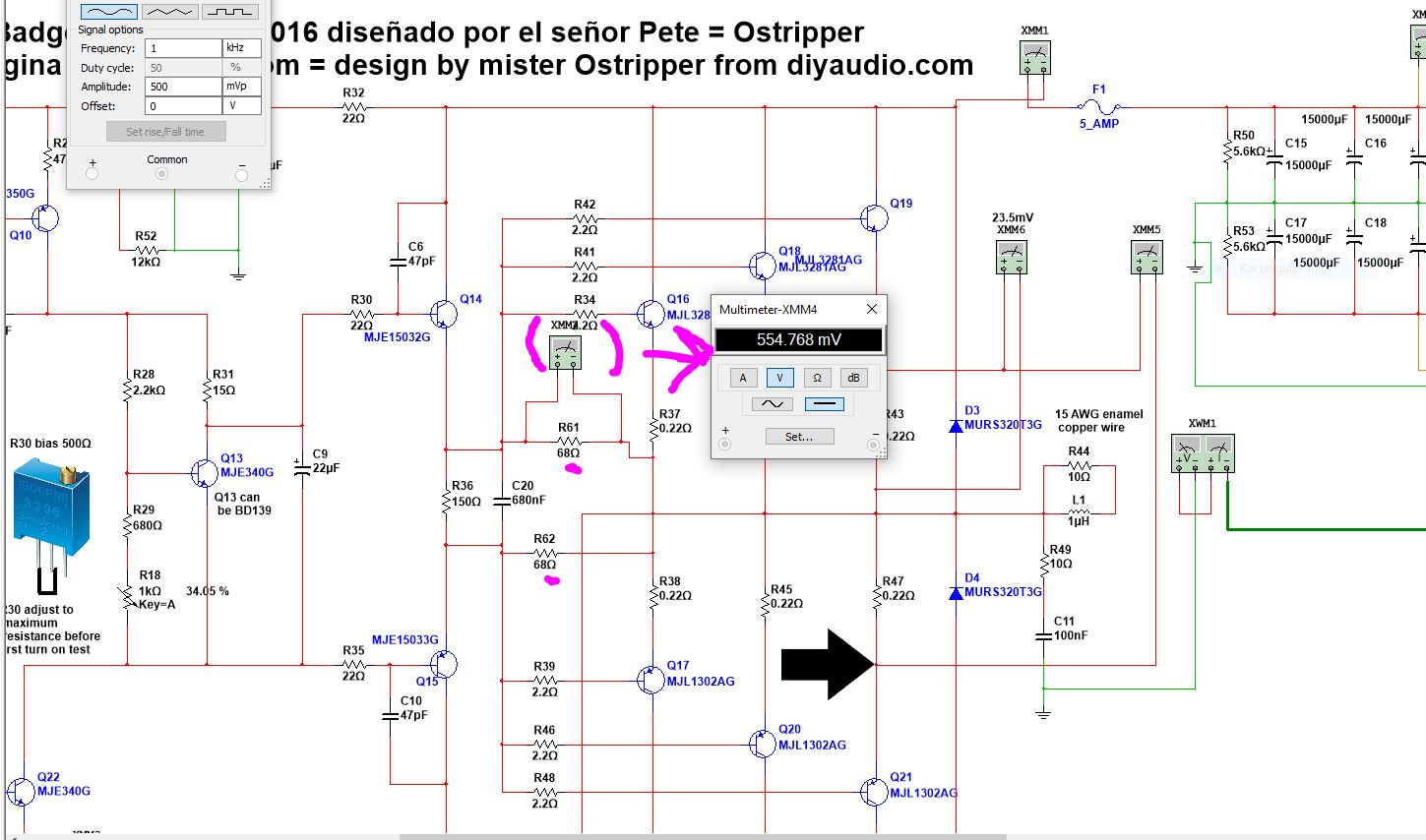

on the text OS recomeded to use two 68 ohms resistor in place ot read +/- 0.55V across them so later then place all power transistor and do the final bias adjustment sort lile to inisiate the adjustment making sure is not over biased
As mentioned you will not be able to adjust the bias until the output transistors have been installed. Using the 68R resistors instead of R36 is bypassing the output section.
The 68R resistors should be connected between the emitter of Q14 or better one side of R36 "electrically the same" and the output trace and do the same thing for Q15, tie a 68R resistor to the other side of R36 to the output trace. If this has been done correctly your dc offset should adjust to less than a millivolt. "mine was anyway" Did you match the input transistors hfe? Even if you didn't it would never go to 2 volts.
I also made sure to install Q13, Q14, and Q15 on the heatsink when I did this test, I'm not sure it's necessary but I'm a worrier.
Check both CCS voltages after you power it up also. Nothing is smoking so that's a good sign.
If these things all check good you need to recheck all your components and make sure you didn't mess up one of them. One wrong capacitor value drove me crazy for a week.
Good luck.

Thanks all for your help.. At least it gives me more confident.. I don't want to blow any of the power transistors as they are not cheap. I'll reply to your feedback one by one. TQ
1. akimmet: Thanks.. gosh.. so I still have to install the power transistors. 🙄
2.vargasmongo3435: Juan, thanks a lot for your help. Yes, I was referencing to OS's text. I see.. so I have to measure the voltage across the 68 ohms resistors for 0.55v. Got it.. I will try later.
What I did actually was measure from R34 (P1) and R35 (P2) against ground (see circuit attached). I got a +/- 0.9v DC reading on my DMM.... is this normal?
3. nanchangbob: Bob, thanks a lot. You are right.. after installing the 2x68 ohm resistor.. when I measure TP1 and TP2 against ground (without power transistors installed), I got roughly around 1mV-2mV. How much I adjusted R30, the voltage will not go up to 25mV as recommended.

Thanks Juan, I managed to get 550mV across both 68ohm resistors. When that happens, the resistance of R30 was around 244.8ohms.
