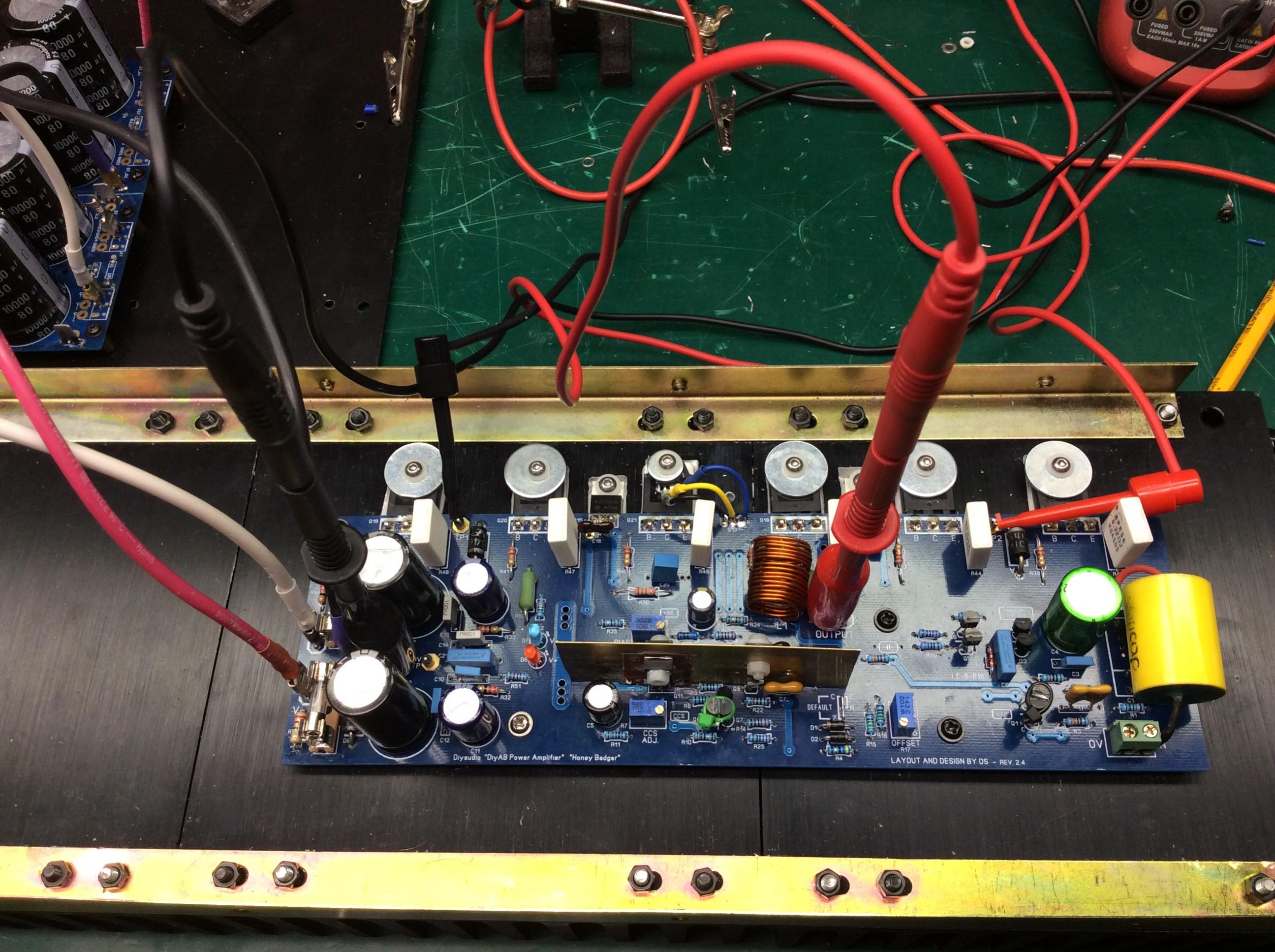

having issue with bias over 20mv
I run the amp and both the small ccs and large ccs are good as well as the DC offset.
The amp bias will go to about 20mv without any issues and is stable but when I go over 20mv the bias will hit a point and just run and my bulb starts to glow and I need to turn the bias down. I thought because my heatsinks were too large that the Vbe transistor Q13 may not be able to sense properly so I mounted it directly on Q21 as is shown in the photo but it made no difference. I'm sure I must be doing something wrong but I'm not sure what it is?
Both boards respond the same and I'm confused🙁 I ordered the 3m 5549s thermal pads to try to help with heat transfer to the sinks and I also attached the datasheet for it.
I've only made it through about half this thread so If it talks about this issue please excuse me and I'm only part way through Mr. Self's power amplifier book and I have read about the output stage yet.
I appreciate any help or thoughts you can share.

😕 Thanks for the reply Jan but going across a single resistor instead of the TP's just gives me half the mv reading as it is .22r instead of .45r, I also am not using a load and the input is shorted.
I read about problems with oscillations with the MPSA18's so I switched my LTP to SS9014's and that didn't make any difference. I've looked through the board and I do not see any incorrect value parts, I was pretty careful.
The thing is it has correct ccs voltages and they are stable also the dc offset is good, it only goes off when with bias starts to run, one channel runs at about 20mv and the other one runs off at about 14mv, up to that point it seems perfectly normal. I would really like to set the bias to at least the 50ma which is recommended which I believe would be around 22mv across the tp's?
This is my first large solid state amp and things went well until now.
Does anyone have any suggestions I might check or try? I'm truly perplexed.
Thanks,
Bob
Are your power transistors, driver and bias transistor genuine? Is there a good thermal connection between each transistor and the heatsink? Is there a good thermal connection between bias transistor and the heatsink/power transistors? Have you matched power transistors?
I had such a problem once and power transistors were to blame.
cheers,
All the parts are from digikey so I assume they are the real deal, I have tried the expensive 3m pads and the normal pink silicone pads and it makes no difference I also made sure they are secured well to the heat sink.
I only matched hfe on the input LTP, cascode and current mirror transistors I can't fit the outputs in my dmm. I was considering picking-up a peak atlas IT, I just didn't see anyone having an issue like this with this build and thought the outputs would be alright.
I also had the same worry about heat transfer as the heatsinks I am using are really large and I can't tell if there heating up because there is no real temperature change. I even took the time to drill and tap some smaller heat sinks just to make sure and everything behaved the same.
It certainly seems like the outputs are going into run away at a fairly low bias point and the fact it acts perfectly normal until I try to push them a little higher has me scratching my head.
I do not know Peak atlas IT. I know one that it's designed to test cables so there must be some other Peak Atlas. DMM will not help you much with power transistors as these have to be tested at higher currents. I use DY294.
Thermal runaway is also possible when there are large parameter (Vbe and gain) discrepancies between transistors but if transistors came from the same batch it's less likely. If you have a few leftover transistors you might check their gain and Vbe. You can read here about matching: Matching Power and Driver Transistors
If all your transistors are OK (which is not necessarily the case) then there must be something wrong somewhere else. Did you measure each resistor and capacitor before mounting? There are no miracles, it's either some faulty component or a mounting error.
When your bias starts to grow does the zoebel resistor get warm?
It also could be board flaw - the least likely but some hairlike invisible connection or invisible broken track can be very difficult to spot but bring nasty consequences.
good luck,
I actually have a DY294 transistor tester I bought when I lived in China but it died. Anyway, I went ahead and bought the Peak Atlas tester and it will arrive tomorrow.
PEAK Atlas Atlas IT (DCA Pro) ADVANCED SEMICONDUCTOR ANALYZER with Curve Tracing: Amazon.com: Industrial & Scientific
I checked the capacitors and even matched resistors for this build, as I mentioned I was very careful.
Today I removed the outputs and installed the 68r resistors and removed R36 as Pete suggested and it worked as it should, I even passed a 1khz signal through it and it had a nice clean signal out.
I actually had another order from mouser which I ordered some items and I ordered one set of outputs in case something went wrong. I will check them with the Peak atlas and compare them to the outputs I removed that I received from Digikey.
I have ordered from Digikey a number of times through the years and I never received anything defective from them, but these outputs work just fine until I try to push them, I really don't know what else it could be. I'll let you know what I find out.
This is one of the nightmares we pray not to encounter. Nevertheless, there is something wrong with some components as the design is fine.
What about emitter resistors? Are they non-inductive? Standard metalised emitter resistors and large variation in power transistor parameters may cause oscillation when driven harder. With mosfets I use non-inductive gate resistors but with bjts it's going overboard.
Thanks for the link. Interesting model. I have older dca 55 (not so many functions) but I see that both use too small current for testing and matching power transistors. You can build a test circuit as shown in Elliot's article. It won't fail (resistors are easily replaceable) and it allows for large enough current testing. I would say that still number one suspect would be at least one of the power transistors failing at higher currents if all the other are fine.
Please let us know as it might happen to anyone. So far no one had this kind of a problem with Honey Badger.
good luck,
PS there was such a problem with some Diamond amp builds (there is a thread somewhere here) and the problem was VAS oscillation, which could be solved by using certain components and some mods but in HB VAS design is fine.
PS 2 Do you have one HB board not yet populated? Populating it and testing each stage could provide some clues.
PS 3 a comment made by one of the Atlas dca 75 pro users. Might apply to your case.
3. When testing a house numbered transistor I used an old reliable go/no go transistor tester with a amplification indicator lamp. In one instance for example; I could get a particular house numbered transistor to only function at a narrow window of current setting. Others with the same exact house numbers would amplify over a board range of current since I can vary it, in this case it might be safe to assume this is how these unknown transistors should amplify is at the broader range of current, at least with these anyway. Anyway, the DCA 75 doesn't say that the transistor is marginal or weak, when I think it likely is?
