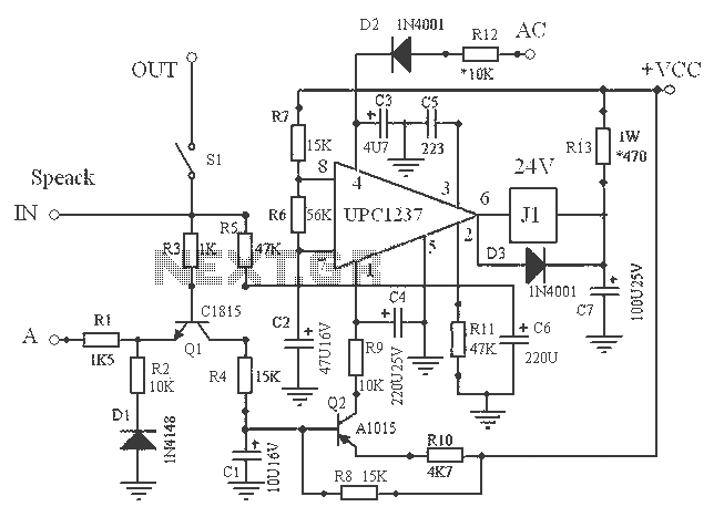

That looks like a variant of the output current limiter I posted. Something like this is used on some "Leach type" symmetrical designs for the VAS , as well. (NO ,Kay) On the Badger , altering VAS impedance is the concern. The TMC would be affected. A EF2 or EF3 output stage will not load the VAS dangerously. With the Badger, it is the beta enhanced follower that has internal saturation , not a external overload. The diode or (not clipping) takes care of that. Using this diode (vas) limiter and 3rd party DC/current protection is the usual "audiophile way". 😀 My H/K integrated amp uses the badger topology in this way - plus a upc1237 protection IC. Watch out , most Ebay/Chinese upc1237 solutions DO NOT include the overcurrent function ... (only delay + DC). Only a few add the extra couple transistors/diodes to pin 1 of the 1237. There will be an extra connector with pnp or npn designations (like below "A") - cheap !! 5-10 usd . RESEARCH the purchase.Current limiter for HB may look like the one in the attachment

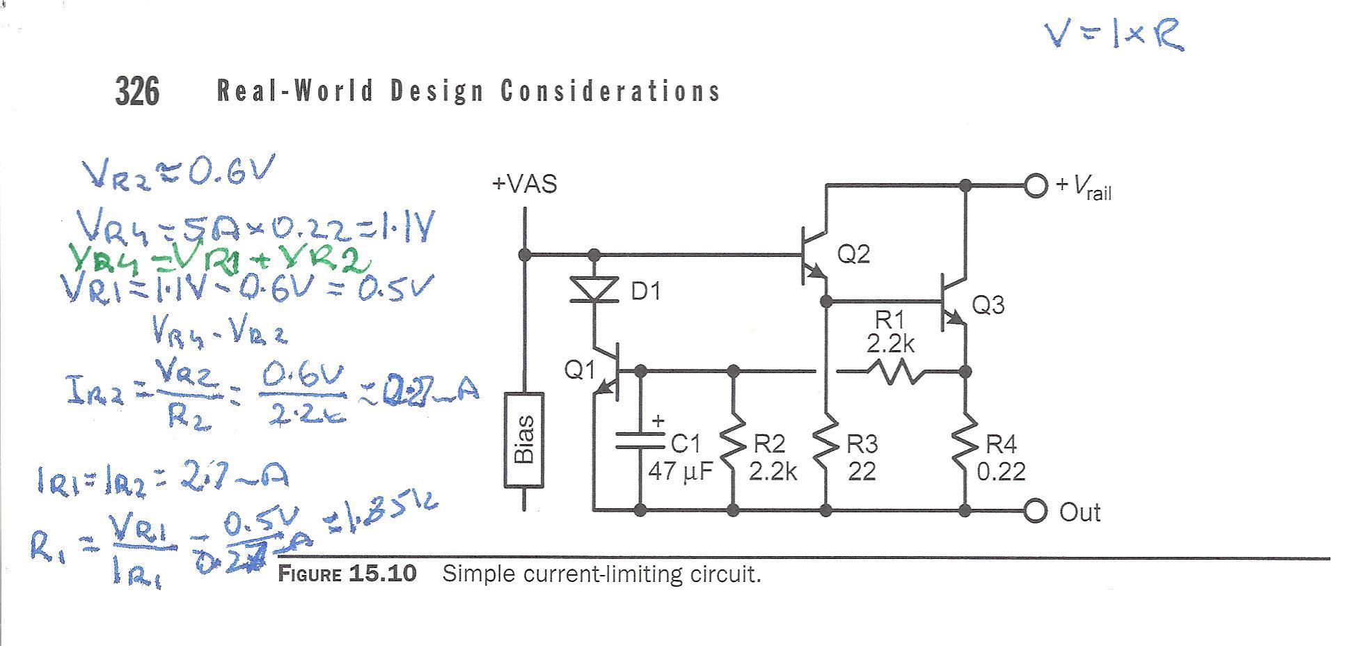

Thi is my job .. I am glad to see somebody refering to it ... but remind it was current limit in my set-up for a quite small speaker ( scan- speak 8 inch driver )
The amp is able to do a lot more ..
So it was your design. I copied it from one of the HB threads but do not remember which one. I gave it as an example. One can easily recalculate resistor values to suit ones needs. I did my calcs for SS9014/15 transistors and 12A and 15A load.
Ostripper,
What is J1 in your circuit?
cheers,
Ostripper,
cheers,
The relay coil. See the back EMF diode in parallel with it. As far as the in circuit current clamp protection. Back EMF of a big woofer can affect it , it might ?? add a few PPM to the mix. On my Slewmaster , Re's have euro connects to be monitored by external protection circuits. Low Rdson MOSFET's then disconnect the short. Edit - same as a output fuse . Not audiophile , "wire with gain" has no fuse. It seems the current clamp is a cheap warranty "reducer" reserved for lower end consumer products.

So it was your design. I copied it from one of the HB threads but do not remember which one. I gave it as an example. ...
Do not forget tu use a pair of capacitors to prevent oscillation.
They should be betwen base of protection transistor ( T1 & T2 ) and V out
prevent oscillation
Yes, of course. In old times I used a circuit like the one in Cordel's book.
ostripper,
So J1 is 24V relay's coil and S1 is the relay switch - am I right?

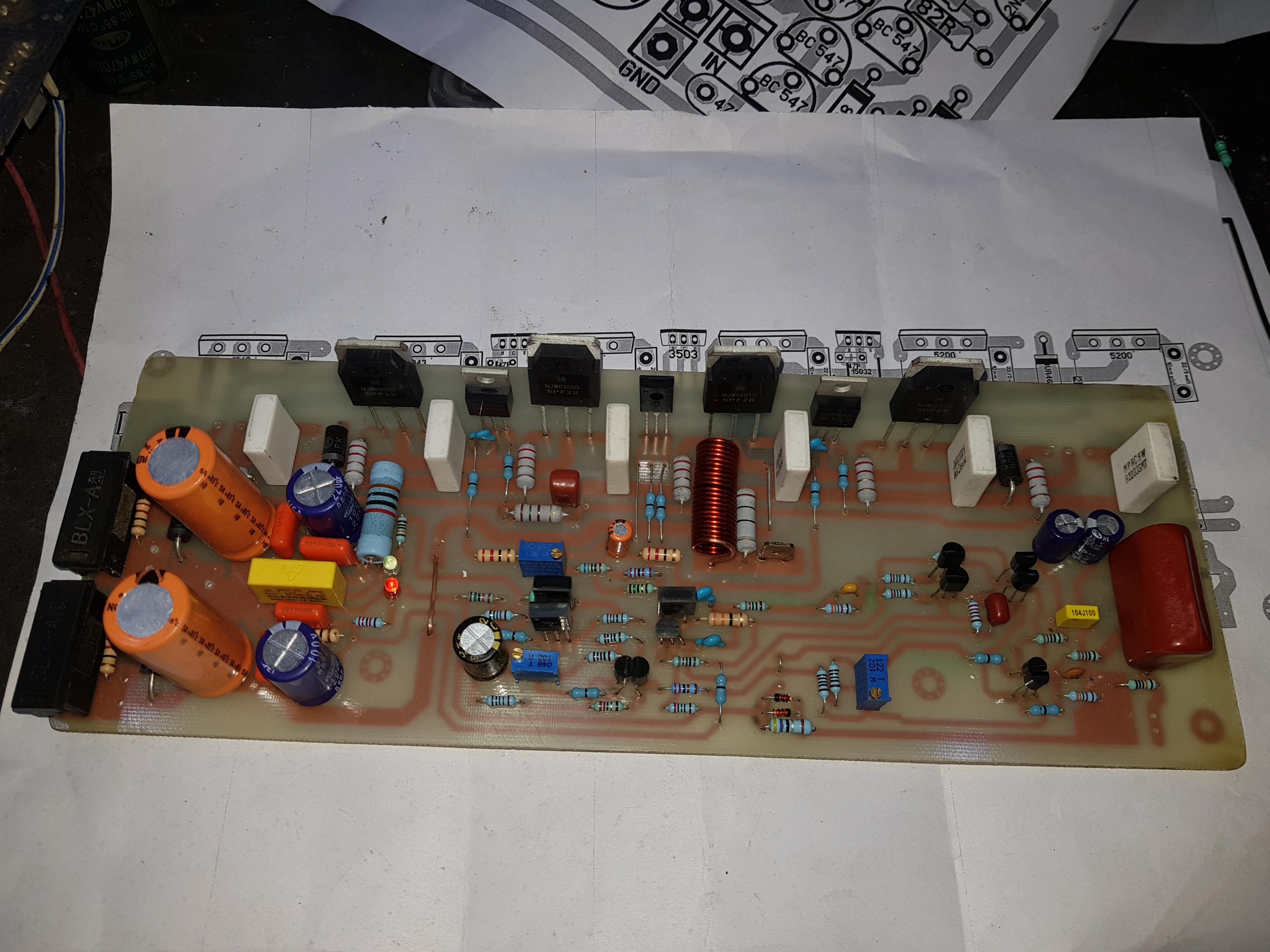

Hello
greetings tried to make the HONEY BADGER tried it on 35 DC volt rails red led comes on but the blue led does not come on only change was used two 470uf caps to make 220uf non polar can anyome help me out
warm regards
Andrew
Voltage readings , please !

I bought these boards v 2.4, mounted the whole thing but when I turn on R53 R54 jump, I tried and the LEDs light up properly only remove driver Q15, without this the tensions seem correct.
What can I check?
Is there a short circuit somewhere?
Thank you in advance.
